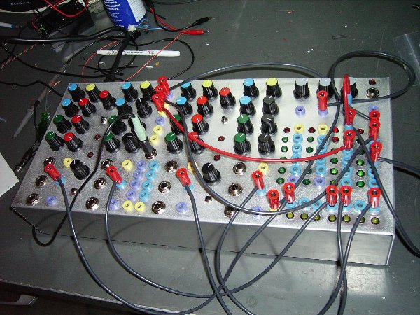

Quad Bass ++ (Plus Lunetta)
Thomas Henry Quad Bass ++ board with Lunetta type counters/dividers/logic.
Logic included is a 4094 8 stage shift register, three 40106 clocks, 4024 divider, 4015 4 stage shift register, two XOR gates, a Divide by2/3/4/5/6/7/8 4017 circuit (a section of the CGS pulse divider), and two 4 input R/2R ladders for generating CV's. Iy uses mains power, the drum voices have individual and summed outputs and manual triggers. Banana and 1/4 inch so it'll play well with my Lunetta or modular.
I just finished a couple hours ago - Have not decided if I'll dress it up any more or not. (ie wood sides) Maybe too many colors of jacks and knobs... That may change too.
As I learn how to use it I'll make a vid or audio clip.
bruce
EDIT to add clip & comment -
Obviously I was going for the Headley Grange vibe on the recording....

| That is some dense panel! Congrats, great build. |

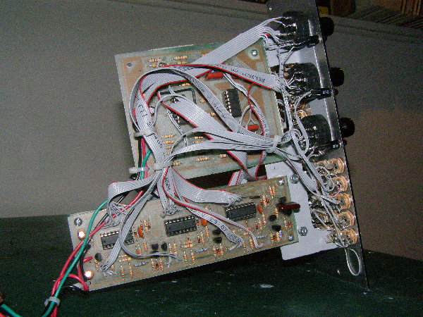

New Clock Divider, Boolean Logic, and Schmitt Trigger module |
I completed the final troubleshooting on the Yusynth Boolean Logic and so this module is now up and running.
This module represents some "firsts" for me. All three PCBs are homemade -- the first three I've ever made.
The Schmitt Trigger circuit board is my own design -- nothing overly complicated but a chance for me to acquaint myself with Eagle software. The other boards are Yusynth designs.
The Schmitt trigger's output produces a trigger when both inputs go "high" and does not produce additional triggers until both inputs go low. Thus, I can delay the start of a note until a clock trigger and, once the trigger is received, suppress additional triggers until the note is lifted (and the gate goes back to zero).
I'm really having a lot of fun building new "stuff"!

| View of the Schmitt Trigger PCB (my first attempt to design circuitry with Eagle and to turn it into a PCB) and the Yusynth Clock Divider card. |

| View of the Yusynth Boolean Logic PCB. I mounted the PCBs back to back (with spacers) to fit it all behind the panel. |

Wow, Kevin!
Nice work.

Good job Kevin. Been thinking of this module aswell for a while. Made pcbs at work but not for myself at home. Will take the plunge. Post some music you've created with it.  |
