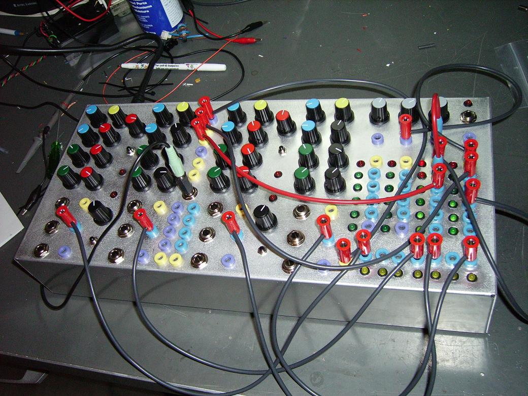

j.dilisio wrote:
The board looks so simple for the amount of patch points there are on the panel.
I've always wondered how you could use an analog computer in a modular setup. Would you use it mostly as a CV generator/processor?
It would be cool to have a VU meter in there too.
It is very simple, tho I really should make sure it works before saying that.
one good example of using an analogue computer with a synth is Dan Slater's Chaotic Sound Synthesis, you can see the 1st page here
It was common to have voltmeters on analogue computers, if I built this into a larger case it would have one.

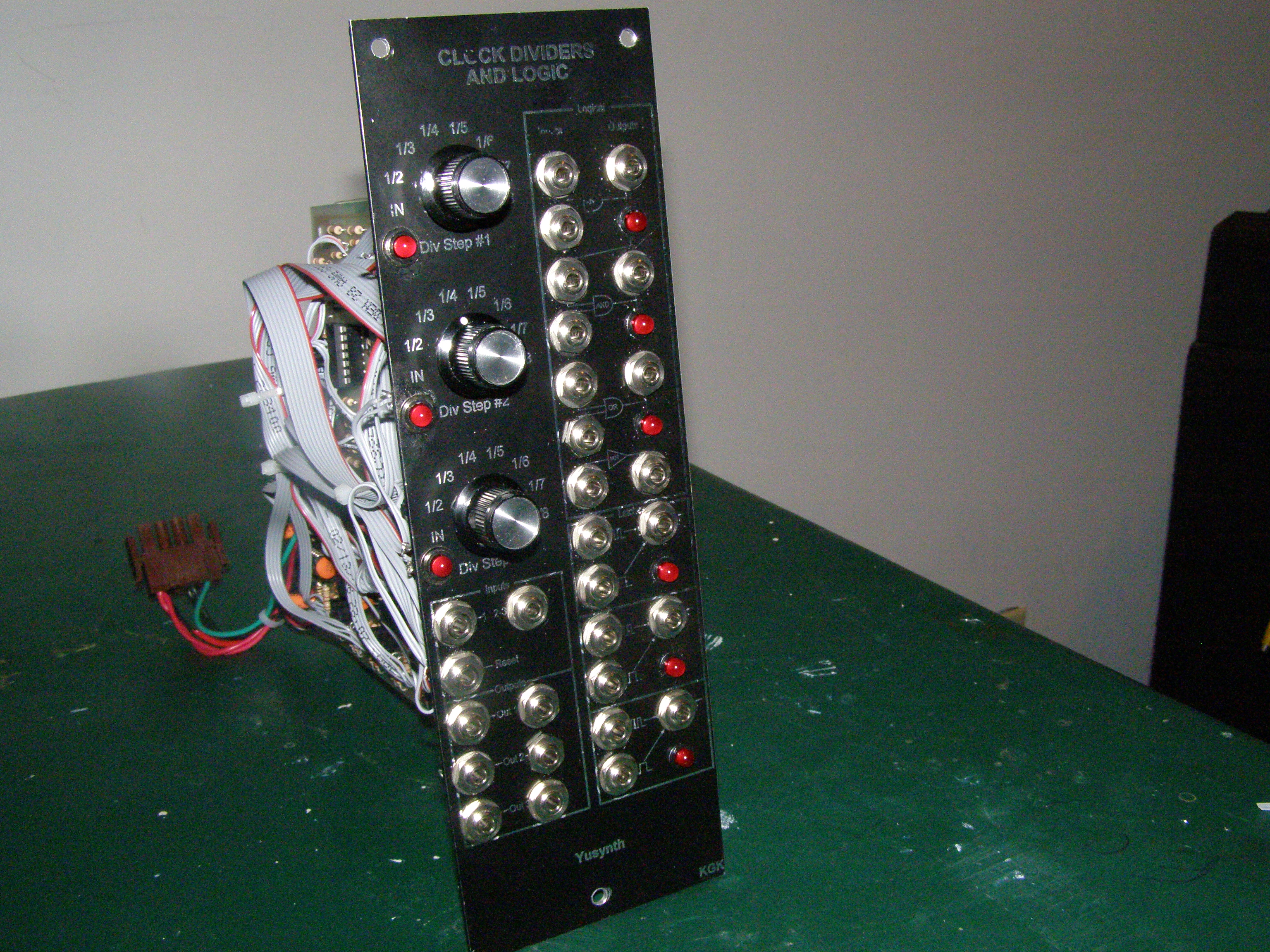

PostPosted: Tue Mar 16, 2010 5:54 pm    Post subject: New Clock Divider, Boolean Logic, and Schmitt Trigger module Reply with quote  Mark this post and the followings unread
I completed the final troubleshooting on the Yusynth Boolean Logic and so this module is now up and running.

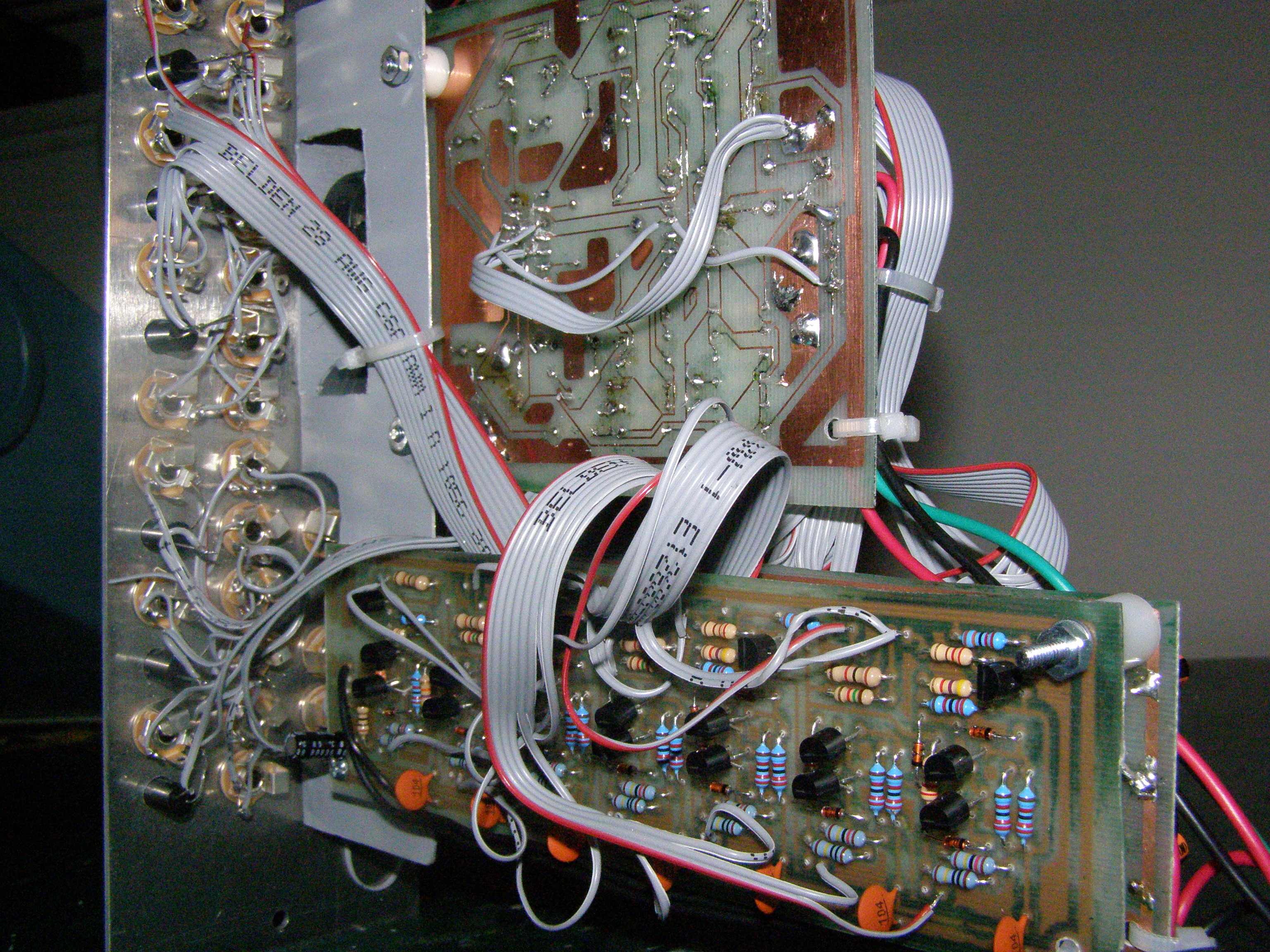

This module represents some "firsts" for me. All three PCBs are homemade -- the first three I've ever made.
The Schmitt Trigger circuit board is my own design -- nothing overly complicated but a chance for me to acquaint myself with Eagle software. The other boards are Yusynth designs.
The Schmitt trigger's output produces a trigger when both inputs go "high" and does not produce additional triggers until both inputs go low. Thus, I can delay the start of a note until a clock trigger and, once the trigger is received, suppress additional triggers until the note is lifted (and the gate goes back to zero).
I'm really having a lot of fun building new "stuff"!
I decided to combine three different modules to conserve panel space -- Aries used to group related functions together in common modules.
 Filesize:  4.59 MB
 Viewed:  311 Time(s)
View of the Schmitt Trigger PCB (my first attempt to design circuitry with Eagle and to turn it into a PCB) and the Yusynth Clock Divider card.
 Filesize:  4.86 MB
 Viewed:  301 Time(s)
View of the Yusynth Boolean Logic PCB. I mounted the PCBs back to back (with spacers) to fit it all behind the panel.
