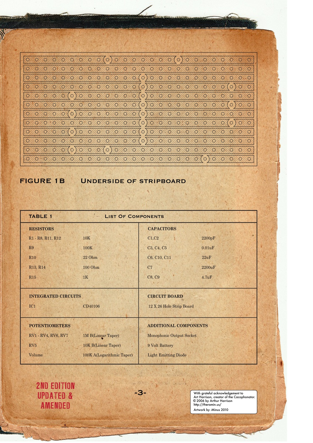

A few weeks ago I created a strip board version of the Art Harrison Cacophonator. I have posted the diagrams so others may build this amazing device and enter the exciting field of Cacophony Oscillation!
Many thanks to Art for his correspondence and consent to posting these images.
ENJOY! Smile

EDIT: These images below are the corrected ones. The incorrect ones have been removed.
 Filesize:  896.93 KB
 Viewed:  2718 Time(s)
amended 18 June 2010 (C4 placement corrected)
 Filesize:  877.9 KB
 Viewed:  4377 Time(s)
amended 18 June 2010 (stripboard cut added above IC)
 Filesize:  843.67 KB
 Viewed:  3642 Time(s)

Just thought I should post an update in case anyone builds this thing! I had wiring issues on my colour change LED I used and had to replace it. In the process I tried the Cacophonator without the LED and noticed a HUGE difference in the time it takes for the large capacitor to discharge once the machine is turned off!
My recommendation is to omit the LED completely. The LED severely shortens the capacitor discharge time and much of the interesting noise the Cacophonator is capable of...
PostPosted: Sun May 23, 2010 6:05 am    Post subject: Reply with quote  Mark this post and the followings unread
You could also try just upping the current limiting resistor on the LED, (R15) and/or upping the value on the main decoupling cap. (the one across the power input)(C7) Wink

PostPosted: Mon May 24, 2010 5:21 am    Post subject: Reply with quote  Mark this post and the followings unread
Nice compact layout!
I may be wrong, but shouldn't C4 connect to pin 9 (Input of osc4) rather than pin 10? And I think there' s a strip break missing in the 3rd row down - as it is, R14/C11 are linked to the +ve end of C6.

PostPosted: Mon May 24, 2010 8:17 am    Post subject: Reply with quote  Mark this post and the followings unread
I was going to ask if the layout is verified. Because I built one, and it does not make any sound.
anyone here had a successful build with this layout?

PostPosted: Wed May 26, 2010 2:05 pm    Post subject: Reply with quote  Mark this post and the followings unread
got home tonight, triple checked the cuts, parts and layout. fired her up again. led went on aaand SMOKE!
Edit: see below
blue_lu
Joined: Nov 16, 2009
Posts: 32
PostPosted: Thu May 27, 2010 2:12 am    Post subject: Reply with quote  Mark this post and the followings unread
it is not cap, but it was a resistor that smoked.
R10 is starting to smoke, just seconds after I apply current to the circuit. Shocked
what to do?!
just change the resistor and try again?

PostPosted: Tue Jun 15, 2010 5:19 am    Post subject: Reply with quote  Mark this post and the followings unread
Sorry its not working for you blue_lu!
I built it and can verify that it does work. I'm away from home for a couple more days but will open up my box when I get home and double check the drawings with the build. If I find any mistakes in the drawings I shall correct them and let you know!
In the meantime if you have had any luck in finding a fault, let us know.
Love the introduction.
Peter
Just looking at the drawing now...
Yes, judging by Art's schematic, it does indeed look like I have made a mistake! Shocked C4 should go to pin 9!!!! Can't believe I missed this! Oh well, I shall fix this as soon as I get home on thursday.
And... the other things.... let me see.... yes. I think this may be wrong too! I shall have an URGENT and FINE TOOTHED COMB look over this as soon as I get home on thursday!!!!!!
Thanks for pointing this out Peter! I have not been near the net for a while and missed the comments recently. I shall fix this up very soon.

Anyway, this is a message to blu-lu , (and indeed anyone else who has experienced circuit board fires due to my clumbsy mistake X2), incase the message was not received:
Hi Blu-lu,
Firstly, I'm very sorry but there appears to be two mistakes in the Cacophonator drawings I posted!
As prgdeltablues correctly pointed out on the 24th May:
This looks to be right to me. If you make a further cut in the stripboard on the third row down, just above the seven cuts under the IC, this should sort this problem out.
And if you move the position of C4 so the capacitor connects to PIN 9 of the IC (next pin down from shown at present), I think your Cacophonator should work.
Once again, I'm very sorry to have misled you! And apologize for the circuit board fires caused. When I return home in about 24 hours, I shall double check this and correct the drawings.
Steve

PostPosted: Thu Jun 17, 2010 2:14 am    Post subject: Reply with quote  Mark this post and the followings unread
Just stepped in the door.... opened up the Cacophonator and the above comment about the cap and the extra cut above the IC is indeed correct.
Hope your finger gets better soon so you can get your Cacophonator working! I believe the sonic frequencies are capable of demolishing small stone structures, increasing crop yields and animal fertility, raising the dead, and perhaps mending broken bones.... but don't hold me to it. There may be another mistake in the drawing and none of the above may be possible.
I'll fix the drawings in the next few hours and resubmit them....
