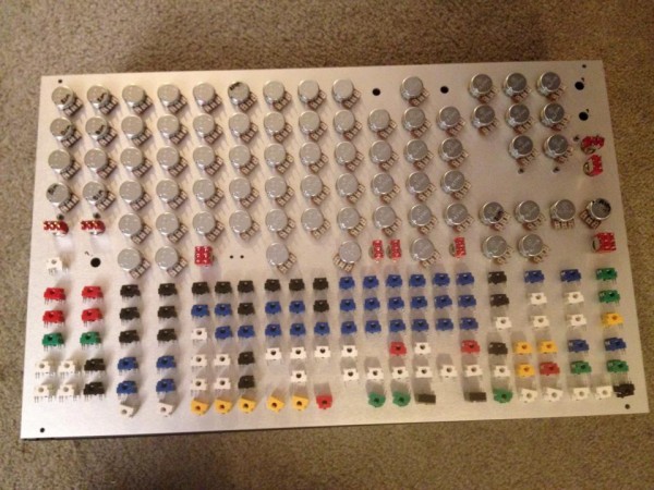

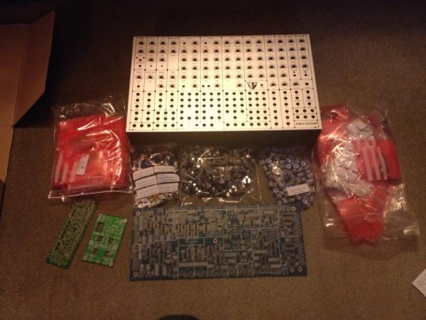

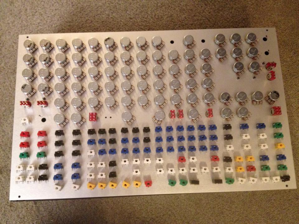

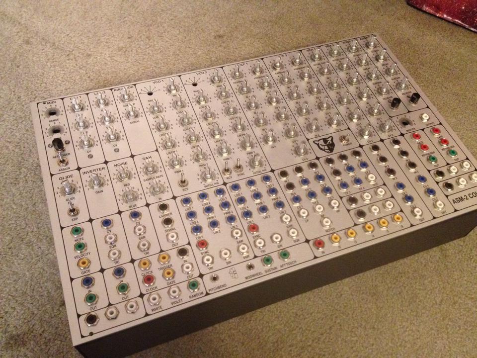

PostPosted: Sun Oct 05, 2014 6:43 am    Post subject: ASM2 Cougar
Subject description: new build and looking for a few answers....
Hey all, Have joined this forum after following link from elbys site.
I have just received my asm2 cougar full kit and there are a few things that dont make too much sense. Maybe theres still a few typos (even on the front panel, not sure, thats why Im here).
So my first question is......
Has anybody built an ASM 2 Cougar?
Im also curious to what documentation other people received with their kits. Some talk of CDs and large printed overlays of pcbs etc.
Although Ive managed to find a lot of the things I need on the elby website I still seem to be missing a few bits of info.
The kit came with
asm2 pcb v2. Found schematics and bom. Think I should be ok with this...
cgs36m pulse divider pcb. Found overlay online and schematics, I think i should also be ok with this although I think quite a few of the features arent being used with the cougar panel. (Maybe thats what i can use some of the unlabled connections for).
some kind of psu pcb. Advertised as monodual but i dont think its one of those. On the board it says DC/DC Power unit v0.3 but i cant find a schematic or bom to fit this.
MonoDAC (this hasnt arrived yet, I guess theyre getting more made up) I have a printout of the overlay but i cant find schematics or anything about this. Anyone?
There also seems to be a few unlabled sockets on the cougar panel. Is that just so i can decide on minor mods?
The vco inputs seem to be a little wierd. There are 3 lin cv in puts on the panel but only 2 on the pcb. Do think its intended that i stick another 100k resistor on the bus connecting all the inputs to the inverting input of the opamp and hack it together?
Same with the initial pwm (the genie block diagram has been useful here) sent to the 100k pwm 1, and use the same trick as above into pwm 2 input but using 300k resistors for the pwm 1 and pwm 2 knobs.
Anyway, I think this is plenty for now. I still have lots of questions, some rather basic Im afraid.
btw, Do you think its worth starting a new topic just for asm 2 cougar builds? Maybe not enough get sold huh? Ive found very limited info on these synths online
Many thanks in advance.

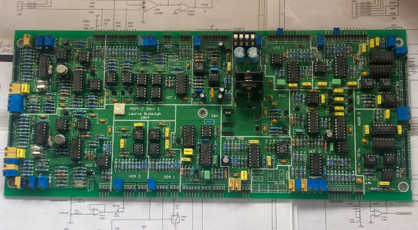

PostPosted: Sat Sep 10, 2022 2:51 pm    Post subject: ASM-2 Questions Reply with quote  Mark this post and the followings unread
The ASM-2 Rev 1 PCB I have is dated 2004, this thread was started in 2006 and last updated in 2014, so I'm throwing a long shot here - but get this - a mostly-completed ASM-2 has come into my possession - a gift from Rob Woodward. I'd love to get it working.
I am trying to find documentation that explains what type and size potentiometers to use for the various controls. If anyone can help me out here, that would be most excellent. I messaged synthnl on his related posts and emailed an address for elby-designs asking same.
I noticed also the glide section is unfinished, so I looked up the BOM and see 1/2W resistors. Do you think 1/4 will be fine as I have a ton of those available, or should I specifically order 1/2W?
I suppose it goes without saying that I am really thankful for this site and knowledge here. Very Happy
