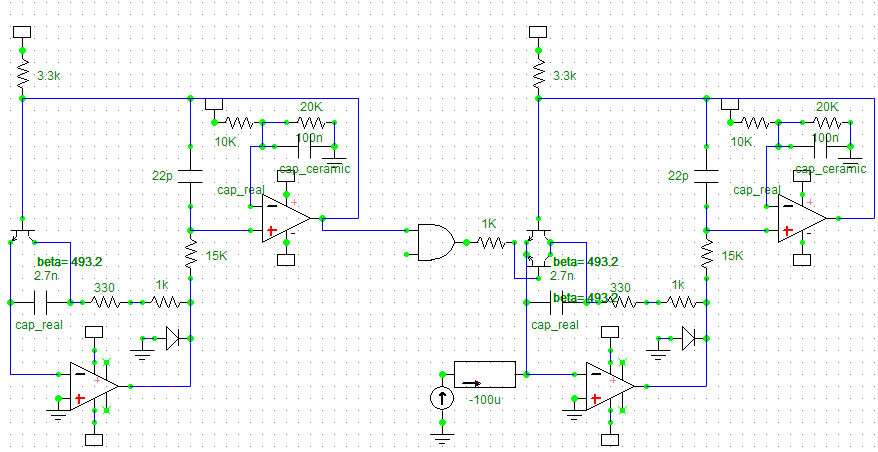

PostPosted: Sun Feb 27, 2011 2:32 pm    Post subject: Re: Hard Sync?
Subject description: Modifications
Somnium7 wrote:
Has anybody attempted adding hard sync to these VCOs?
Hi Somnium & living VCO enthousiasts,
Currently I'm learning my way around Spice (a program for simulating electronic circuits) and implemented bits and pieces of the living VCO. I've also been playing around with a hard sync functionality.
I've tried a few different approaches to hard sync:
1) The classic way, implemented in many VCOs (e.g. Ken Stone's CGS VCO) is to retrigger the slave VCO at the comparator's reference input. In the Living VCO this will not work, because the capacitor (C4) is stabilizing the reference voltage too much for the sync-signal to get through and affect the comparator's output.
2) Another method (hinted at by JH previously in this thread) is to use a second transistor, similar to Q3, to discharge C3. JH was suggesting to feed the saw output of one VCO to a pulse shaping circuit and have the output trigger the second discharge transistor. This approach has a few problems. First of all, a falling ramp sawtooth is needed instead of the rising ramp sawtooth put out by the living VCO. This can easily be solved with an inverting op-amp of course. The second problem is the width of the pulse that is meant to trigger the second discharge transistor. Compared to the pulse generated by the LM311 in normal VCO operation, the pulse used for hard sync is much wider. Because of this, a reset of a VCO will take much longer through the "sync" route, then through it's own comparator route.
Both problems I ran into result in a substantial phase delay between hard-synced VCOs.
3) Finally, all of the struggling described above finally led to a nice short-cut of method 2. I'm still using a secondary discharge transistor in the slave VCO, but I feed it a signal directly taken from the comparator output of the master VCO. Because of impedance issues, this output needs to be buffered first, which can be done by an cmos AND gate (4081) . This gate serves both as a buffer and as an "sync on/off" switch (even voltage controlled!). This third method only does hard sync, but assures a very tight/narrow reset spike, similar to what the VCO uses in it's normal operation and a very low phase-delay.
I've attached a schematic of the last idea for VCO hard sync. The picture shows two living VCO cores (without expo convertors and PWM circuit) and the sync connection between the two. The second input of the AND gate can be used to turn hard sync on and off by presenting a high (15) or low (0) voltage to it. Please keep in mind that all of my findings above are based on Spice simulations. The real world might behave differently and I still have to test the ideas in real world.
Rutger
ps. Loving VCO Smile.
edit: Sorry, the schematic is badly annotated. Both "amp" symbols in the upper part of each VCO core represent the LM311 from which the sync signal is taken.

PostPosted: Mon Feb 28, 2011 2:24 am    Post subject: Re: Hard Sync?
Thanks for an interesting post.
Why is this pulse wider?
rutgerv
Joined: Nov 22, 2010
Posts: 26
Location: Elst, Netherlands
G2 patch files: 3
PostPosted: Mon Feb 28, 2011 6:26 am    Post subject: Reply with quote  Mark this post and the followings unread
I believe this is due to the time needed for the capacitor in the pulse-shaping circuit to charge and discharge. The spike could be made more narrow with different capacitor values, but as a consequence the pulse height will decrease. At some point it may not trigger the transistor anymore. This could probably be fixed with an op-amp in the sync circuit, but I didn't want to take the route of adding that many components.
