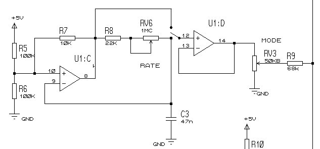

PostPosted: Thu Sep 22, 2011 5:24 am    Post subject: Reply with quote  Mark this post and the followings unread
An image might be clearer than my confuse explanations.

PostPosted: Thu Sep 22, 2011 10:03 am    Post subject: Reply with quote  Mark this post and the followings unread
(and I need to exercise with that *#&ø Gimp !)
Thanks for the drawing -- I was starting to picture it but hadn't gotten around to looking seriously yet. That IS super easy. You might have just convinced me.

jumunius wrote:
That IS super easy.
You name it.
Now, before I make the definitive build, I'm open to all suggestions for additional mods. Like changing the LFO shape / PW without incidence on the rate and amount of the LFO. My attempts finally did work. I tried an adjustable voltage divider in place of the R5/R6 network (schemo above), didn't make it, then tried to buffer it, same result. Perhaps it's simply impossible with this type of LFO after all…
More ideas to suggest, people ?

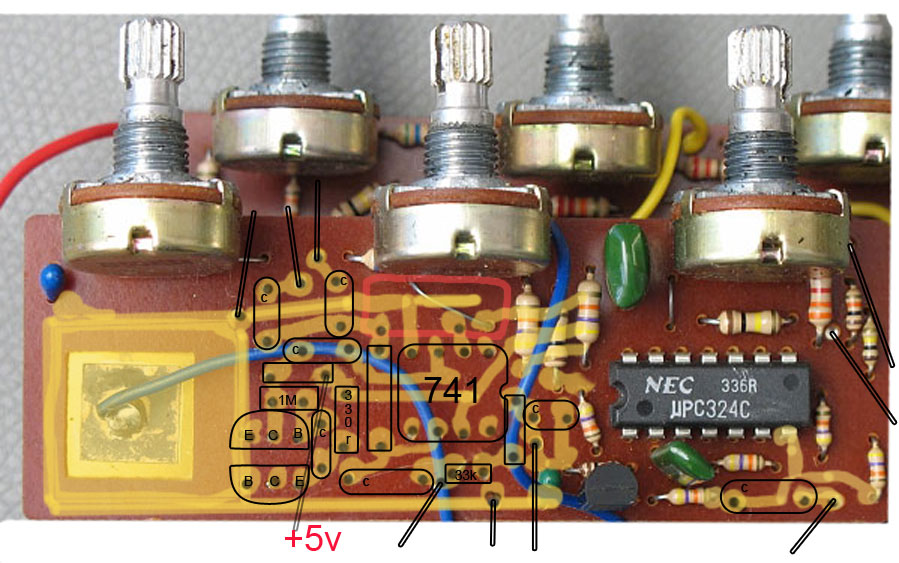

PostPosted: Sun Sep 25, 2011 2:08 am    Post subject: Reply with quote  Mark this post and the followings unread
hi all, great thread here .. lots of info. I have just came into possession of an original ds-7 (actually a JHS D-2!) I had to replace pots and rewire to get it to work, it now sounds great! looking at the pcbs inside i noticed an empty area of the circuit, I imagine they used the same pcbs for both ds7 and ds8... so my question is: can anyone help with a conversion? Laughing
I have added a jpg that shows what I'm talking about.
p.s. could not find a image of the ds8 board using Google....
cheers.

PostPosted: Mon Sep 26, 2011 3:19 pm    Post subject: Reply with quote  Mark this post and the followings unread
Hey. No happy DS-8 owners passing by… Ready for some reverse engineering ? The 741 is obviously in the middle, and I guess the transistors are top left (solder side). Good luck !

PostPosted: Tue Sep 27, 2011 3:43 am    Post subject: Reply with quote  Mark this post and the followings unread
yeah just a photo of that top board in a ds8 would help a lot Very Happy
like you i guessed the 741 position, dunno about anything else. I only have the schematic from the french site and that might be different?

PostPosted: Tue Oct 18, 2011 2:56 am    Post subject: Reply with quote  Mark this post and the followings unread
ok, I was given a couple of gutshots of a ds-8 from Marc Bareille (cheers Smile )
and could work out a lot of the component placement for the add on noise circuit, there is a section in red I could not get a glimpse at! it would be great to work it all out. the 3 sets of wires are for the two pots and the circuit on off switch... someone could add on to the ds-7 stripboard??

PostPosted: Tue Oct 18, 2011 3:36 am    Post subject: Reply with quote  Mark this post and the followings unread
Well done ! So it was as simple as this… It's nice from Marc, though. What I don't get is that with those DS-8 board pics, you should be able to place every component…
You have two holes unfilled, I'd say they're for a jumper, to allow pins 2 & 6 to connect through the 470k resistor (the vertical unmarked rectangle left of the 741). Note that according to Marc's schem, there should also be a 22p cap across that resistor, to tame the trebles (I don't know much but I think it's usual with 741s). Maybe the engineers at Coron didn't give a f*** about taming any treble whatsoever, just a gang of punks, you see ?
Anyway you simply stick the 22p cap on the solder side and you're done !

PostPosted: Sun Oct 23, 2011 7:18 am    Post subject: Reply with quote  Mark this post and the followings unread
I think you could be right , if you squint looking at the image it looks like a jumper there, I suppose my next step is to build it and see what happens! Smile

PostPosted: Sun Oct 23, 2011 7:40 am    Post subject: Reply with quote  Mark this post and the followings unread
Yep, looks like a jumper here, and the schemo would agree to this.
