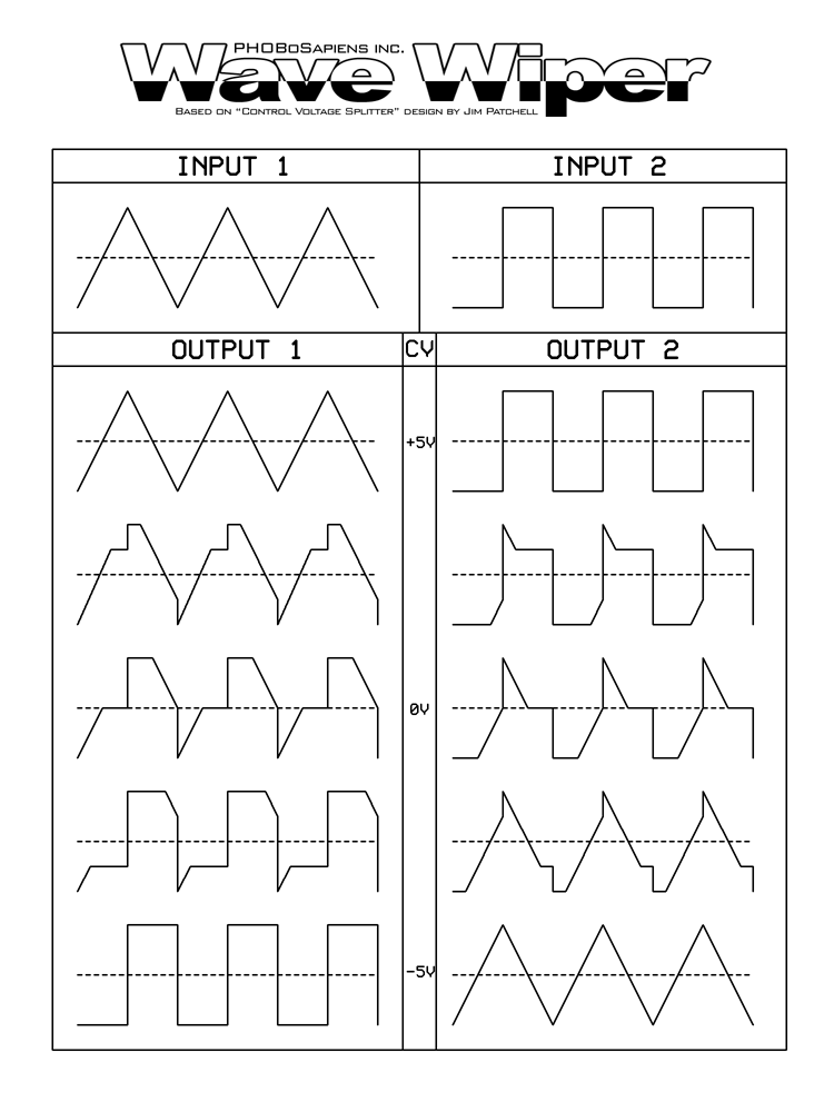

PostPosted: Wed Jan 11, 2012 4:34 pm    Post subject: Wave Wiper
Subject description: based on Jim Patchell's Control Voltage Splitter
I just gave it a try to see what it really does and then used it to design a
circuit that merges the top and bottom halves of 2 waveforms together.
With the CV/pot you can 'wipe' between the 2 input signals. Because the
ouputs behave inverted (top1+bottom2 VS top2+bottom1) it makes a
very nice (auto)cross-panner.
I'm not sure if this is one of the things hinted in the posts above, but I
think it's a very useful circuit. Smile
Exclamation edit: flipped the diodes around compared to the previous schematic, more info later.

Posts: 5908
PostPosted: Thu Jan 12, 2012 10:21 am    Post subject: Wave Wiper example graph Reply with quote  Mark this post and the followings unread
asterisk wrote:
it has 2 outputs, are you saying output 1 is regular and output 2 is inverted version of output 1?
not exactly.
Inverted in the way that one output wipes from IN 1 to IN 2,
while the other output wipes from IN 2 to IN 1.
I made an example with 2 waveforms (triangle/square, 10Vpp) with the same
frequency at 5 different CV settings. This should make it a bit more clear
what it does. The also shows the reason for flipping the diodes around in
the updated schematic, because to me it makes more sense to have IN 1
on OUT 1, and IN 2 on OUT 2 with a positive CV, and the other way around
with a negative CV.
once I've put it on perf I'll do some more tests with different kinds of input
signals and maybe I will be able to provide some scope shots. Cool
 Filesize:  39.57 KB
 Viewed:  555 Time(s)

PostPosted: Thu Jan 12, 2012 4:04 pm    Post subject: Reply with quote  Mark this post and the followings unread
with a negative CV.
yes that does make more sense to me as well
also what you have drawn is what i imagined the outputs would look like,
if it bears out in real life the same this will be a very usefull circuit indeed Cool it could make a very good VC waveshaper

PostPosted: Fri Jan 13, 2012 1:50 pm    Post subject: tuning the Wiper Reply with quote  Mark this post and the followings unread
For those brave enough to try it, here's how to test and set the 47K trimpot:
Don't connect any signals to the inputs (incl. CV), better yet connect them to GND.
Turn the trimpot to it's minimum resistance, and the 100K "WIPE" pot to -12V.
You should measure a voltage of roughly +2V on OUT 1 and OUT 2. Now turn
the "WIPE" pot to +12V and measure the outputs, they should now be roughly -2V.
(if you measured a voltage way above and below 2V you could have the
trimpot turned the wrong way. else you need to check the circuit.)
Next, with the "WIPE" pot still at +12V turn the trimpot so that both outputs
are 0V. Now turn the "WIPE" pot back to -12V, the outputs should stay at 0V.
adjust the 47K trimpot if necessary. that's it Smile (at least for now)
note: the circuit should work fine on +/-15V but you might want to
increase the 220K resistor attached to the "WIPE" pot.

working correct:
CV source connected to IN1 (pot between +/- 5V is useful for testing)
"WIPE" pot at +12V
OUT1 should follow IN1, OUT2 should be 0V
"WIPE" pot at -12V:
OUT1 should be 0V, OUT2 should follow IN1
CV source connected to IN2
"WIPE" pot at +12V:
OUT1 should be 0V, OUT2 should follow IN2
"WIPE" pot at -12V:
OUT1 should follow IN2, OUT2 should be 0V
for a final test you can connect a DC voltage to IN1 and a different voltage
to IN2. With the "WIPE" pot you should be able to control the outputs
between these voltages (where OUT2 does the opposite of OUT1).
