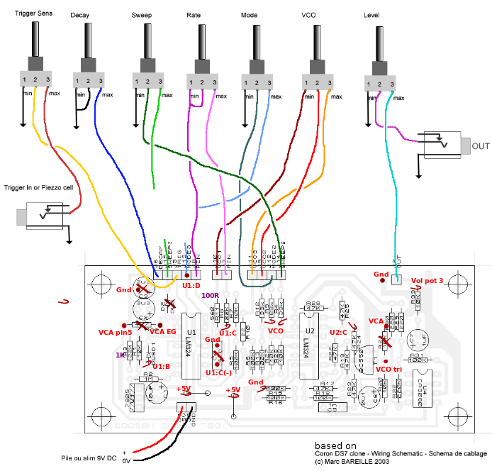

joshco wrote:
Completed also, one of Marc´s Ds8. The Circuit works but only Trigger, Noise, LFO and VCA. The VCO makes no sound. I have checked wiring, Capacitors, changed IC´s, checked Power Conections and Ground.
I have a small Scope and a Multimeter.
Any Ideas where i should be able to measure the VCO Triangle or Wave? or what to looking for?
well actually im in the same situation, i was checking this thread to see if somebody found an answer for joshco, actually looks like NO or at least not on this thread, i dont see it.
So, i have the same problem as joshco:
trigger, decay, noise and pan are working as expected
i can perceive the sweep, and lfo when im almost completely panned to vco, but then, on vco is basicly mute
any tips??
i have the ds8 rev 1.0 - 06 october 2004(marc bareille pcb)
and i have to say the bom & schematics are a bit confused
for example, the bom says c5 100n poly but on schematics c5 is electrolytic.
before simply was not connected, because another bom also called rev 1.0 with the same date 06 oct 2004, was saying: c5 22pF ceramic (optional)
so i believed the problem was coming from there but is not
in the while i started to hate this pcb( i also had to drill some missing holes)
i never saw such a bad quality and confused documentaion to support it,
and for that price im a bit surprised that some people bought it.
probably i still a beginner, but i ve been able to build 258 in a couple of days without problems and is working perfectly, same for the sn voice.
should i simply give up with the easy stuff?

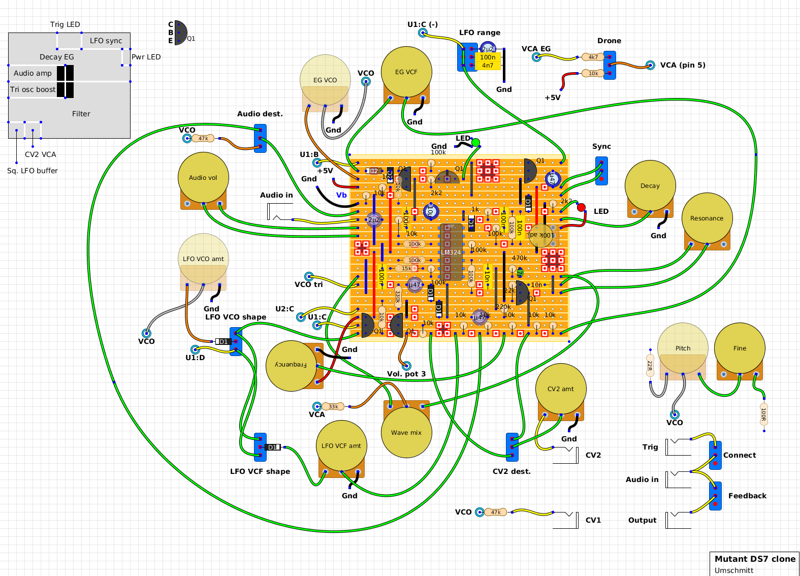

Hop hop hop ! Don't be so distressed, people ! I agree that the DS-x are far from the most versatile sound making boxes in the universe (I think I dared a similar remark on these very pages some time ago). At least, as you said tokyomatik, it does this "piuung" sound and it does it well (also serves as deeeep bass drum). Not much more. But it's not a proper module, right ?
Yet you can mod / expand them and it turns them into something totally different. Few months (years ?) ago I posted as work in progress some ideas in this direction. Now it's done and ready with everything working as expected (to my standards). It has no less than 16 knobs and 9 switches, 4 ins and (only) one out. I'll post the schematics very soon, I just need to double triple check it before. Same for the stripboard I designed, I'll post it when I have it actually working. In the meanwhile, enjoy those Mutant DS7 sounds !
ericcoleridge, did you try to feed the ouput of one of the "modules" into the CV input of the other ? (maybe amplify or reduce the CV resistor) This could give interesting results in terms of bass drum sounds…
tokyomatik, just tell me in which mülltonne you threw yours, I may have a chance to get it… Seriously, there seems to be several versions of the schematics etc. Some things might have been lost/changed with the different revisions. For instance on the schematics currently available, C5 is the tiny cap across the 741… You could think of dropping an email to Marc B. in order be sure to have the relevant info, or simply to ask him about your problem… There's no reason why it shouldn't work after all.

well, about my ds8, i can tell you that the part involving the noise section works,
pan, color switch, decay and a bit of the lfo and sweep, when is panned almost completely to vco i cannot say the same about the last one
is basicly mute
last nite i was checking the various documentation i have
they are all rev 1.0 and all of them are dated 06 october 2004, so u can imagine my mental confusion
anyway i have the version 1.0, there was not yet the optional cv, r31 nc and c5 should be 100nF but is not clear if its electrolytic or poly, schematics and bom are also confusing me
at the beginning i build mine without c5 because on the first bom i had, was signed as c5 -22pF (optional), then when i realized that the board was not working i found another bom and so i added c5 - 100nf poly but nothing changed, then i checked the schematic and i saw c5 as electrolytic so i tried with a 1uF( i didnt had a 0.1uF around) but still the same, at the end i dont think the problem is coming from that cap.
the wiring also was not so clear....
lfo in the wiring instructions is reversed respect to the drawing
anyway i fixed more or less everything but vco still mute
swapped various lm324, ca3080, 741....
checked all the orientation of polarized caps, ics, transistors and diodes
sometimes im so exausted that i would desolder everything and start from zero but the quality of this board is not that good so desoldering could lift the traces, if i think that for less money i just bought a TH MPS board shipping included, i would never buy again a ds8 or spending 1 second to build it.
i started it together with the dual 258j and for that, 2 days of soldering but thats it, BAM! lets make music!!

Oh oh ! So you can hear a bit of sweep and LFO through the output ? That means something's oscillating in there ! How does it sound like ? Is it loud ? In the hi/lo end ? Saturated ? Is the pitch dependent from the VCO pot ?
Besides, has your reference schematics the same VCO section as the one on the site ? (VCO is around U3:B, U3:C, U3:D and Q3 if you searched)
Again, there's no reason why it shouldn't be able to work…

well almost completely cw is the same volume of the noise and the wave is not anymore noise on my scope but kind of mix triangle/sine with a soft square rectification at the bottom
looks interesting but is only in the hi end, kind of sonar sound, the pitch pot doesnt infuence it so much...just a little bit, almost imperceptible also on the scope when is completely panned to vco is mute
i also have one pdf with this schematic, but is not the correct one for my board
i have the right one anyway...
my board is without optional cv and c5 is 100n, the schematic say polarized, the bom say poly, but as i already said i dont think is for that cap that the vco is mute....i hope
i think uc3 c is the output of the vco but on the scope i dont see anything....

For now the best would be that you post the relevant schematics so we can name components with their actual names and see changes done to the circuit. I may have some time later today if it can help.

so here as attachment the real schematics & documentation of my board

Man ! I don't know if you're supposed to post the whole doc with layout and all ! Any admin around who could tell the does and donts ? Anyway I saved the document on my computer…
So basically it's the same VCO. I check if the layout follows the schematics (just to be sure, I have no doubt it's OK). Stäy tüned.
One thing that came to my mind : if you have time, could you check continuity overall the VCO, taking measures at the very legs of the components ? Who knows, you may have a crack on one PCB track and not see it… (perhaps you already did that too !)

I doubt C5 is your problem but in the BOM I have, it's ceramic 22pf. Even if it's 100nf it's probably better at the least that it be non-polar, and could actually be bad if it is polar. So don't use an electrolytic there.
Did you check for solder bridges? There are some really tricky traces on that board -- one in particular I remember runs through the legs of an IC. You might double check your soldering work, as you say, the board quality isn't as fancy as the MPS.
Personally, I think it's worth completing, although I sympathize with the frustration of having something not work no matter what you do. But if you ever want more than one drum voice playing simultaneously, you would have your MPS and your DS-8 to use. Plus I kind of like the sound of the noise filter on the DS-8 as compared to the one on the MPS, especially now that I used a 12 position rotary switch to cycle through many filter values.
Also, FWIW, Marc is pretty responsive. If you need build advice you might just shoot him an email.

Unexpectedly, I happened to have a social life yesterday evening… So, back to it. On the doc tokyomatik *didn't post*, C5 refers to the smoothing (I guess) cap to ground at the output of the VCO, which is 100nF. Different revs, different names…And I second jumunius about checking for solder bridges. Yes, that's boring, it's called debugging…

Dankeschön ! I still need to post the schems, layout and stuff so everyone can try it !

By the way, as one could imagine, I couldn't find any error between the schemo and the layout (call it overkill preliminary precaution). Now it's up to you tokyomatik !

Here we go ! So these are elements to build a stripboard extension to the DS7, in case one would be interested. It's quite a mess, but you've been warned ! Nevertheless, it has been build and tested, so it's guaranteed functional. *.diy file available on request.
This is COMPONENTS side, beware !
 Filesize:  9.29 KB
 Viewed:  36968 Time(s)
A very promising layout, noodly speaking. Yes, the audio in jack is drawn twice.
 Filesize:  324.01 KB
 Viewed:  4043 Time(s)

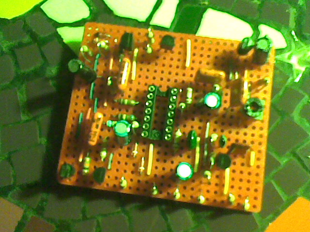

OK people, here are a couple of pictures about the construction of an augmented DS-7 clone.
(in exclusive Cheap-O-Vision quality)
Here we have the circuit board of the extension. If you wonder about the colour, it's just ma having a red marker in the hand…
 Filesize:  97.04 KB
