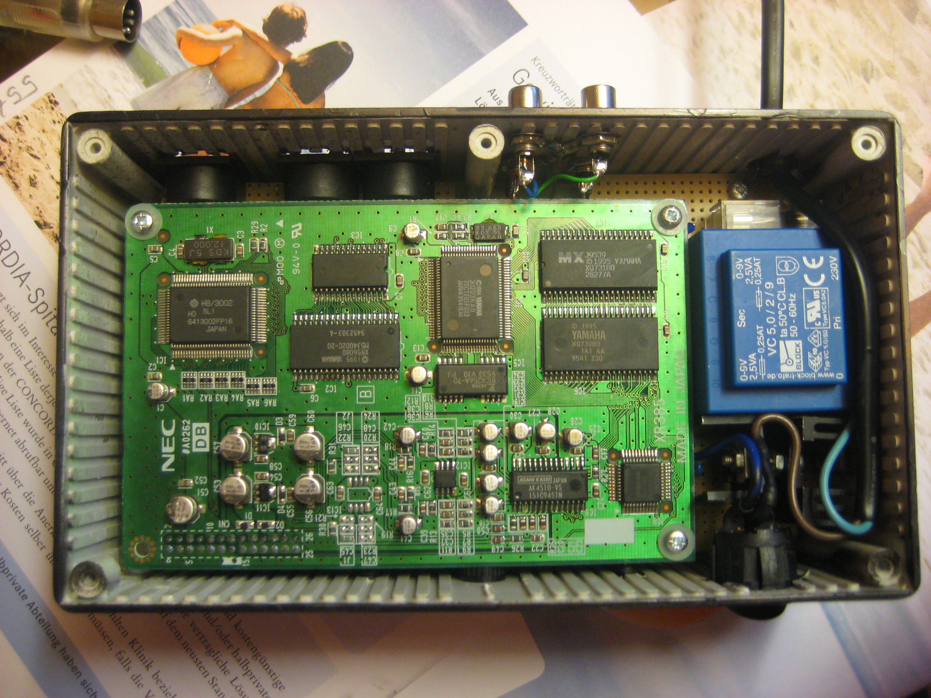

PostPosted: Sat May 12, 2012 3:14 pm    Post subject: My DB60 Box Reply with quote  Mark this post and the followings unread
After posting a pdf with a perfboard layout (see bottom on page 9), I owe you some pics of the finished product.
"Reduced to the max" Smile
NOTE: I anyone could tell me what needs to be done in order to get an spdif output (optical or coax), I'd be very grateful!

PostPosted: Sat May 12, 2012 7:26 pm    Post subject: Reply with quote  Mark this post and the followings unread
How did you get the grille so nice and even? That looks awesome. Makes me feel really bad about the cruddy 6 3/8" drill holes I used to ventilate a power supply I made Smile
I'm assuming you were using a dremel? But even so I don't think I could ever be so even handed...
Edit: oh wait, those grilles aren't drilled into the actual project box, are they? Wink

PostPosted: Wed May 16, 2012 11:26 pm    Post subject: Reply with quote  Mark this post and the followings unread
Ah no, these are no drill holes. Had the same idea at first but then decided that I was never able to get a nice grille this way. I took a piece of a plastic to protect the drip rail from leaves (http://img.westfalia.de/media/show_image.php?datei_id=687) , sprayed it black and glued it in from the inside. You can still do it that way, just cut out the area with a knife and rasp the edge clean.

PostPosted: Thu May 17, 2012 4:25 am    Post subject: Reply with quote  Mark this post and the followings unread
I see you used one of those small transformers. Can you give some information of how you did that and if it gives enough power for the whole thing?

PostPosted: Fri May 18, 2012 7:54 am    Post subject: Reply with quote  Mark this post and the followings unread
Actually, looking at your mains PSU in a bit more detail, have you got any insulation between the Veroboard and the perforated sheet?
It looks like you have connected live mains via a switch and fuse to the input of the PCB mounted transformer on the Veroboard. This means there are some Veroboard tracks at mains potential very close to the open mesh. If you are unlucky enough to put the module down on something metallic with something that can just stick up through the grill (such as studs on the back of a panel, or a spiky heatsink), you have a reasonable chance of making this metal live to the mains. Shocked
Always treat mains power with the respect that you would treat anything that could kill you. You would want some protection between a Lion and you in a Zoo, do the same between mains electricity and Murphy's Law.
If you have a clear insulator in there, fine - but it's better to be safer than sorry, hence my query.

PostPosted: Sat May 19, 2012 9:11 am    Post subject: Reply with quote  Mark this post and the followings unread
Yes, I used a transformer with two secondary windings. They each output 9V with 2.5VA. As this wouldn't be enough, I connected the two windings and use them in series - to get approx. 18V.
As you can see in img_6792.jpg, the transformer has outputs on pins 6+7 and 9+10. On page 9 of this thread in Waveblaster-Midi-Layout.pdf you can see, that I short connected pin 7 and 9. This way I get 18V on pin 6 and 10 and GND on pin 7+9 (grey circuit paths). The output of pin 6 and 10 are routed to a bridge rectifier.
As the draw on +5V is the highest and as I get +5V from the +12V, the 7812 and 7805 get a little hot without heat sink. So I added one to each - although it got a bit cramped in that area. All other parts, even the transformator, remain quite cool.
Oops, you're absolutely right! I only insulated the top parts but not the underside of the board. Luckily the output of the fuse and the input of the transformer are a bit away from the opening - but the input of the fuse is visible. I will insulate everything though. Thanks a lot for the hint!
At first I had no grille there and the liberaly cut out parts in the circuit path would have been enough to prevent unwanted high voltage on other paths. But when I cut out the 2nd hole on the underside, I didn't think about it anymore.
