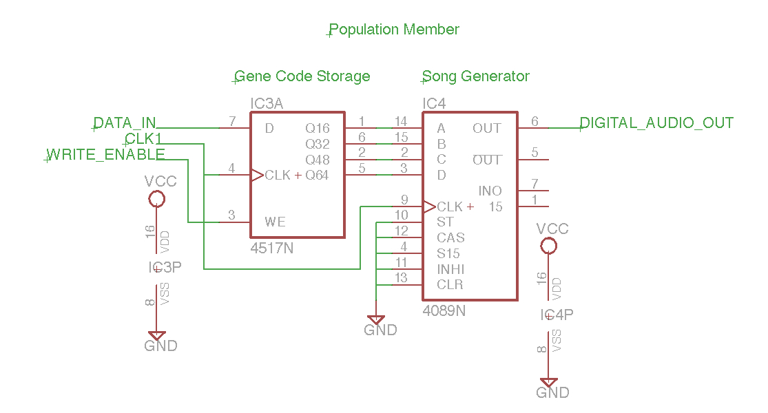

So that was the theory and now the practical aspects come into play. What we need is a storage element and an associated music generator.
I have been looking at the CD40105 chip, which I think is a bit esoteric and might be hard to buy, but it is a 4 bit wide by 16 nibble deep FIFO (First In First OUT). With that we could implement a step sequencer that had 4 bits of resolution (16 notes including the silent note if so designed) and 16 steps to it. That would be nice for this project because the pattern repeats often enough to be very recognizable, yet there are many possible patterns (4x16 is 64 bits, or 3 Giga-songs of variety).
Coupled with the CD4015 chip, since it has a 4 bit parallel output, could be a VCO with a 4 bit R2R ladder controlling it's frequency or we could use three bits for frequency and one for amplitude, etc. Whatever it is it's got to be super simple because ultimately we may want 8 or 16 population members so there will be a lot of wiring.
I could begin to go into other registers and song circuits for a few more examples before I run out of ideas, but I think I'll leave this topic open to discussion. After all, this is a community project so we need to work together and I'm personally eager to read what YOUR ideas are! So post now or forever hold your peace!
Les

PostPosted: Sat Jun 23, 2012 5:41 pm    Post subject: Reply with quote  Mark this post and the followings unread
Now this is the kind of teamwork I was hoping (and expecting really) to get from our electro-music.community! I'm working on the schematic. Here is a schematic image of the population member so far. It's reduced down to just 1.5 chips per population member. Datasheets are also posted.
Les

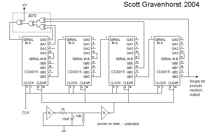

I was thinking about that, and yeah that's a good idea because some could have totally different song generators. Like male and female, where the range of notes produced by the voice tends to be higher for a female and lower for a male, or like racial differences or cultural influences, things that could affect the type of music that tended to be generated. Or perhaps one is a keyboard player and one is a drum player. I can see a use for that CD4011 drum circuit here for example. Really we should pool the "best" or a representative set of our Lunetta digitally controlled audio generators in this endeavor.
I tried to max out the sequence length and I found a four-chip implementation of a 167 bit sequence, schematic and additional data sheets attached.
Les

jcintheus wrote:
The 4089 won't really change the pitch of the audio frequency into the clock. The effect is more like "change in harmonic content".
Take a look at the above chart and notice that the frequency never changes, just the number of "clicks per sixteen" so to speak. Try it!
I use 4089 for rhythm variation.
Yes I thought of this but did not mention it in my haste, you said it quite well with that description "shane in harmonic content". But in some cases the pitch is changed, for example at ABCD = 1000 we have the fundamental frequency at half of the clock rate, but also harmonic content at the clock rate and multiples of the fundamental. So yeah, you are right. I propose we make one of our sound generators be this chip, and look at some others.
Does anyone know how to generate actual notes this way? or logarithms?
Les
jcintheus
Joined: Oct 16, 2011
Posts: 59
Location: Colorado
PostPosted: Sat Jun 23, 2012 6:49 pm    Post subject: Reply with quote  Mark this post and the followings unread
You might use a 4526 presettable divide by-n-counter.
Use "ABCD" to control the D inputs. Connect "0" to PE and take your output from that loop (pin 3 or 12)
This should divide the clock by what ever number is at the D inputs.
http://www.futurlec.com/4000Series/CD4526.shtml
