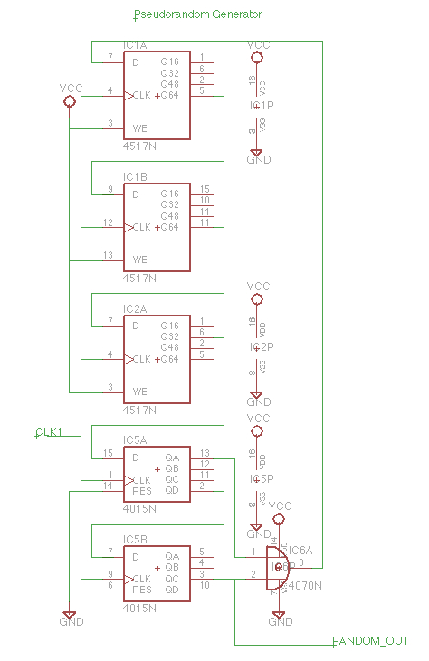

Here is a 32 bit LFSR schematic.  It and similar ciruits with different numbers of bits are used for CRC calculations and for noise.  The shift reg taps to the XOR tree create a maximal LFSR, meaning that all possible states except for 0xFFFFFFFF appear in the shiftreg given enough clocks.  Note that this is 4,294,967,295 states.
The output here is one bit, I was using it (filtered) for audio.  You can grab as many of the bits as you like from the shift reg Q outs.
I've added a taps table.  It shows how to configure maximal sequences with N bit shift registers up 168 bits.

You can do 26 stages with a 4006 a 74HC273 a 4070 and taps at 20, 24, 25, and 26.
Taps at 26, 2, 3 ,and 7 will give you a reverse sequence, and an xnor will give the complement sequence.
That'll give you a 67,108,863 bit sequence. I've never heard the end of it! Not bad for three chips! |

 	  | jcintheus wrote: | 	 		  You can do 26 stages with a 4006 a 74HC273 a 4070 and taps at 20, 24, 25, and 26.
Yeah, that's why I like to keep that chart.  How long it takes to repeat depends on the clock rate.  The list I provided is maximal for all sizes shown, but there are other tap combinations that are also maximal.  There are also tap combinations that are not maximal, these will repeat after a smaller number of clocks than a maximal system would. _________________ FPGA, dsPIC and Fatman Synth Stuff

I tried to max out the sequence length and I found a four-chip implementation of a 167 bit sequence, schematic and additional data sheets attached.

 	  | jcintheus wrote: | 	 		  The 4089 won't really change the pitch of the audio frequency into the clock. The effect is more like "change in harmonic content".
Take a look at the above chart and notice that the frequency never changes, just the number of "clicks per sixteen" so to speak. Try it!
I use 4089 for rhythm variation. |
Yes I thought of this but did not mention it in my haste, you said it quite well with that description "shane in harmonic content".  But in some cases the pitch is changed, for example at ABCD = 1000 we have the fundamental frequency at half of the clock rate, but also harmonic content at the clock rate and multiples of the fundamental.  So yeah, you are right.  I propose we make one of our sound generators be this chip, and look at some others.
Does anyone know how to generate actual notes this way?  or logarithms?
Les _________________ "Let's make noise for peace." - Kijjaz |
jcintheus
  Joined: Oct 16, 2011 Posts: 59 Location: Colorado
 Posted: Sat Jun 23, 2012 6:49 pm    Post subject:
You might use a 4526 presettable divide by-n-counter.
Use "ABCD" to control the D inputs. Connect "0" to PE and take your output from that loop (pin 3 or 12)
This should divide the clock by what ever number is at the D inputs.
http://www.futurlec.com/4000Series/CD4526.shtml |
