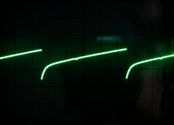

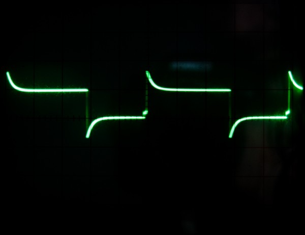

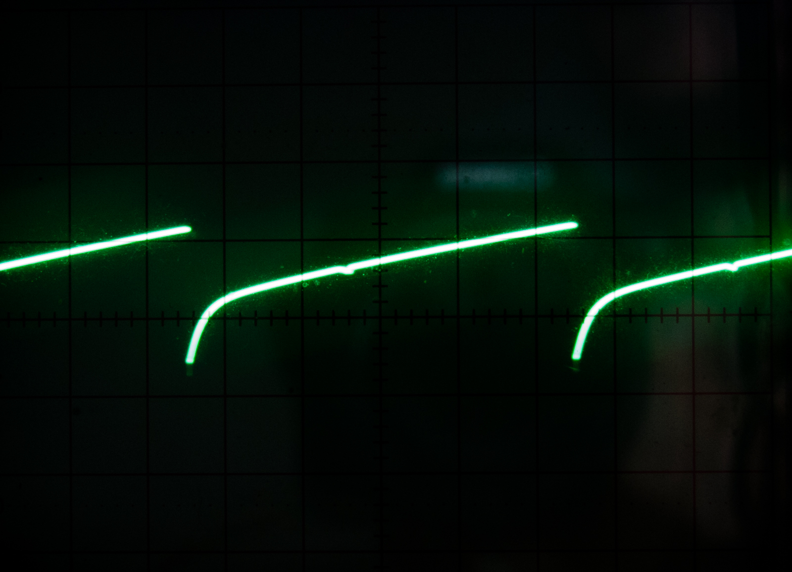

I got it sort of working.. However, the 'scope is showing some obscure artefacts (on both VCO 1&2)..
Any way I can flatten these spikes?

I just noticed the higher frequency the narrower the pulse width (and even at the lowest frequency, neither oscillator quite manages square). I'm sure that's not supposed to happen.
I wonder what is causing those tails (pictured above), and if that is related?
Any suggestions welcomed.

I have to admit that I'm flummoxed. Both VCO's have the same problem?
The only common thing that I can think of off the top of my head is either the 4011 or the +/-15v power supply (they're common to both VCO's) so I would start there, I would also make sure that any flux is cleaned off - I've had numerous problems with flux residue in the past, I now use a water soluble flux based solder, and just clean the back off with water and a soft toothbrush!
I wish I could be of more help... But I'll continue scratching my head over this one.

The suggestion by various people that the Odyssey sync was somewhat special sounding intrigued me so I checked out the schematics...
With the Odyssey VCO the sync input actually forces a fast completion of the discharge cycle, then once the normal threshold has been reached the oscillator resets. In a standard ENS76 type VCO with op amp integrator and comparator reset the sync input temporarily changes the reset threshold so that whatever point in the waveform its at the oscillator will just rest. It will not complete charge cycle.
So in the Odyssey VCO whenever sync is activated there would be a little "pip" in the waveform where it completes the discharge cycle. I assume this would be more obvious if the sync occurred early in the cycle, however it still may be hard to see on a scope.
I might try experimenting with an ENS76 type VCO to see if the same effect can be achieved by switching the input of the integrator to the negative rail with a FET.
