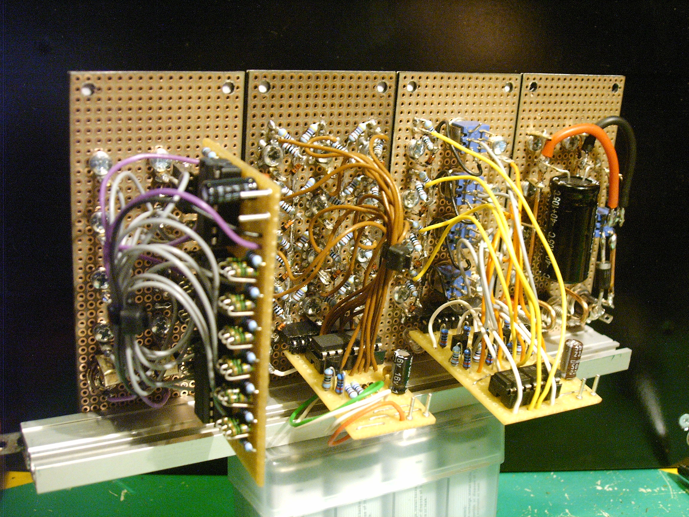

PostPosted: Sat Oct 20, 2012 6:19 am    Post subject: Modular Lunetta Reply with quote  Mark this post and the followings unread
Last week I finally started on a modular lunetta system. I really like banana's (jacks and fruit banana)
but they are a bit too pricey and you need a lot! And the PCB connectors are a bit to flimsy for my liking.
So I decided to use the bolts and crocks method after having some experience with this (and being
quite pleased with it), when I was working on some synth stuff.
but what really got me started is when I realised that I could use perfboard to make the front panels.
It's very easy to cut to the right size, you can solder components on it directly (great for mounting LED's)
and you don't need to measure anything when drilling holes for bolts/switches/jacks and whatnuts.
just count the holes for the right spacing. Very Happy
I used PCB connectors to mount the boards that hold the chips and other components. and on some modules
I also used them as an actual connector at the same time. I'm not completely sure yet about what I'm
gonna use for the power distribution, but I think I'll use cinch connectors like attdestroyers (but with + & - combined)
And I just found out that the space between the mounting holes and the edges of the fronts is just
right to mount them on a rail Razz spacing between top and bottom isn't a standard rack size so I have to
make something custom, but this will make mounting the modules very easy.
so here are some photo's I'll post more info about them at some later time, but feel free to ask,..
first 4 lunetta modules:
Power input / flame-LED oscillators / 4040 divider / triple R2R
 Filesize:  1.42 MB
 Viewed:  1541 Time(s)
first 4 lunetta modules: backside
 Filesize:  1.42 MB
 Viewed:  1431 Time(s)
PostPosted: Sat Oct 20, 2012 6:32 am    Post subject: Reply with quote  Mark this post and the followings unread
Putting the rest of us to shame, as usual Laughing
