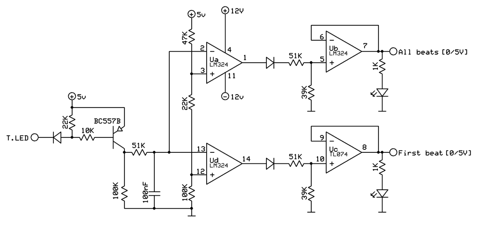

Posts: 5947
PostPosted: Fri Jan 18, 2013 7:24 am    Post subject: Reply with quote  Mark this post and the followings unread
I just got my hands on 2 'new' keyboards yesterday Very Happy
Because they look older then what I usually get I was hoping that these would not be your typical black blob matrix wired keyboards.
One thing I noticed is that they both have almost the exact same functions which made me wonder, could it be that they actually
contain the same chip ? They also sound pretty much the same except the demo is different.
So I opened them up, and they both contain a black blob but it doesn't look like your usual circuit. It has a lot more pins and there are
a lot of other components in there aswell. However one of those keyboards is constructed in such a way that I have to resolder some
ribboncables to actually see what parts are on it and how it's wired.
anyway, after drawing the schematic of the other keyboard, I searched the web to see if I could find some info on it. I did a quick search
yesterday but didn't find a lot. But now I did, and what I suspected just got confirmed Laughing . The keyboard I drew the schematic of is labeled
as 'SUPERB SOUND model EK-210" while the other one doesn't have any identification on it at all. But by looking for the EK-210 I ended up
at the Table Hooters site for the Hing Hon EK-001, and it turns out that that is the other keyboard I have Shocked !
banana party!
Searching for the Hing Hon EK-001 gives a lot more hits and it's also how I found this thread, So I shall share any info here.
first some dfferences between the 2 keyboards:
The EK-210 has seperate controls for rhythm and voice volume which the EK-001 doesn't have (so you can add that to it).
However the EK-001 has a mic input with volume control, the EK-210 doesn't have a mic inout at all. I haven't tested it, but I assume
it's just mixed in with the signal, not processed in any way. (Might be usefull for feedback though). As I allready mentioned the demo is
different, I really like the melody of the EK-210. Not sure what it is, but I'll probably find that info somewhere. The EK-210 runs on 6
batteries and has a DC input labeled to be used with 9V. While the EK-001 runs on 4 batteries and has a DC input labeled to be used with
4.5-6V. The EK-001 has a headphone ouput, the EK-210 doesn't. And then there is another very usefull feature on the EK-001, a beat LED
which actually flashes brighter on the first beat. I have to check what signal this is (probably PWM) but I bet it can be used as a CLK for
other circuits Very Happy (and add it to the EK-210)
I haven't drawn the schematic of the EK-001 yet (might be available online) so I can't compare the actual circuit yet. I did noticed there was a
trimpot on the Ek-001 PCb which the EK-210 doesn't have.
Some things I noticed from the EK-210 schematic. There is a voltage regulator section with a 5.1V zenerdiode for the supply of the main chip/blob.
I will probably replace this with a standard 78l05. There is an LM386 in there which is powered directly form the input voltage. Well not directly,
since there is a 4.7 ohm resistor in series with the batteries/DC in. There are 3 resistors and 1 capacitor in there that I'm not sure what they
are for yet (I'll approach them with my finger Wink) I guess at least 1 is for pitch, maybe in combination with the cap ?. But I bet I can find that
info somewhere. And then there is something I'm wondering about considering the drum sounds. 4 pins of the chip/blob are tied together to
produce the drums. There are also 4 drum sounds, could it be that each pin has a seperate sound ? Or otherwise just adding some switches
between those pins might give some interesting variations. (anyone who tried this ?)
I'm gonna see what info I can find and I want to draw the schematic of the Ek-001 aswell. After that I have some other projects that I should
finish first because it looks like this is gonna be a big but fun one (maybe I'll combine the 2 keyboards)
edit: link to the similar ak-900 PDF (with schematic).
Posts: 5947
PostPosted: Fri Jan 18, 2013 11:09 am    Post subject: Reply with quote  Mark this post and the followings unread
I'm reading the AK-900 pdf which is VERY interesting Very Happy
it does seem to use a 9037 chip while the EK-201 uses a 9038 chip. Maybe it's just the demo that's different maybe something else,
but the schematic of the AK-900 is very similar to the one I've drawn of the EK-210. (will post it here)
Looking at the block diagram of the 9037 it shows (as I was hoping) that the 4 pins used for the drums each have there own drum sound.
Which means you can add level/panning control and on/off switches (which you could control with some logic) for each of them Very Happy
I'm wondering now if it would be possible to add an external oscillator instead of the build in one, then use some digital waveform and
play with that on the keyboard.
edit: I'm actually pretty sure it can work with an external oscillator,. hmm how about a CD4046 ? or since I'm working on Tim Escobedo's
PWM circuit (with VCO) add that, have some other sound source control the main CLK speed of the CPU. Also the key frequencies are derived
from the main CLK so if I divide it and hook it up to the CLK of the other keyboard I should be able to play 6 octaves.
I'm also thinking of getting some keyboards with larger keys for this. I found some usefull ones, but shipping costs will bring it to ±15.00 each.

Posts: 5947
PostPosted: Sat Apr 20, 2013 12:32 pm    Post subject: Reply with quote  Mark this post and the followings unread
Another thing I did is convert the tempo LED into usable signals. Besides blinking on the beat the Tempo LED flashes brighter on the first beat.
The way this is done is by turning the LED on/off on the first beat while on the other beats it's not fully on but instead it's just flashing really fast.
So I buffered the signal and added a low pass filter which converts it into 3 different DC voltages. These are converted into two outputs with the
help of two comparators. One that is only high on the first beat, and one that is high on all the beats. Voltage levels are then converted to 0/5V and
buffered.
I haven't soldered this part yet but after this I probably have room left for about 3 more chips on the perfboard I'm soldering. The only signals
from the keyboard that I haven't processed yet are the drumsounds so that's next. I'll probably add some buffers and trigger inputs and
leave the mixing for another PCB. Since those are squarewaves too, mixing them with logic might give some interesting result. Laughing
note: at higher tempo's the first beat LED triggers on all beats, I solved this by replacing the 22K resistor (between pins 3 and 12) with a 47k one.
