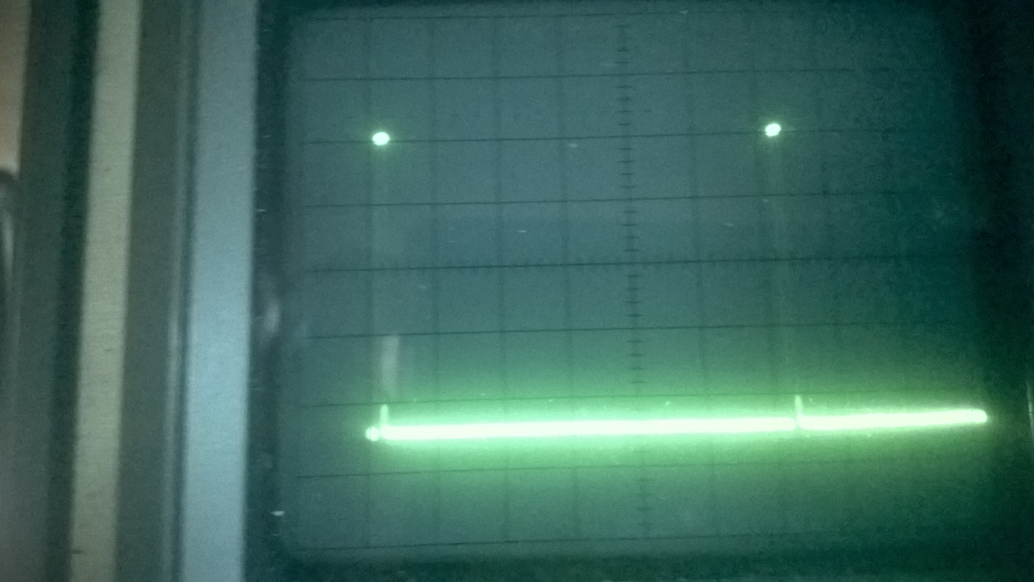

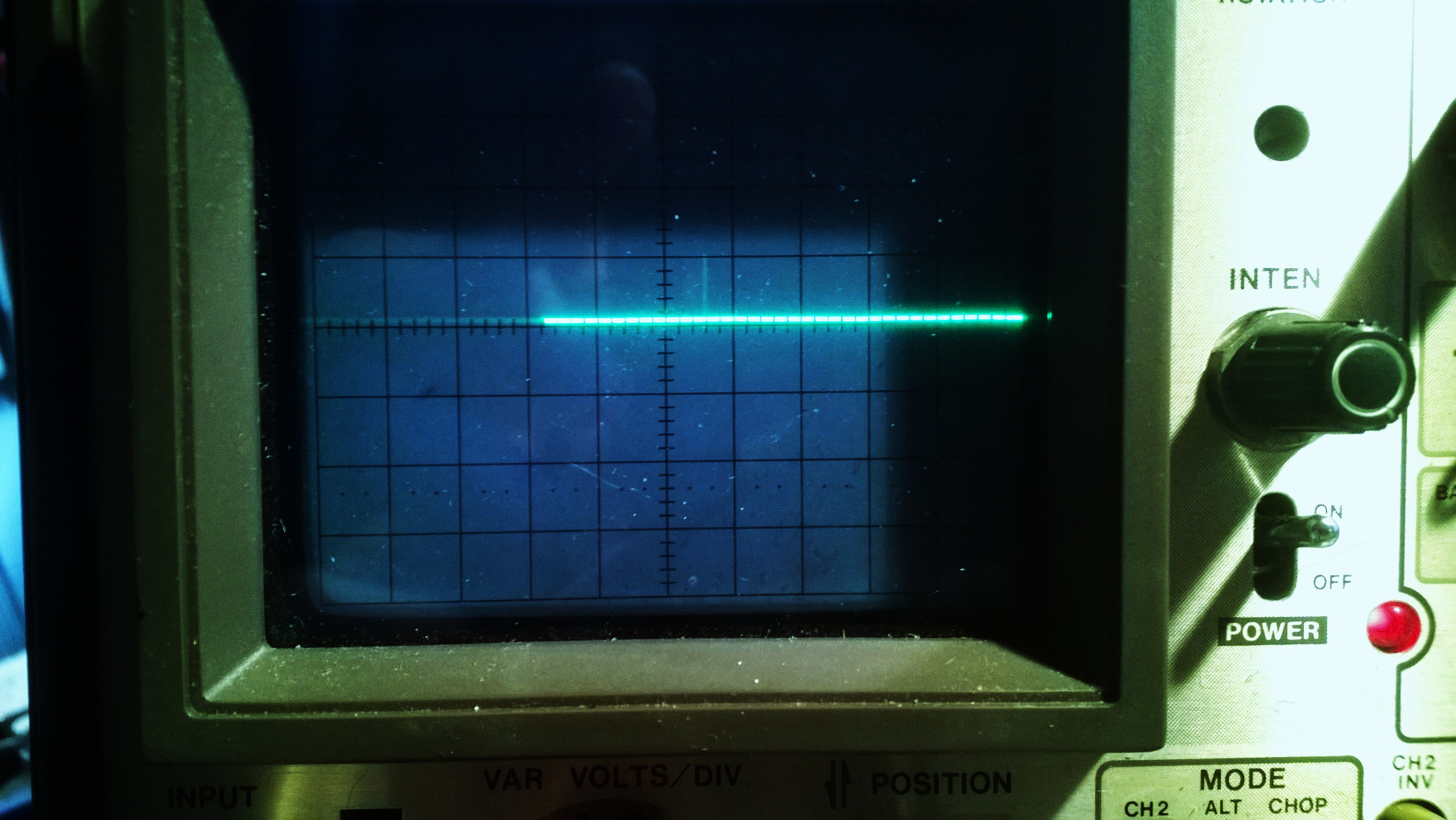

Not the greatest scope images... first shot is D18k and pin14 4017. It shows about +10v. Second shot shows D18 anode, about +10v and -12v. The volt/div is 0.5 and the time/div is 10ms.
One last question? Shouldn't I be getting scope readings from the gate and trigger outputs? (as shown in schemo) I am getting readings from all 3 CV outputs only, +4 to +6v.
 Filesize:  2.88 MB
 Viewed:  438 Time(s)
 Filesize:  2.89 MB
 Viewed:  379 Time(s)
