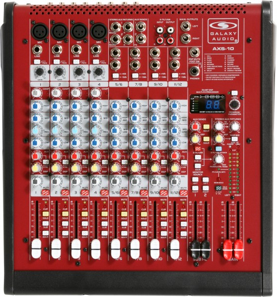

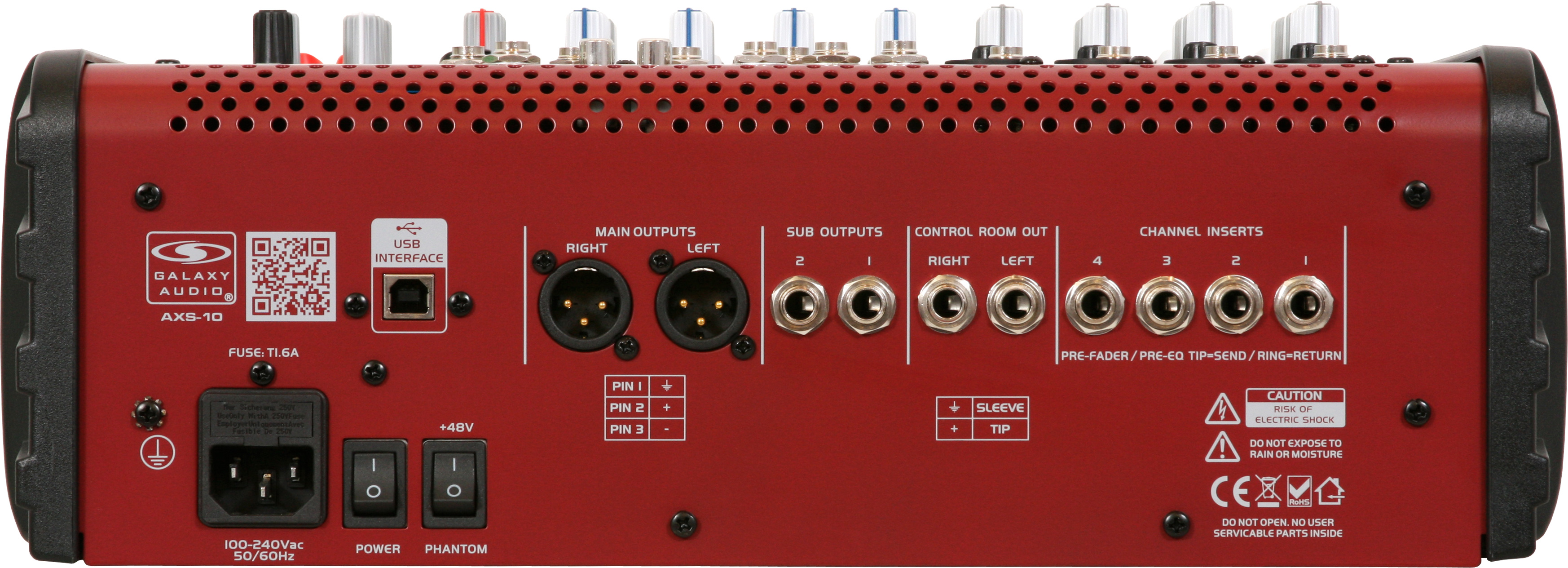

PS: My wife ordered me one of these for more Zero Input Mixing, for my 61st birthday last Tuesday, should be here this week. Smile Jeremy and I were searching for likely candidates with features specifically for ZIM. He tracked this one down. Cool
AXS-10 front
 Filesize:  1.98 MB
 Viewed:  1199 Time(s)
AXS-10 back
 Filesize:  1.11 MB
 Viewed:  1212 Time(s)

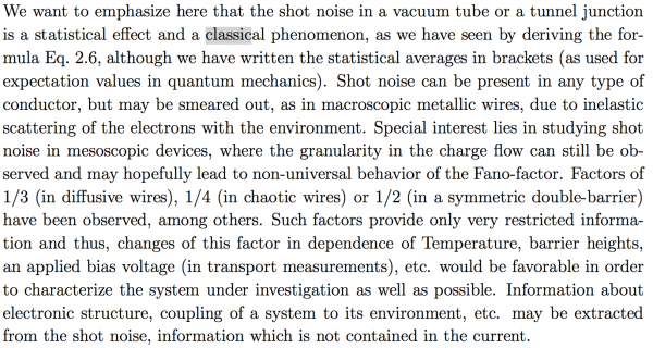

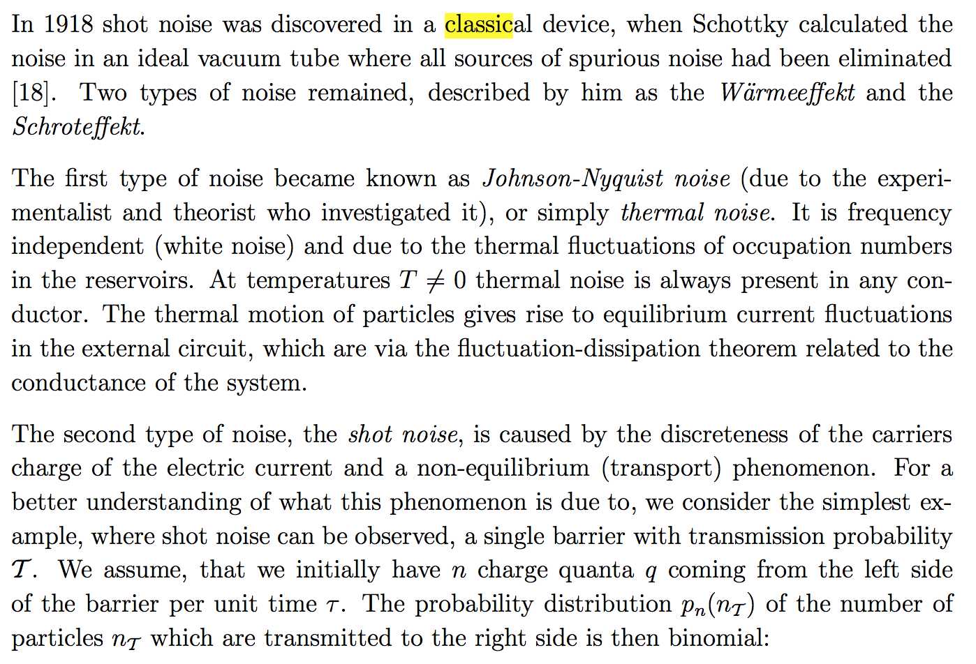

In reading parts of the thesis (the last post above), I am forced to backpedal somewhat in my fixation on quantum-only sources of noise bootstrapping the audio feedback process.
I cannot copy text out of this PDF (password protected), so I took screen shots of 3 relevant paragraphs after searching on the string "classic". The electrical noise (in transistors & probably in "passive" components) may contain both classical (i.e., non-quantum) and quantum noise-generating mechanisms. They all get amplified going around the loop. Classical noise probably predominates.
Therefore, the inability of a digital algorithm to model this analog phenomenon adequately may not be due strictly to quantum noise generation, but also to hidden variables in classical, statistical noise generation such as thermal noise. The variables are hidden because there are too many variables in play to know and model, as in any complex (but classical) mechanism. I certainly don't propose that my 5-string banjo sounds employ quantum mechanisms. Digital modelers don't model acoustic instruments adequately because there are too many non-general variables in an instrument's sounds. Likewise with classical mechanisms for statistical electrical noise. Nevertheless, electrical noise remains a stochastic mechanism that a digital algorithm can only approximate. There is no need to invoke the quantum to get that digital infidelity from electrical noise. Hidden variables do the job.

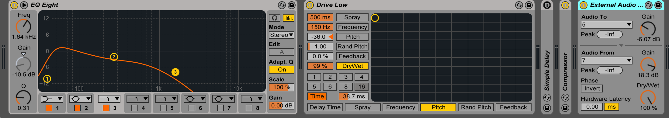

My shiny red mixer arrived yesterday. Cool I was too tired to do more than a sanity check, but I did manage to get transient sounds like running a wet finger around the rim of a wine glass, that (if I could get them to persist) I'd like to use as a background pad.
I am thinking of extremely long duration delays, maybe by running the feedback loop through a ChucK or Supercollider or Kyma patch. The mixer has some delay FX of limited time span, but I start to see how, if I can get a minimal (very low amplitude) signal to stick around long enough going through a very long delay with sufficient wet-to-dry, I can get 2 forms of oscillation going, the short-term "second order bootstrap tone" (the "first order bootstrap" being the electrical noise that starts the whole thing in the first place), and a "third order sustaining tone" which is just the second order tone sustained around a very long feedback delay.
p. 11, sec. 2.1
 Filesize:  221.93 KB
 Viewed:  1129 Time(s)
p. 13
 Filesize:  179.86 KB
 Viewed:  1074 Time(s)
p. 21, sec. 2.2
 Filesize:  198.1 KB
 Viewed:  1062 Time(s)

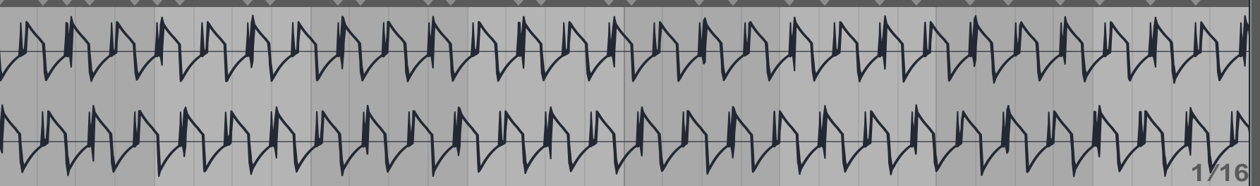

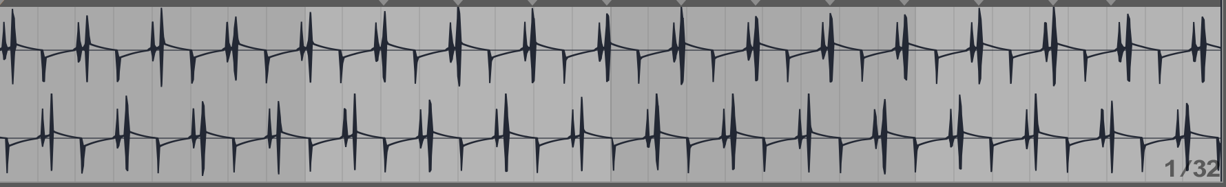

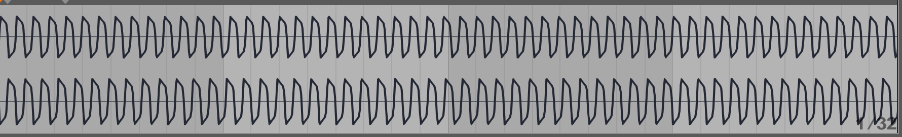

I thought it might be instructive to look at some waveforms. I worked with low frequency pulses near the temporal boundary between distinguishable pulses and pulses that merge into bass tones.

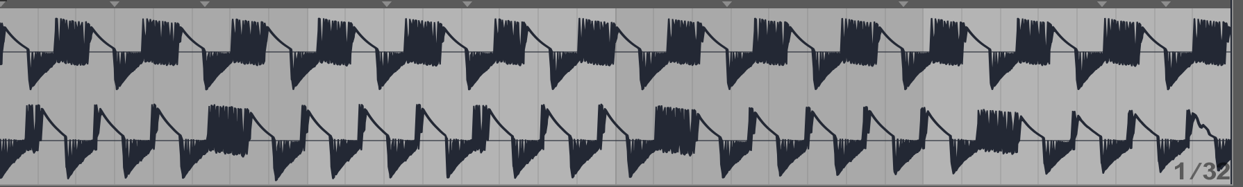

This post shows the new Galaxy AXS-10 (the red mixer) with L and R saturated and the compressor fully engaged for my default.
I'll show the other mixers in posts below, so as not to run out of attachment space.
AXS-10 pulse train approximates a clean reverse sawtooth
 Filesize:  92.3 KB
 Viewed:  852 Time(s)

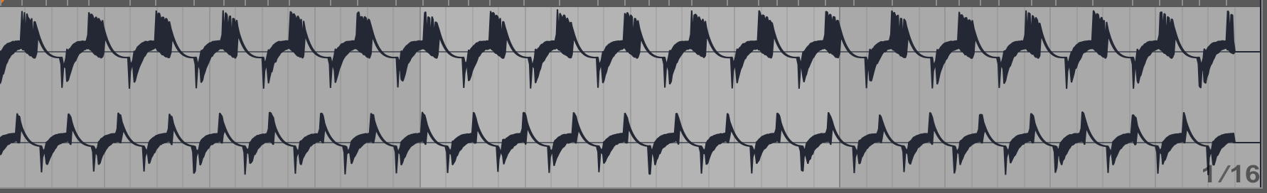

Overdrive to add high frequencies. Note the asymmetry: The positives slopes have noise, while the negative slopes (including the drop to the trough, i.e., the "negative peak") do not.
 Filesize:  98.03 KB
 Viewed:  849 Time(s)

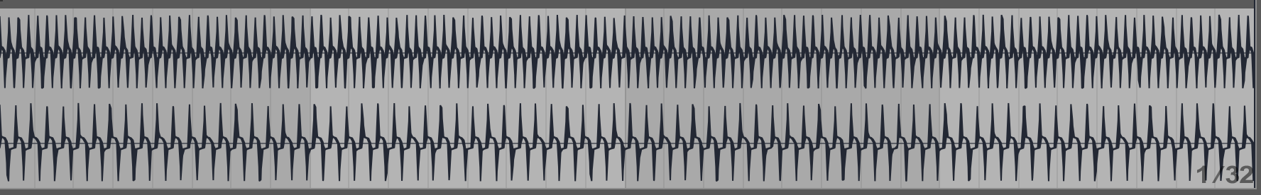

Compressors off on this. Now noise on both sides of 0, but note the lack of noise on the decay from the peak. There is also a second, semi-periodic beat in the right channel.
 Filesize:  116.59 KB
 Viewed:  851 Time(s)

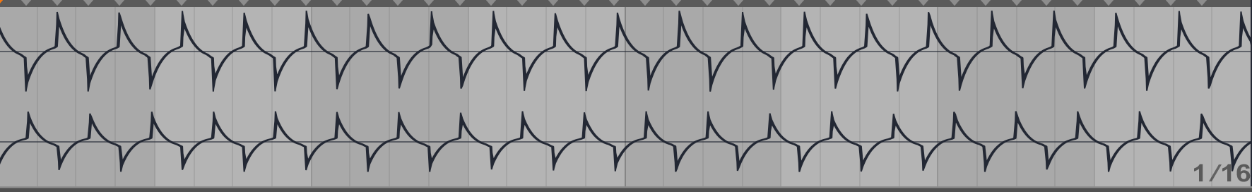

The Yamaha MG124cx, in comparison, has a basic pulse that begins to approximate a square wave, especially in the third pic, after turning off the compressors.

Yamaha MG124cx basic pulse full compression + overdrive adds "bird squeaks", like the AXS-10 only on the attack above the 0 line, but not on the trough attacks.

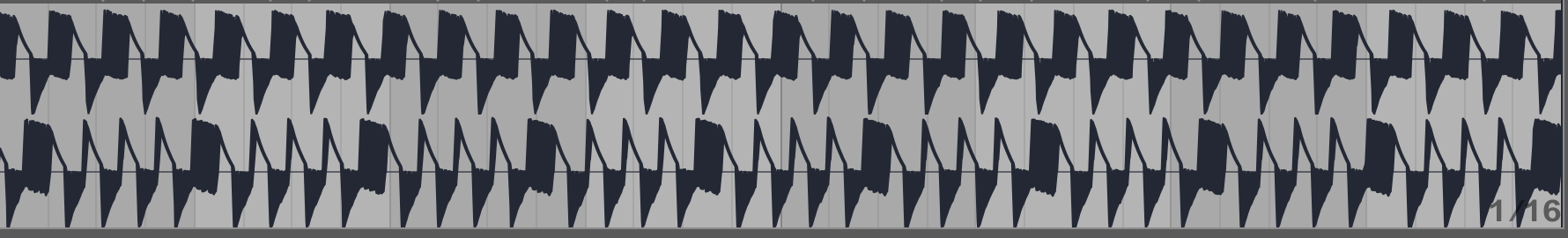

The little Alto ZMX862 is in a class of its own. Rather limited range of behavior due to lack of compressors or a second bus, and no FX (none of these pics use the FX units of the other two mixers), but it sure has a unique basic pulse and sound, with fairly good pitch range. It is especially throaty and interesting in the bass range.
All 3 mixers show asymmetry above versus below 0. Any ideas why?
ZMX862 basic pulse train. The rising edge to the peak "above 0" actually has overtones that go + and -.

PostPosted: Tue Jan 05, 2016 10:54 am    Post subject:
Subject description: The Final Five
I played and recorded the attached The Final Five as a 6-minute extension to my 4:15 Electro-Music 2015 sampler piece Baby's Electro Castanets in early October, as a ZIM piece that Michael O'Bannon looked into visualizing for inclusion in the SEAMUS 2016 planetarium venue at Georgia Southern University in February. Unfortunately, their projector requirements were substantially out of the ordinary, so the video part of this piece did not come to pass.
This is a combination of standard ZIM and also computer ZIM. Computer ZIM feeds analog outputs of the audio interface box back to its analog inputs, and processes the signals in software (Live in this case, although I have worked with ChucK in this way, too), so the signal source is still analog transistor noise. I am adamant about not generating the primary signals using software, for information-theoretic reasons that I have posted above and elsewhere. I see this aesthetic decision to be the same as feeding purely acoustic instrument signals into the computer, rather than using inadequate models that approximate acoustic instruments. I have no aversion to primarily abstract software-synthesized instruments that don't pretend to be something else like banjos. Cool
I remember editing various different ZIM recordings together into the first 4:15 for the EM2015 sampler. The added 6:00 was all live performance, I think. All 10+ minutes are in the attached file.

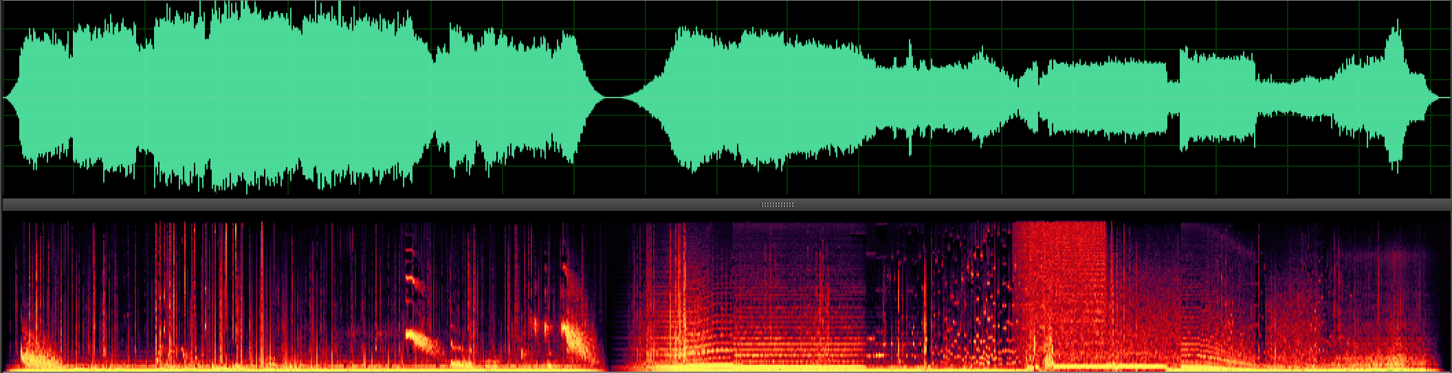

Adobe Audition waveforms
 Filesize:  342.84 KB
 Viewed:  875 Time(s)

I spent an hour last night playing around running an aux send from the red mixer through Live and back to the mixer, side-tapping the signal to mix it into Live's output. It was very interesting to put a graphic EQ in front of a granular delay, manipulate the granular to do some pitch shifting&filtering, and then *see the effect in the waveform appearing in the EQ, which sits before the granular in the chain*. I could actually see the feedback, in the sense that manipulating the "after effect" in the signal chain changes the display of the "before effect." Of course, in a loop, there is no before -> after relationship.
When I get time, I'll post a short youtube or vimeo clip and link it here.
I was getting some new sounds out of this, gas from a gas jet in a stove, wind, something that sounds like wind on a mic without a windscreen (pop filter), wind breaking tree branches. I'll post when the time comes.

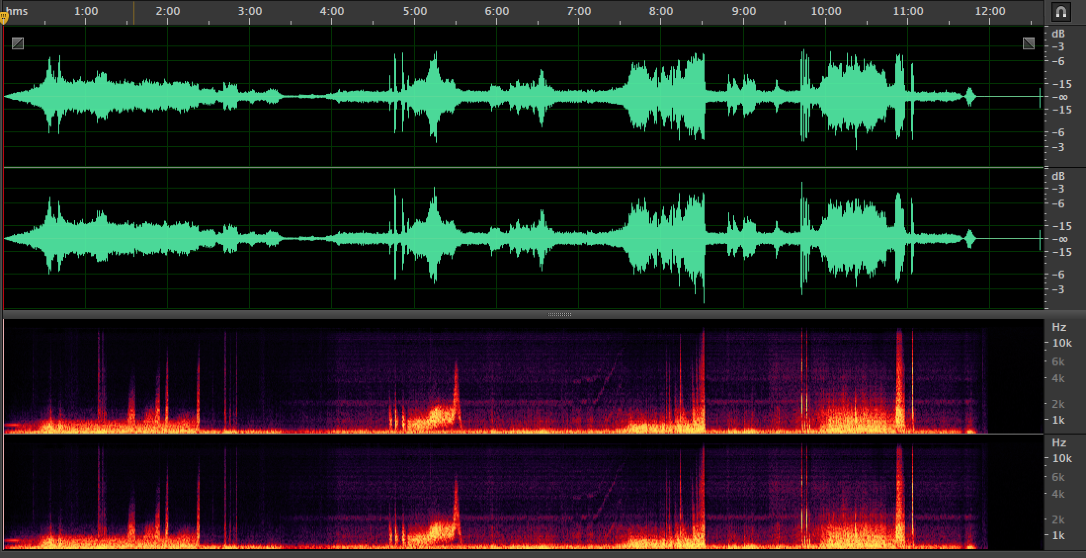

PostPosted: Fri Jan 22, 2016 7:31 am    Post subject:
Subject description: Electro ZIM Fire
Here is a 12:39 workout Electro ZIM Fire that is an exploration of fire-like timbres. I fed the mono Aux Send from the red ASX-10 mixer into Live, through a graphic EQ, a grain delay, and a compressor. I used a simple delay before the compressor in a few short places in the 2nd half of the session. The EQ was to allow me to try to avoid excessive pops, especially in the high frequencies. The grain delay and the mixer itself were my main controls, grain mostly for pitch & somewhat for timbre. The compressor was a safety net to trap the pops. The output of that goes back to an input of the mixer, and a side tap takes it to the output of Live. The mixer runs an input through the usual gain, compressor, EQs, level slider, Aux level knob, and from there out the Aux send, completing the feedback path. I didn't use the main out or 2nd stereo bus of the mixer, nor any mixer FX.
I ran another signal path from the Yamaha MG124cx mono Aux send through an identical, parallel track in Live.
At various places this has sounds like a propane stove gas jet, a wood fire in the fireplace (complete with the sounds of crackling and the draft up the chimney), a forest fire, thunder, and some pure electro sounds. Runaway feedback got away from me a few times, so I edited those down to safe levels before posting. Waveforms & the Live channel appear below.
Waveforms
 Filesize:  664.29 KB
 Viewed:  879 Time(s)

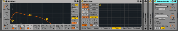

Live signal processing in the feedback path.
 Filesize:  165.17 KB
 Viewed:  836 Time(s)
