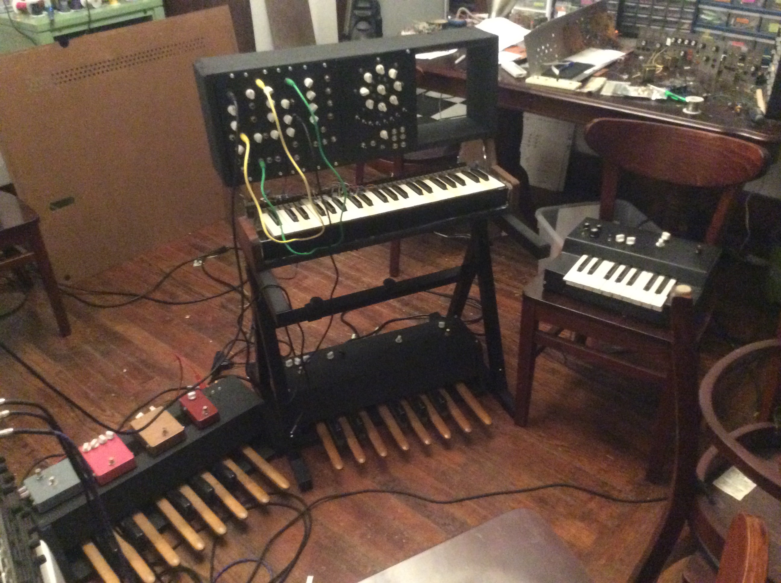

This is pretty much 2016.
On left, rebuilt my MIDI bass pedals with a better set of pedals.
Stomp boxes on top are delay, DR Q, tremolo, and distortion.
Bass pedals to right are basic analog, saw tooth VCO, a delay and passive filter.
Analog modular on top of it has MIDI to CV, Thomas Henry VCO1, a 2 octave divider module, 4 channel mixer with small patch bay. And my 8 channel sequencer I'm still working on. All modules are perf board.
To the right is my mini top octave synth based on the PAIA OZ with some major mods.
I'm in the HVAC business and it was a mild winter here. I had a lot of time for projects.
Come to think of it, I quit drinking January 4th. I might be a little over focused LOL. there is a drawer full of circuits I built and didn't like.
Oh, and there is an old set of PAIA 2720 modules on the table in the background I'm almost done restoring.

Great looking pedals Cfish

Congratulations! Well done! All of that-
Btw.What the xxx ist HVAC business??

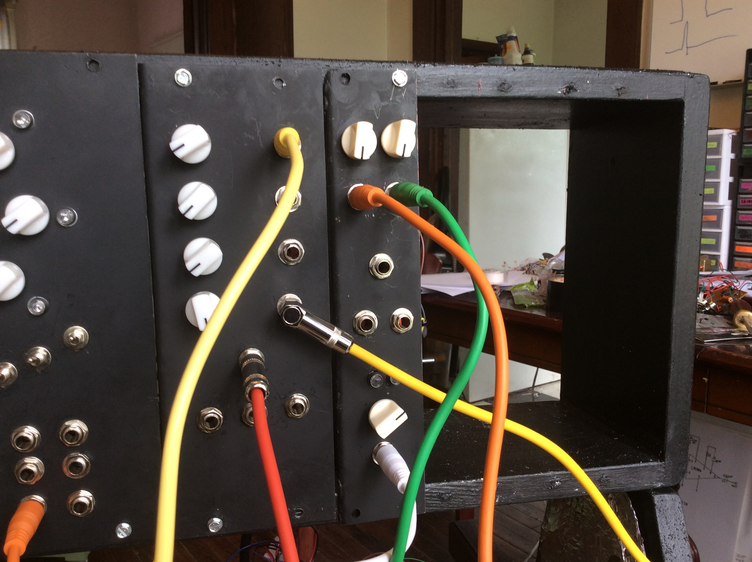

Another module up and running.
Built this as a supplemental extra, but I really like it. Is a combo simple 3080 VCA, simple AD/AR envelope and simple sub audio LFO all in one. All things I wanted a little extra of in this rack.
Once I got patching with it, I liked it so well I wish I had room for 2 in this rack.
It's the module on the far right.
I am absolutely dreading tearing this all back down for final paint and graphics.

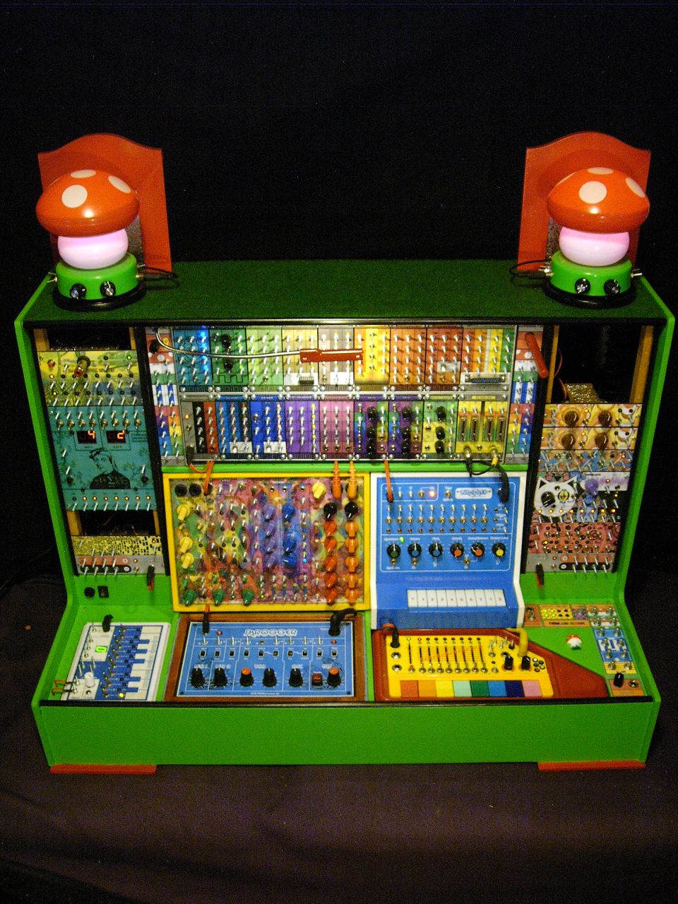

a lot of you might have already seen it, but I built a case for my lunetta synths. Cool
more info and photos here

Colourful!

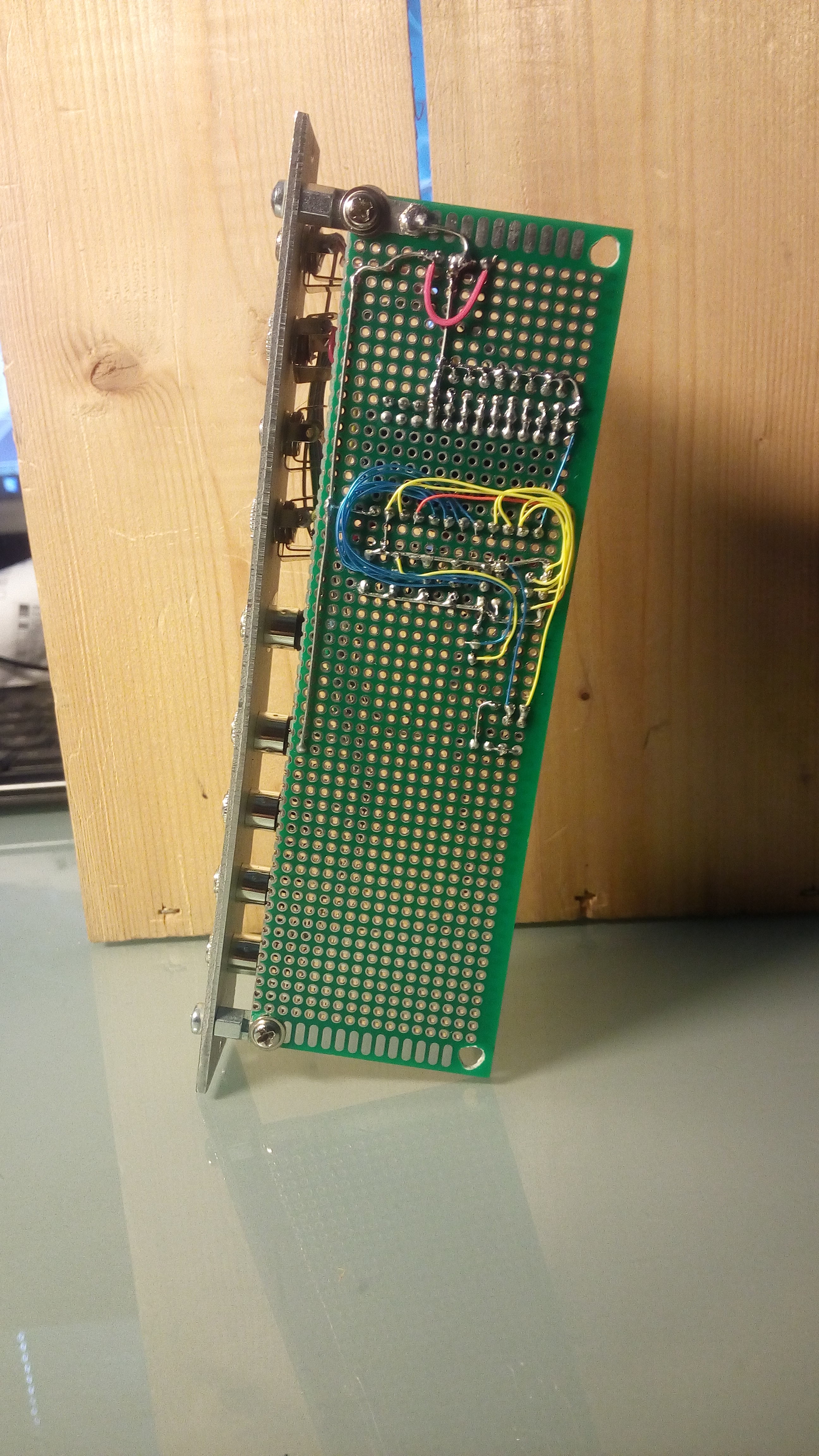

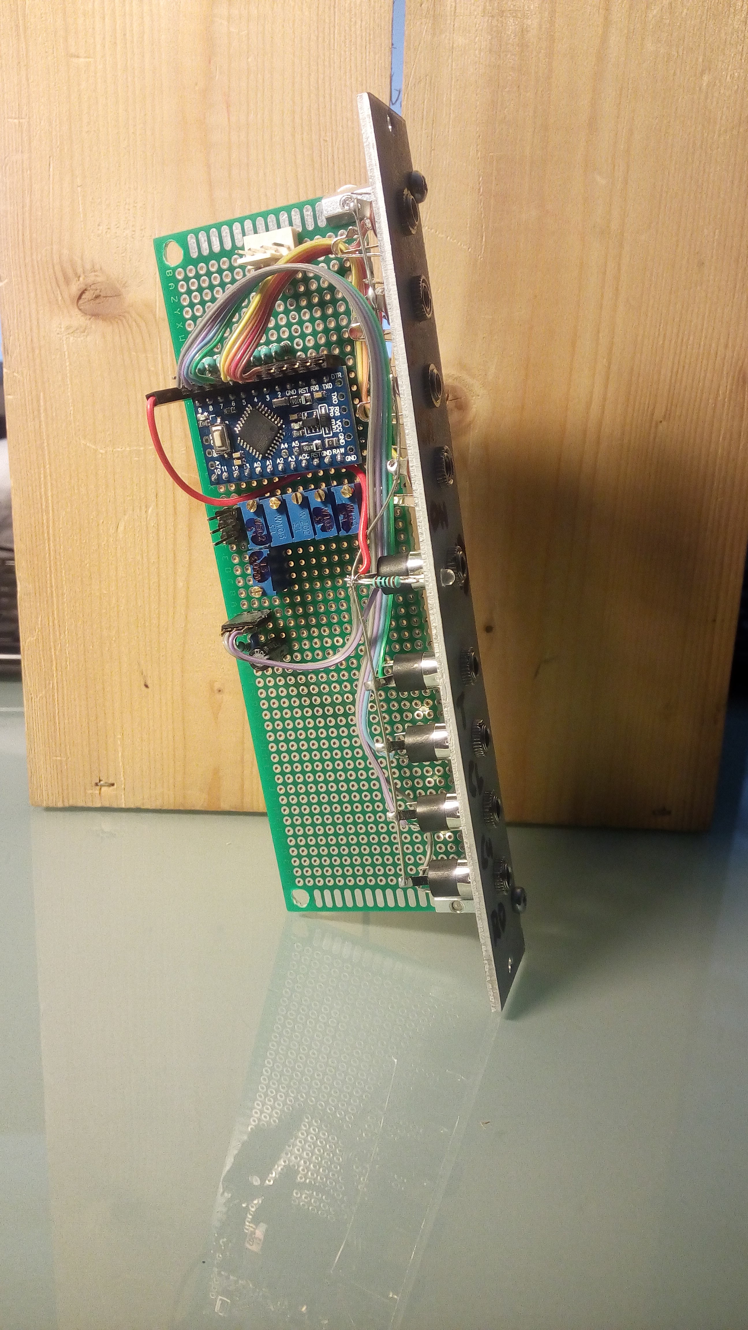

An 8 channel drum module, based upon the awesome work of Jan Ostman.
The things I changed in his program is that the drums trigger on the leading edge at the inputs, and no accents.
The pitch is semi-fixed (with trimpots) so if I need, I can change the pitch.
(ofcourse I donated 3$ for his work!)

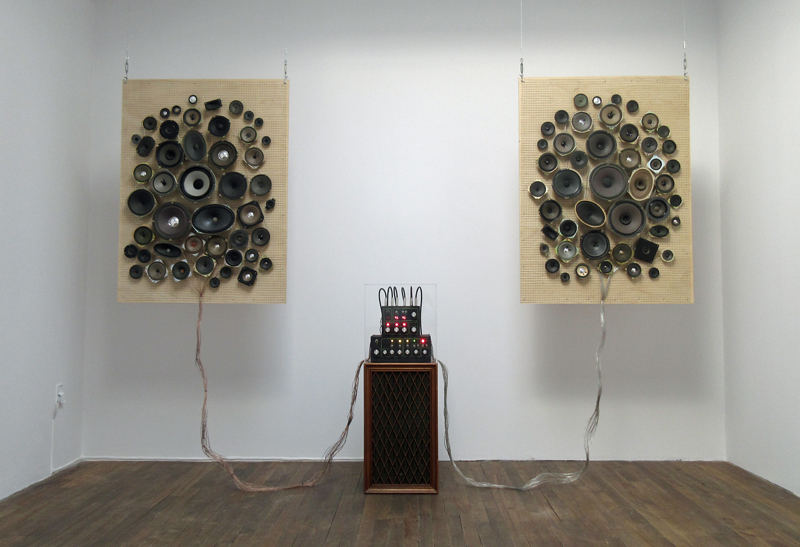

I did a re-house of the main control box for my crazy speaker installation piece called The Sweet32 Speaker Interrupter-Switcher Installation Thing (Ceci n'est pas la haute-fidélité)*.
I was attempting to include a few more features and improve the amplification part. Previously I had used the LM386 (I had only been doing self-taught electronics for 2 years at that point), and this time I went for a TDA2030A-based kit, but I think that wasn't such a great choice finally either.
Since I didn't want to re-do the entire circuit, I kept the old boards (seen in the center), bypassed the old amp section, and added in the new board on the right (which consists of a couple of PICAXEs, a 4066 plus a simple white noise generator). A buck converter turned out to be a bad idea, generating noise, so I had to squeeze in a separate transformer to power the logic part.
So it's quite the Frankenstein monster in there. I couldn't find an appropriately-dimensioned box, so I made one of Baltic birch plywood.
The installation consists of two panels containing each 47 speakers, 16 of which are wired to the control box, which can interrupt the sound on each channel independently, and randomly select which speakers are active at any one time.
An "Automator" box generates the frequencies that are played, as well as slowly changes the speeds of the interruption and randomness.
If anyone in the Montreal area is interested, it's on display at OBORO thru June 18th.

New control box stack for the Sweet32 speaker installation... The box on top is the Automator, and it sits upon the brand new control box rehouse.

The Sweet32... Speaker Installation overall view.

Nice installation James :-)

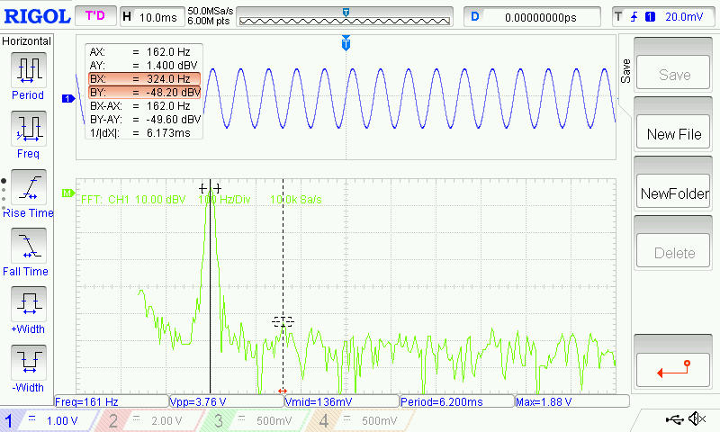

Simple phase shift oscillator producing a clean sine wave for comparison purposes when trimming the sine output of a VCO. Not going to see much use, but handy little circuit. Based on Elliot Sounds' miniosc.
The timing resistors are mounted in a DIL socket so they can be swapped out, giving a range from 150HZ to 15kHz.
Scope shots of the sine wave, and FFT showing the second harmonic down about 50dB, and the 3rd harmonic in the noise. (Mainly to show off my new scope, Rigol 1054 - liking it a lot Smile )
