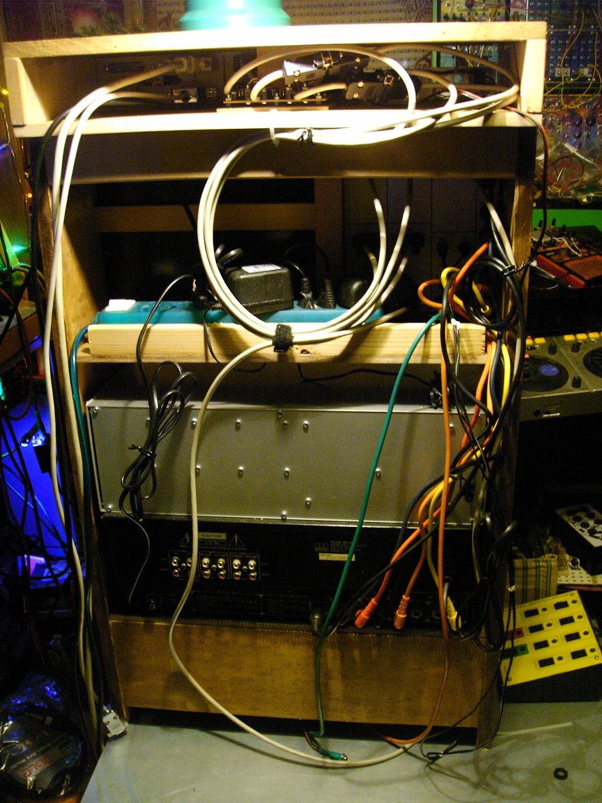

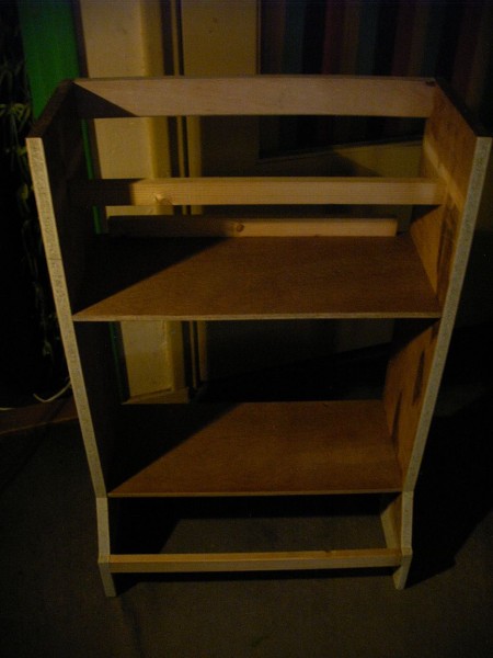

I am currently working on a rack for some gear made from scrap wood.

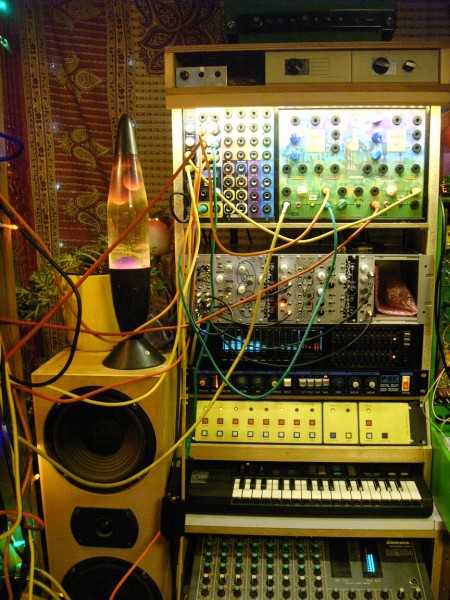

In theory it is actually pretty much filled up, I have all the gear to put in there. But it is also going to have a panel with some in/outputs,
so I have to figure out what I am going to put on there. One thing will be the CV control for the PSK DD2000 Digital Delay and I am going
to put the connectors for the 'Melt-yer-Face' on there. I also need to order the connectors for it and it will take a couple of weeks before
those arrive. But here's a teaser pic just for you which also shows where the panel is located. (next to the WoggleBug XL).

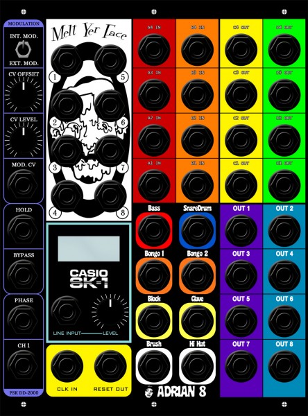

Ok I think I figured it out, here's the current panel layout/design. From left to right;
PSK DD-2000 Digital delay connectors which has:
- Channel 1 input and Phase output connections (just wired from back to front like a patchbay)
- Gate inputs for Hold and Bypass functions
- CV input and controls for modulation of the delay time.
(more info on the CV mod and gate inputs can be found here
Melt-Yer-Face connectors to interface with my euro-rack modular synth.
CASIO SK-1 line input for sampling, with a level meter and attenuator. The socket is normalled with an input on the backside
which will be connected to one of the output channels of my mixer.
CLK input and RESET output from my DIY drum controller.
The connectors on the right half of the panel will all be connected to some switches that make it possible to connect them to each other in
different ways, including logic AND. It also has protection on the inputs (overvoltage/negative voltage) and output buffers. I will post a
photo of the switches some other time but it is something I put together a while ago using some computer switches meant to connect multiple
devices to a parallel / serial port.
So the panel connectors that will be connected to those switches are:
modular lunetta interface in/outputs
ADRIAN8 drumbox inputs (these are already present on the drumbox but patching will be easier on the panel). Connectors will be
normalled with the outputs of my DIY drum controller.
8 gate outputs for whatever else I want to connect. Don't have a dedicated purpose for those in mind but they can be switched
to the ADRIAN8 inputs and thus the outputs from the drum controller as well, so I could use them to control some other drums.

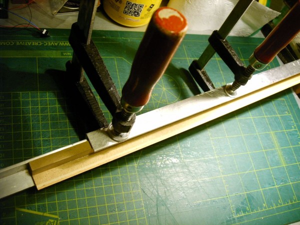

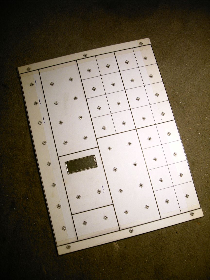

I drilled some holes. Usually I print out a drill template and than stick it on with some spray-glue and secure it with some masking tape.
However the 'problem' with it is that once you start drilling the paper tears away. I do always use a centre punch before but it is useful to
still have a reference when drilling. This time I had stuck the drill template to some thin cardboard just for testing the spacing and if it would
fit in the rack and I decided to use that for drilling too as a test. So I secured it to the (aluminium) panel punched holes and started drilling.
This actually worked great so I will probably use this method in the future too.
For attaching the final front layout to the panel I usually use special, very thin, double sided adhesive tape. At least for aluminium panels.
But I don't have any at the moment and I wondered if (PVA) woodglue would work. Sticks great to paper and I use it for wooden panels but
I had no idea if it would work well on aluminium. So I did a small test and it seems to hold on very well Very Happy

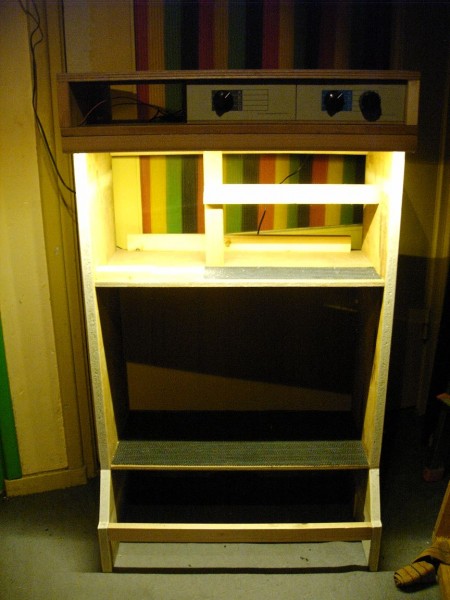

PostPosted: Sun Nov 27, 2016 3:04 pm    Post subject: Reply with quote  Mark this post and the followings unread

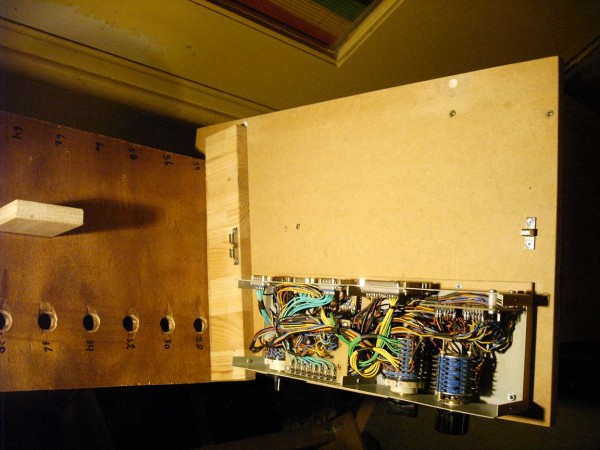

I mounted the switches to the top by first mounting them on a piece of thin MDF and screwing that to the top. I also added
a cover so I can put something on top. I made it in such a way that it can be removed to have access to the connectors on
the back of the switches. I have some extra space left next to the switches and I am not sure what I will add there, but I
did order a LED strip which I want to mount under the protruding top so maybe I will add a dimmer for that.

I received the LED strip so mounted that one today and it works great Very Happy . The whole strip was actually made of 2 parts that were soldered together
and one of them was just the right length. So I removed the solder and split it in half. I used two pieces of wood, one to mount the strip on and one
to cover it so I don't get blinded by it because it is pretty bright. And it also looks better than seeing all the individual LEDs. Although the strip came
with an adhesive backside I did use some epoxy to secure it to make sure it woud stick.

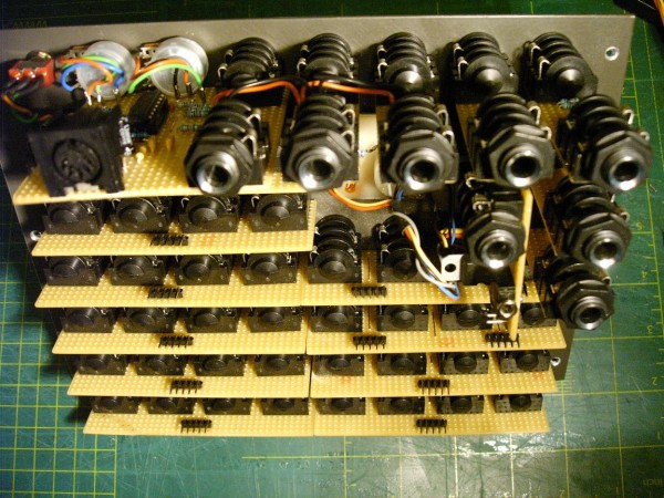

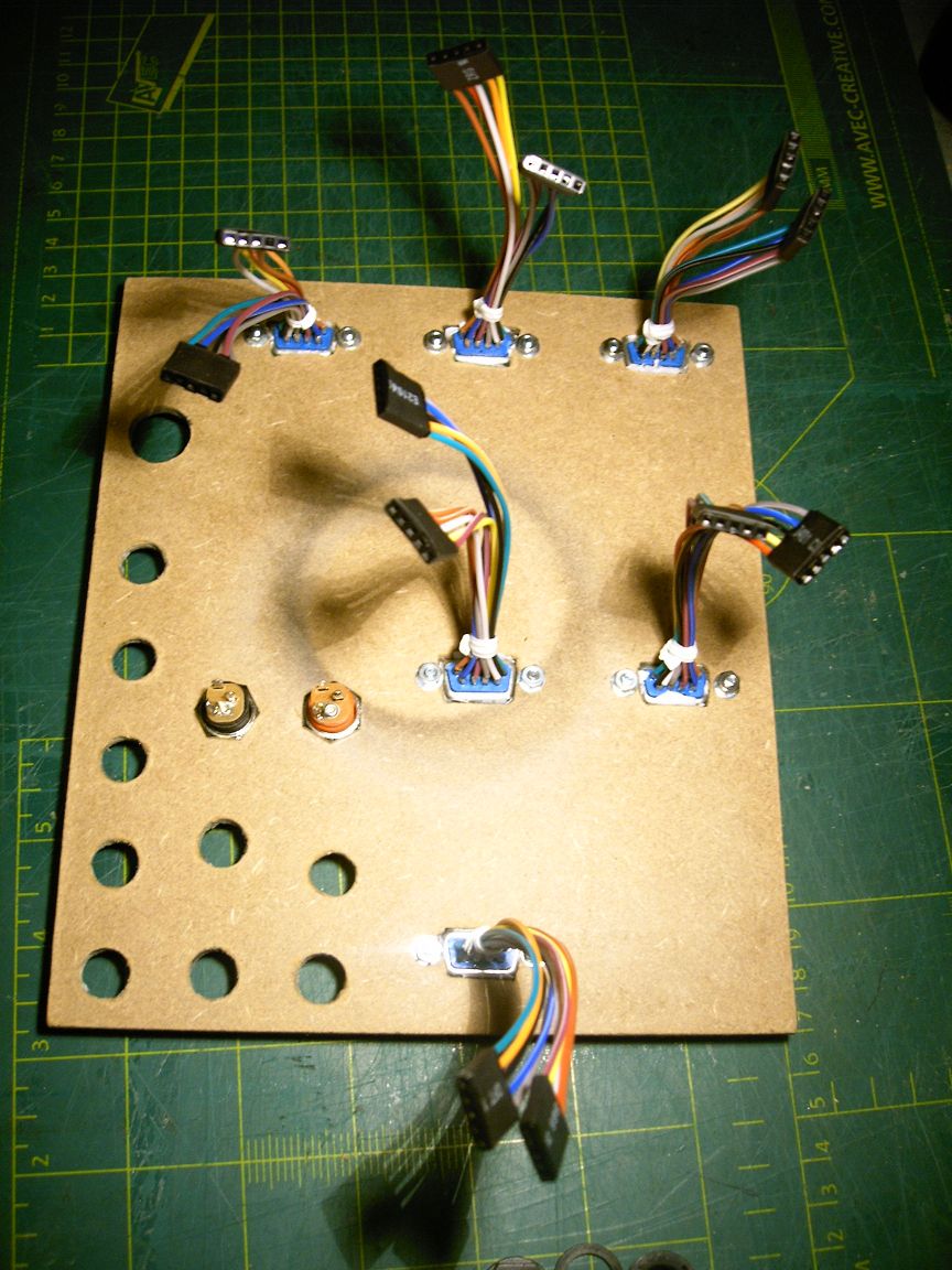

I got all the connectors so those are now installed on the panel. They are mounted on some perfboard connected to angled pin headers.
The idea is to use them together with dupont jumper cables with female connectors, which I'll cut in half and solder to Sub-D connectors.
These have to be mounted on the outside of the backpanel so this way I don't have to run wires though the panel and then solder everything up.
And if I make a mistake somewhere I don't have to desolder anything but just have to reorder the female connectors on the pin headers.

The panel is finished & mounted and so far everything seems to be working. I did run into a small problem though: The switches have some logic
chips in them which are powered by 12V (from my modular lunetta), however the outputs from my drum controller (and most of the gate outputs
from my modular) are only 5V which is too low. So I soldered up a bunch of comparators and that solved the issue. I also had to make a bunch
of cables to connect everything.
 Filesize:  164.68 KB
 Viewed:  568 Time(s)
 Filesize:  109.11 KB
 Viewed:  541 Time(s)
 Filesize:  199.65 KB
 Viewed:  618 Time(s)
 Filesize:  217.9 KB
 Viewed:  618 Time(s)
 Filesize:  198.07 KB
 Viewed:  594 Time(s)

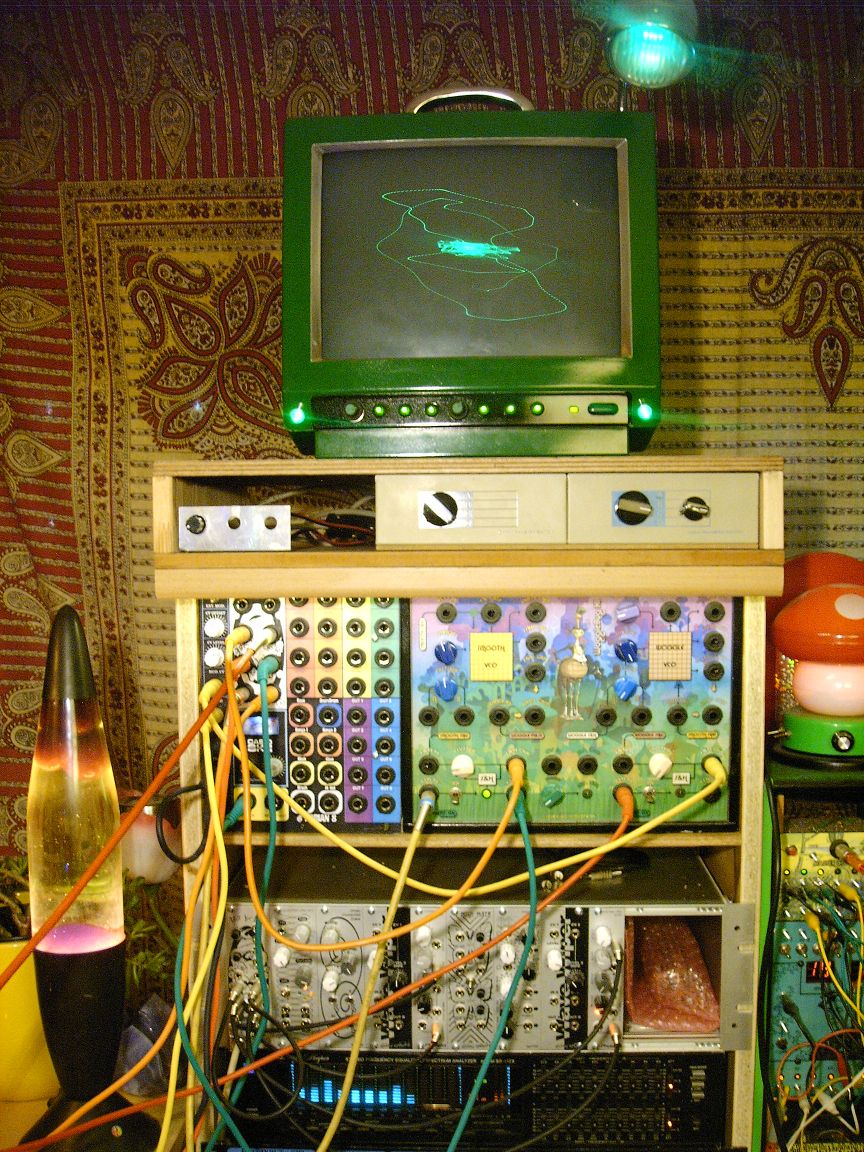

It is pretty much finished and installed Razz The bracket I used for the LED dimmer is temporary untill I know what I else I want to put in there.
I also have a free slot for a 1U rack unit but I am not sure yet what I'll use it for, I do have spring reverb that would fit. Now I need some
longer patch cables, too bad that the max size of the ones I use seem to be 90cm, 120cm would be nice. I guess I could use some couplers.
And I finally have a place for my Chromotron Very Happy
 Filesize:  214.37 KB
 Viewed:  606 Time(s)
 Filesize:  265.76 KB
 Viewed:  619 Time(s)
 Filesize:  275.34 KB
 Viewed:  602 Time(s)
