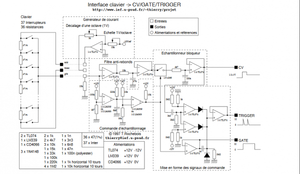

thanks chaps,
i mean i dont need pre made PCB but rather the black and white drawing of the circuit. Sorry but, how is it called in english?
I attached a Yusynth drawing for the ARP 2600 filter to give an example Smile
i have the possiblity to etch my own PCB s at home, but obviously i'd need that drawing for the 555 VCO, if it's available at all Cool Cool Cool

PostPosted: Wed Jan 11, 2017 10:33 am    Post subject: Reply with quote  Mark this post and the followings unread
There are no press-n-peel / foil layouts for this circuit that I'm aware of.

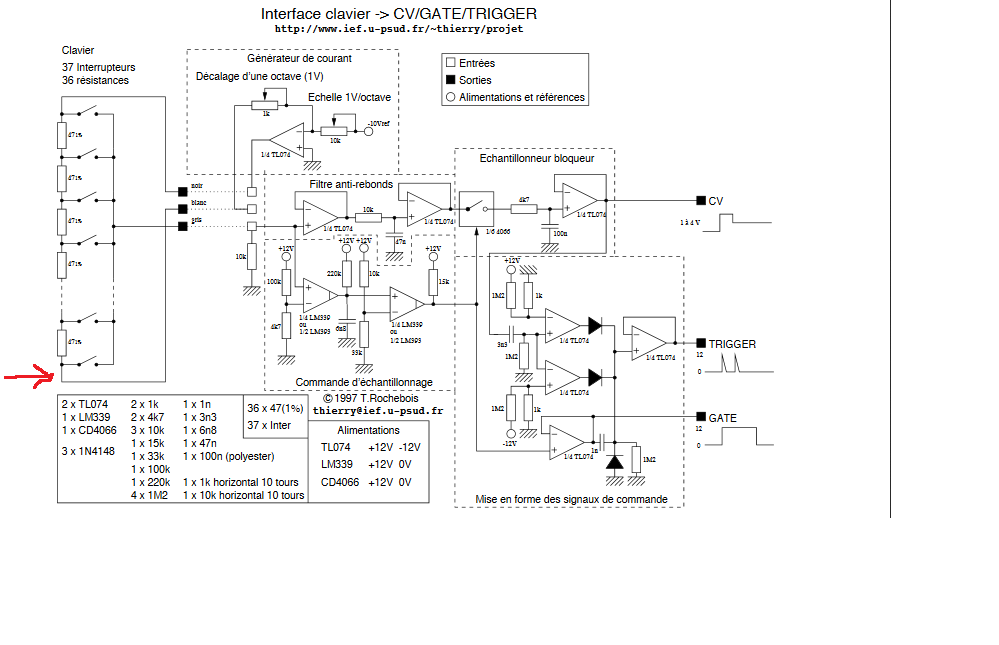

hello chaps.
this post is about 555 VCO tuning.
i am trying to tune it by ear, which is playing octaves ( e.g. C1-C2). it kind of works but if i play the entire keyboard,I dont get a equally tempered scale at all. Also, what's the CV keyboard circuit role in VCO tuning? I see in it two trimmers in the upper left section ,one of which does a lot, while the other simply sets the initial frequency (10 k and 1 k respectively)
thanks for any advice ! Smile

PostPosted: Mon Jan 16, 2017 2:59 am    Post subject: Reply with quote  Mark this post and the followings unread
be sure to have an increase of 1V per octave from the keyboard.
when tuning the VCO start with the lower octaves (1-6), using the actual scale trim of the VCO. the higher octaves will be a little bit flat. use the HF trim to iron that out.
use matched transistors for the VCO expo!

PostPosted: Mon Jan 16, 2017 3:05 am    Post subject: Reply with quote  Mark this post and the followings unread
thanks Smile
so i first set up the keyboard trimmers? then,once i get 1 V per octave output, i go on trimming the VCO . Hoping it works
PostPosted: Mon Jan 16, 2017 3:12 am    Post subject: Reply with quote  Mark this post and the followings unread
alanwilder81 wrote:
thanks Smile
absolutely. the 1V/oct is the most common standard (Hz/oct another one), and the 555VCO is made according the 1V/oct.
once your keyboard is tuned to this standard you could use it for any other analog synthesizer following this standard (i.e. a microbrute).
or you could control your 555VCO with the microbrutes CV out...

PostPosted: Mon Jan 16, 2017 5:50 am    Post subject: Reply with quote  Mark this post and the followings unread
it worked ! that keyboard only has 3 octaves,so it was fairly easy to get it a decent tuning.
i measured the voltage at the lowest resistor,pointed out with the red arrow( 0.60 V). then, i measured the voltage 12 keys (resistors) further up on the keyboard and i got 1.60 V, which is 1 V increase , right what i was expected to get, i do believe.
and i can now fine-tune it with the 555 VCO 1 V oct trimmer. Smile
