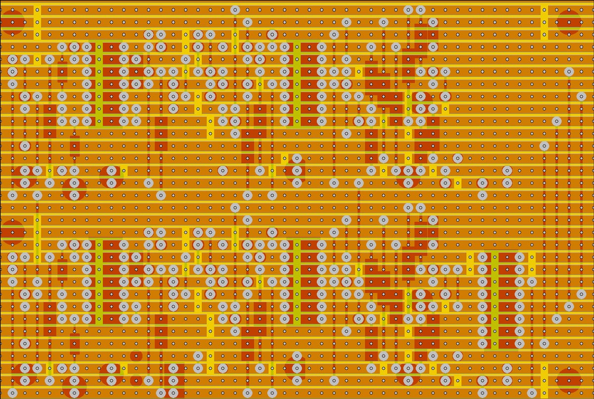

PostPosted: Mon Jun 19, 2006 6:46 am    Post subject: Reply with quote  Mark this post and the followings unread
Here's the stripboard layout. I've double checked it, but I haven't built it.
 Filesize:  293.31 KB
 Viewed:  1828 Time(s)
PostPosted: Mon Jun 19, 2006 6:47 am    Post subject: Reply with quote  Mark this post and the followings unread
And here's the copper side cutting guide.
 Filesize:  319.03 KB
 Viewed:  1501 Time(s)

PostPosted: Mon Jun 19, 2006 8:17 am    Post subject: Reply with quote  Mark this post and the followings unread
looking good!

PostPosted: Mon Jun 19, 2006 11:20 am    Post subject: Reply with quote  Mark this post and the followings unread
Hey, that´s some art! Enjoy doing that? Looks like a puzzle (to get from the circuit to that layout). And i think it´s built as quick as using a pcb!
And no cpu around Wink
What´s the thing labled ATE on the top left?

PostPosted: Mon Jun 19, 2006 11:28 am    Post subject: Reply with quote  Mark this post and the followings unread
that must be the 7805 voltage regulator.

zipzap
Joined: Nov 22, 2005
Posts: 559
Location: germany
PostPosted: Mon Jun 19, 2006 12:07 pm    Post subject: Reply with quote  Mark this post and the followings unread
I see. Never noticed in the schematic that it´s run on 5v. Could be 12 or 15 just the same i guess.
PostPosted: Mon Jun 19, 2006 12:16 pm    Post subject: Reply with quote  Mark this post and the followings unread
Yeah,
I wasn't sure why it's regulated down to 5V, but I just copied the schematic. Maybe you should try shorting it out and see what happens. I bet with a 9V battery and no regulator the envelope follower contaminates the VCO.
PostPosted: Mon Jun 19, 2006 12:22 pm    Post subject: Reply with quote  Mark this post and the followings unread
BTW,
there are 35 wire links. I always do all the cuts first. Then the IC sockets, then the links, so that by the time you get to the components which look different from each other you have plenty of 'landmarks' to guide you.
why?
your second post was quick...
I mean why contaminate?
dnny
Joined: Mar 12, 2005
Posts: 519
Location: Helsinki, Finland
PostPosted: Mon Jun 19, 2006 12:27 pm    Post subject: Reply with quote  Mark this post and the followings unread
cyclops take a good look at the schematics and you will notice it Smile
yes,you can feed the 7805 whit 12V or 15V and that's just fine. i have used it whit 9V battery.

PostPosted: Mon Jun 19, 2006 12:32 pm    Post subject: Reply with quote  Mark this post and the followings unread
post are flying in like moskitoes Smile
the original DS-7 runs on 9V battery and the schematic is cloned from it, so there must be a reason why the original has the regulator and not just the battery.
www.koelse.org
flickr: cable porn group
PostPosted: Mon Jun 19, 2006 12:34 pm    Post subject: Reply with quote  Mark this post and the followings unread
Because when C1 starts to charge you get a quick virtual short across the power which is probably too much for C20 to deal with by itself. It would only make the tone slide a bit (which it does anyway)
Well that's only a theory, you'd have to check it out with someone a bit more qualified than me to be sure. Maybe Jan or Stein.
PostPosted: Mon Jun 19, 2006 12:39 pm    Post subject: Reply with quote  Mark this post and the followings unread
Yeah,
if it's designed for a 9V battery it makes sense to have the circuit set up for 5V, then you overshoot the regulator by 4V and you have a rock solid 5V rail. More reliable.

PostPosted: Mon Jun 19, 2006 12:43 pm    Post subject: Reply with quote  Mark this post and the followings unread
The differnt parts of the schematic look to me like stuff i find in my modular, running with 12v.
The thing about the short with c1 is interesting. guess you meen c2 can´t handle. But also cabs going to ground, charging and discharging can be found often, in envs, lfos mad many other.
you guys type too quick i can´t get this posted Smile
zipzap
Posts: 559
Location: germany
PostPosted: Mon Jun 19, 2006 12:45 pm    Post subject: Reply with quote  Mark this post and the followings unread
solid 5v from battery. Sounds very reasonable.
PostPosted: Mon Jun 19, 2006 1:27 pm    Post subject: Reply with quote  Mark this post and the followings unread
It's strange that we don't go to the chat room in a situation like this. I guess the electro-music crowd just aren't much into chatting. I've been in there to see if anyone is around about a dozen times now and I've never found anyone!
BTW, No, I meant C1. I kept all the designators the same as the schematic and just made the 10uF power cap C20 for clarity. Otherwise it's the same as the PCB (which has a number of pins on the 324s different to the schem)
