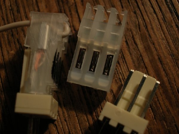

btw, matthias: can you recommend some connectors which can be put in line? i´m using the same ones you do, and it would be a shame to solder wires directly to such a nice looking board...

PostPosted: Wed Dec 26, 2007 7:01 am    Post subject: Reply with quote  Mark this post and the followings unread
just ordered a sample from rs-components. hope it works. i will let you know.

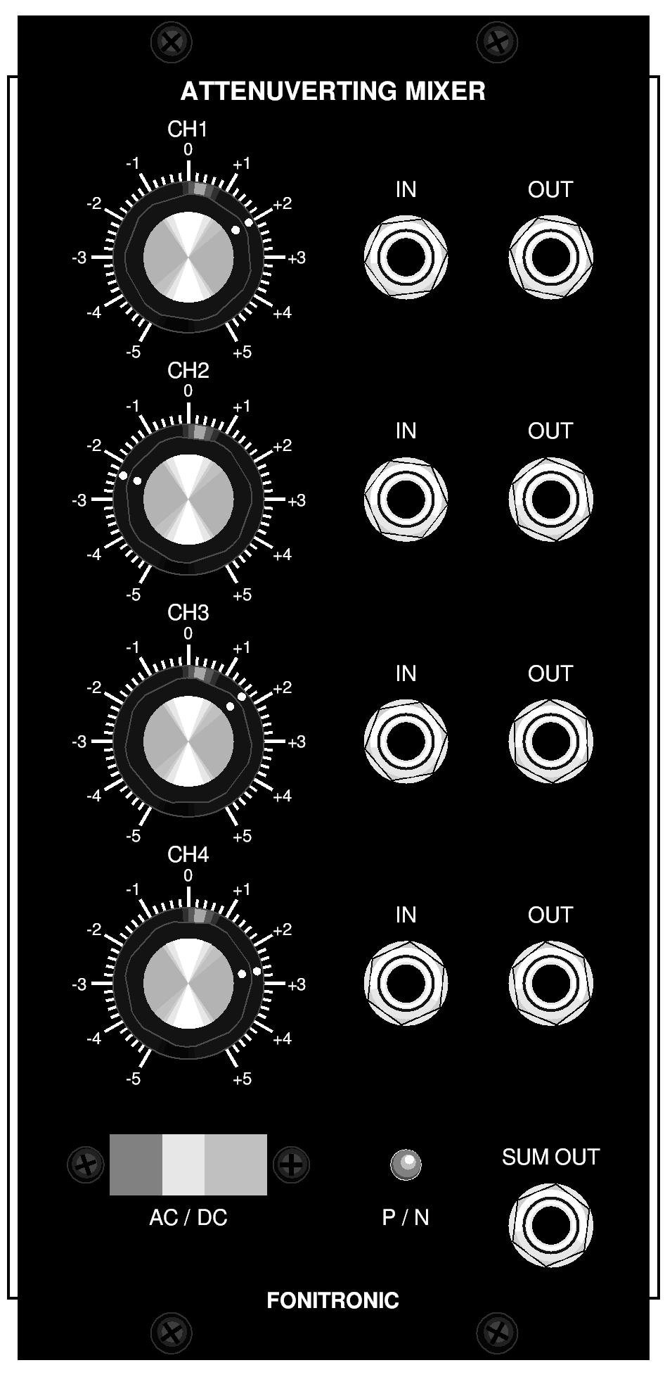

This may be a silly question (probably Wink )
Can you have five channels (as on Schematic)? rather than 4 (as on your front panel Fonik)
I'd like to use this with the Doepfer Vocoder modules you see and 5 would be better than 4,

@usine
sure you can. i guess fonik just uses 4 channels just because of space issues?
don't panic! yes, the PCB provides 5 channels, i just used four of them for my module.
there are many options to think of: i.e. one could use 4 channels for attenuvertion without the offset voltage normalled to these inputs, and then use the 5th channel just for an offset function (without the in/out sockets on the frontpanel).
YES! the samples from rs-components arrived yesterday. currently the european site os offline, so here the parts number at least (for the 3pol connector): 473-414.
these connectors are great. they can be put in line creating any number of poles. and the best thing is: you don't even need a crimp tool! just strip the end of a cord, plug the cord into the connector and bend it down... they fit on any common PCB connector header.

THE RS mta connectors, can i get the part name and company that makes these? as as RS components seems to be euro only. or do they send to us?
(maybe mouser carries them? just dont want to wade through a million parts)
thanks
PostPosted: Fri Jan 04, 2008 2:13 am    Post subject: Reply with quote  Mark this post and the followings unread
MAS-CON Series CE/CT by ITW Pancon.

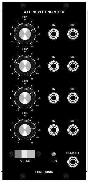

Some design "idea" for a dotcom type panel:

hey, that looks nice!
i think i will take a look at these bi-color LEDs, too. Very Happy

Very Nice design Jan!
Are you gonna do a some panel runs in dotcom format?
I am interested in the Wogglebug and Mixer panels!
