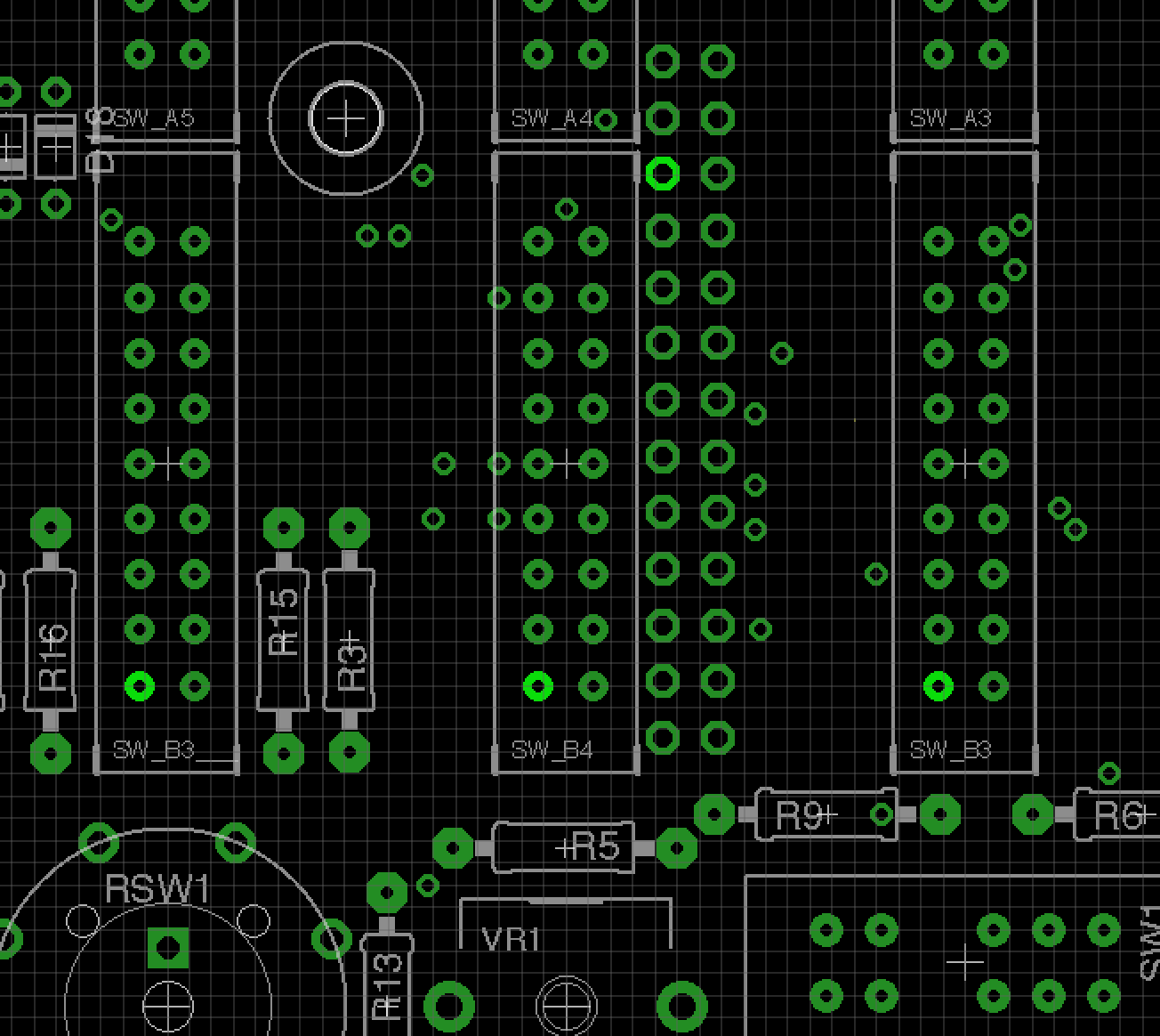

PostPosted: Fri Jun 05, 2020 4:49 am    Post subject: Build Issue - 5V shorted to GND Reply with quote  Mark this post and the followings unread
Hi Ryk,
after just finishing building it seems to work fine for just a few seconds, then it looks as if it crashes (LEDs disappear or some become static).
I presume I've probably got a short somewhere on the 5V line as the through hole regulator gets rather warm in that short time frame.
I'd appreciate if you've got any other ideas other than tripple checking all joints and removing any flux remains.
EDIT:
After some time of flux removal and checking all joints I still don't seem to find any issue there.
I checked the static resistance between the regulator out and gnd and appears to be around 15ohms (I think, would have to check again).
When powering the voltage drops from 5v over a few seconds whilst I presume the regulator is current limiting.
Robert

PostPosted: Sat Jun 06, 2020 1:49 am    Post subject: Re: Build Issue - 5V shorted to GND Reply with quote  Mark this post and the followings unread
nativeVS wrote:
Hi Ryk,
EDIT:
Robert
Hello
Sorry to hear you are having problems with the build.
Regarding the THT regulator.
The voltage should not drop significantly on power up.
Usually reads around 4.9V
I have measured the regulator resistance on working unit, and it reads around 3k.
So perhaps there is some kind of short within the unit.
Can you try a reading with the Main PCB disconetec from the Panel PCB, this
might tell where there fault is.
ryk

PostPosted: Sat Jun 06, 2020 5:03 am    Post subject: Re: Build Issue - 5V shorted to GND Reply with quote  Mark this post and the followings unread
Hi Ryk,
I'm getting 14.6 ohm output to gnd at the moment; I'll check it out of circuit in a moment and see whether it might be the culprit.
EDIT:
14.7 on the board between gnd and +5, yikes.
Robert

PostPosted: Sun Jun 07, 2020 5:14 am    Post subject: Re: Build Issue - 5V shorted to GND Reply with quote  Mark this post and the followings unread
nativeVS wrote:
Hi Ryk,
EDIT:
Robert
Sounds like some kind of short somewhere.
Maybe check the electrolytic caps are the right way around.
Perhaps check without the PIC installed, or any other chips if they are socketed.

PostPosted: Sun Jun 07, 2020 5:25 am    Post subject: Reply with quote  Mark this post and the followings unread
Getting as low as 14.4 across the shift register, so that one's next up.
EDIT:
Definitely the shift register; seems like I might have been overly keen when installing that...

PostPosted: Sun Jun 07, 2020 8:31 am    Post subject: Reply with quote  Mark this post and the followings unread
Wonderful job on this module Ryk. Your instructions are very clear and easy to understand and the panel is beautiful.
After getting it all assembled and doing the calibration procedure I started the hardware test mode per the manual. Everything on my module is working except the second step gate length switch. I've checked the joints on the switch itself, along with the headers between modules and the ICs on the main board but have had zero luck since last night getting any response from that switch.
Could you offer any insight as to where I might check next as I'm not seeing any obvious bad joints or shorts on either of the boards Sad

PostPosted: Mon Jun 08, 2020 5:30 am    Post subject: Reply with quote  Mark this post and the followings unread
Hello
Thanks for buying the kit.
Sorry to hear you have a problem with Stage 2.
Is it just the Gate Mode for Stage 2.
For the gate switch problem, can you check the polarity of D21.
This diode supplies the swithc with 5V.
If the diode looks ok, please try measuring the DC voltage [to gnd ] on D21.
When Stage 2 is selected [ using NTX/PRV blue buttons ] you should see
4.9-5V on both ends of this diode.

Sorry, I didn't use the correct terminology. The switch that gets no response is the Stage 2 Stage Count Control switch. The Gate Mode switch behaves as expected.

PostPosted: Mon Jun 08, 2020 2:23 pm    Post subject: Reply with quote  Mark this post and the followings unread
Hello
No worries.
The diode to look at is D22, please check as previously described.
If the readings are 4.9-5v then please check carefully the soldering of
SW-A6 [ the Stage 2 Count control ]. Especially the bottom right corner pin
when the board is flipped over.
Sorry I havent had time to grab a pcb photo.

I assume you have set the Sequence switch to '?' to select the Gate Mode switches.
If so then please check the soldering of the highlighted pin header on the Panel PCB in the atatched photo. [ viewed from component side of Panel PCB ]
This takes the voltage from all the Gate Mode switches to the Main PCB. You should also check for continuity from this pin to the Main PCB.
ryk
