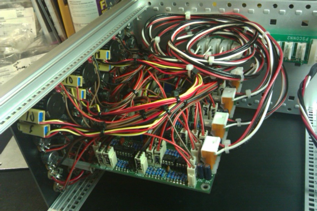

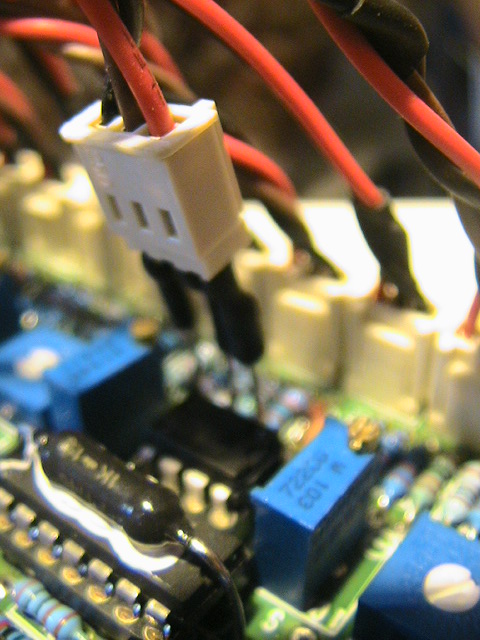

PostPosted: Sat Dec 12, 2009 4:51 am    Post subject: Reply with quote  Mark this post and the followings unread
here are fotos of how i wired the fine tune ---> i solder a 3-pin header directly to the ICs.
Thatway i have the whole Board disconnectable whta is a good thing.

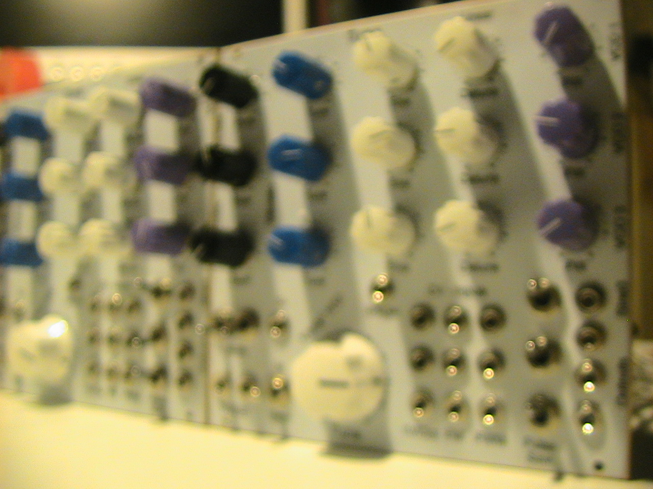

my camera is fucked up, shots from short work now ( in the past they didn't ) but modules i get very blurry.
header for finetune wiring attached to the IC
 Filesize:  102.11 KB
 Viewed:  336 Time(s)
 Filesize:  118.03 KB
 Viewed:  325 Time(s)
two JH living VCOs in euroformat. sorry is blurry

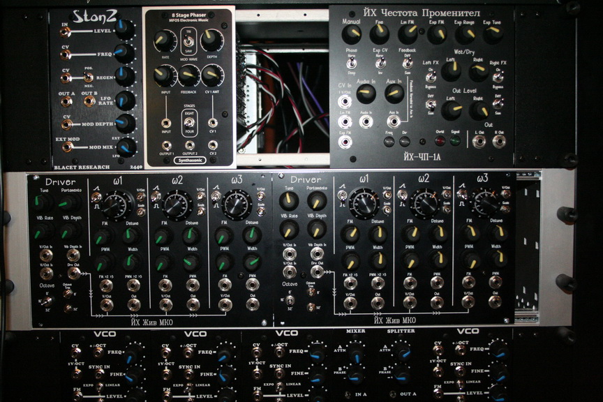

PostPosted: Fri Jan 01, 2010 7:17 pm    Post subject: All done! Reply with quote  Mark this post and the followings unread
WoooHooo!
Got the second one finished and it fired right up. I'll post photos later.
Thanks JH, and Happy New Year to everyone!
[EDIT]
OK, here's a photo of the pair racked up. You see my Frac Frequency shifter above to the right and a spot for a TAU Phaser above it which will be my next project.
There are also some Blacet VCO's, Phaser, Mixer, and Splitter shown, as well as a Synthasonic produced MFOS Phaser.
I must say the Living VCO's calibrated easier than any other VCO I've tuned.
David
