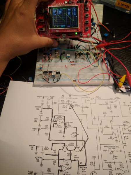

Sorry for spamming with updates, but I'm so happy I'm finally getting results. So I got a separate expo working using just the drawn out parts:
Triangle and ramp working great, now onto sine! Or maybe revisit the first expo first so I can fit it on one breadboard Smile

First expo working again, it was a fried Q3 Smile
Noticed now when pulling and putting back the transistor (Q3) that they give a whole lot higher frequencies when cold and slowly going down in pitch when I'm at lower frequencies. However, when I'm at high pitch, pitch actually goes up initially and turns back down after a while... Also big diff between different units.
Guess I need to learn about transistor matching and tempco now Smile I have a bag with 100 3906's so… Just using hFe measure on cheap multimeter is no use at all, is it?

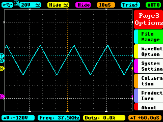

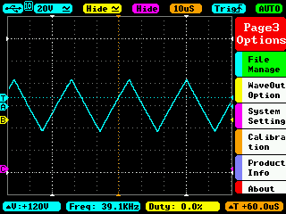

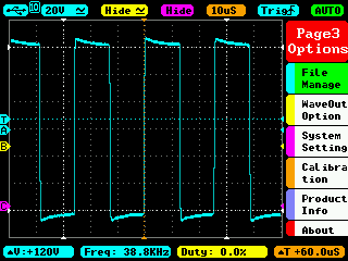

PostPosted: Sat Feb 17, 2018 6:35 am    Post subject: VCO-555 high-frequency troubleshooting Reply with quote  Mark this post and the followings unread
With an oscilloscope, I can see waveforms generated for my VCO-555 at outputs, so I know the core is oscillating. However, I wasn't getting any sound at all.
It turns out that the output has a really high frequency, around 38kHz, therefore putting it out of audio-band!
How can I diagnose and fix this? Scope and DVM are at hand as well as the schematics and layout.
It can probably still be useful for scaring away any stray dogs but I really would like to use it as a normal audio VCO to integrate in a DIY Modular. Cool

Had to temporarily patch my Coarse Pin 1 as indicated on the layout to the bottom of resistor R46 to get at my -12V again (I'm using -12V, +12V so did the required changes for that).
Here's what I found so far:
1. The waveforms only show when the middle pin of the Coarse Pot crosses above point between -1.4V and 0.7V approximately, and then the frequency remains fixed at around 38kHz and 39kHz approx. So not exactly out-of-audio band, but high enough that I can't hear it directly. Below that threshold, no waveforms appear at all.
2. If I use my DVM and put it on DC measurement, I do get audio out of the Pulse out when I touch the +ve probe of the DVM to the LM13700 Pin 1.
elmegil wrote:
is C4 the right value?
Not sure anymore: it's a yellow-bead type, really small with the marking NC 222 on it. I can't remember if I swapped this in last time, about two years ago. Memory is a bit hazy here but I do think I had another cap at one point and it somehow was damaged, so that could be a problem.
On the upper pin of this yellow-bead cap, I do see a triangular waveform (that's looking at the layout as Fonik posted in the forums). The lower pin, however, shows nothing on the scope.

That's really weird because they should be shorted. You sure you were measuring p8 correctly? And there's no way you should be seeing a triangle at P9 if P8 weren't connected....
Power off the circuit and check continuity from 8 to 9 as well.
YashN wrote:
are the resistors connecting to IC2a the right values?
Yes, I believe these are all OK and in fact this applies to all resistors as well. I haven't re-checked yet so I removed those points below.
Is IC2 healthy? If you used sockets, try swapping it out.
Socketed everywhere, so a swap is easy. I may be out of LM13700 for now though or I just can't find them - one disadvantage of too many projects and too many boxes currently.
Are the transistors themselves or the op amps themselves OK?
Haven't checked these but I have brand new op amps that I can swap.
Is there something causing the sync input going to pin 4 of the 555 to be held low? Measure for shorts, or observe pin 4 with a scope.
I checked it with the scope, it appears to show a +ve voltage here so I think we're good.
Ok, that sounds right, I wouldn't worry there then.
YashN wrote:
I do have brand new 555 of the proper type for the VCO as well so a swap is possible.
If you're seeing a triangle at C4/IC3 pin 9, odds are the 555 is fine.
YashN wrote:
Edited this as well:
So, it looks to me that the opamp IC3 could be an issue?
Not certain.....

elmegil wrote:
ok, 222 is the right VALUE, that'll be a 2200pF cap. "yellow bead" sounds like it's a ceramic axial though, you need a good film cap here.
The lower pin is GROUND Very Happy
Yes, of course for ground Very Happy
OK, since I do get the triangle output from the cap, I am going to assume this is good for now.
elmegil wrote:
So that's promising. What's the frequency of that triangular wave? Same as the output you're getting, ridiculous speed?
Yes, it does appear to be exactly that: everything is at 38-40kHz, at least when I go past the threshold on the Coarse Pot. Below that threshold, I get nothing.
Definitely sounds like I inadventently moved my Coarse Pot in between readings: that would explain why I3P8 then gave me nothing.
From newer measurements, it looks like they're all connected properly. I will try to include the BMP from my small scope below. It's also a DSO, so that came in handy actually. I am liking it so far - portable enough for my Modular DIY builds.
Attached: 555 Pins 2, 3, 6, 7 + C4

PostPosted: Sun Feb 18, 2018 12:33 pm    Post subject: Reply with quote  Mark this post and the followings unread
So let's talk our way through control voltages.
wiper of the coarse pot should swing from -15V to +15V
Set the exp FM pot all the way CCW and the fine pot as close to center as you reasonably can (you could measure it at the wiper and make sure it was 0V).
Set the linear FM pot all the way CCW as well.
IC3a pin 1 should output something close to -.02 x the voltage at the coarse pot's wiper -- for example if the wiper is set at 10V, the output of the op amp should be -.2V
The output of the wiper of the 100R V/Oct trimmer (connects to base of Q3) should be a little bit less, somewhere above .16V when the coarse pot is at 10V.
When you change the coarse pot, these should all move in the direction you expect.
Verify all that looks right and then we can move on....
