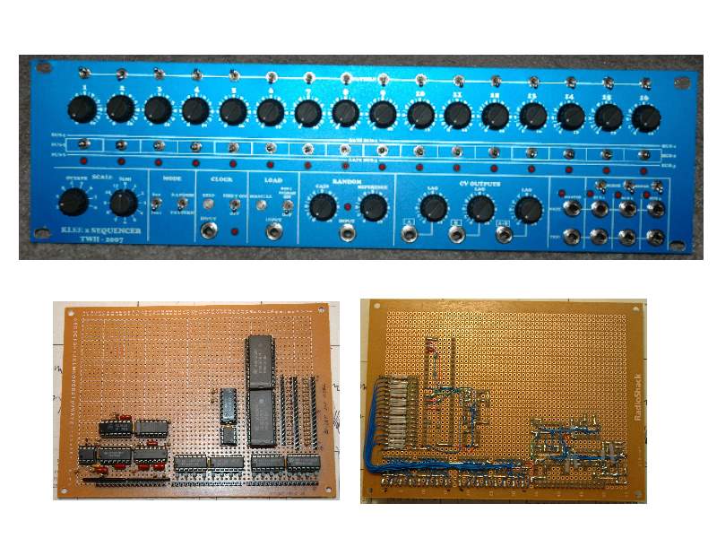

PostPosted: Mon Aug 20, 2007 11:19 pm    Post subject: THE KLEE IS ALIVE!!! Reply with quote  Mark this post and the followings unread
Hi Scott,
The Klee is about 98% functional. The scaling and voltage output sections are not right and I traced it to an error on the schematics. I should have seen this while wiring but I guess the background music was too loud! Anyway pin 12 and 13 on all of the TL074 opamps is incorrect. Pin 13 is the neg input and is shown as 12. This had me scratching my head until I said wait a minute the neg input and output pins are always next to each other. I have not fixed this yet but I know this will resolve most of my issues. I am also getting intermittent key bounce on the load and clock switches. I will probably just have to tweak the time constants in those circuits. Scott your design is awesome!
Tim
Not pretty but functional...

THeff
Joined: Sep 01, 2006
Posts: 229
Location: Florida
Audio files: 33

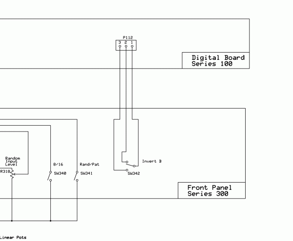

PostPosted: Mon Aug 20, 2007 11:34 pm    Post subject: Invert B switch mod. Reply with quote  Mark this post and the followings unread
Scott, I forgot to mention that I would be interested in the details of the Invert B modification, once I get all the details corrected here.
Kleefully,
Tim

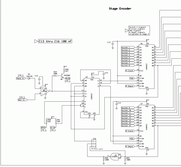

PostPosted: Tue Aug 21, 2007 9:09 am    Post subject: Reply with quote  Mark this post and the followings unread
Hey Tim,
Embarassed Sorry about that - that was one thing we had to shake out of the schematics when Andy was doing the PCB. In the original, I had to manipulate the symbols a bit in Express PCB, and screwed up the pin numbers. At the time, I never got back to rev the posted schematics. I'll fix that before they're re-uploaded.
How often does this happen? That's something we'll need to nail down in the protobuild if we encounter it. I don't get any intermittency on the breadboard testing "worst case" switch selection (anything from knocking two wires together to a raspy foothswitch). But between breadboard and actual panel mounted stuff there could be a difference. What type of capacitors did you use there (mylar, ceramic)? I'll be interested to know what values you arrive at.
That's some serious work you've put into that build! Amazing, indeed!
Here are the portions from the EM Klee schematics that cover Invert B function. We just put the unused section of U4 to work. The switch either takes the output of the inverter or bypasses the inverter.
Did you build a Dim C?
Scott
