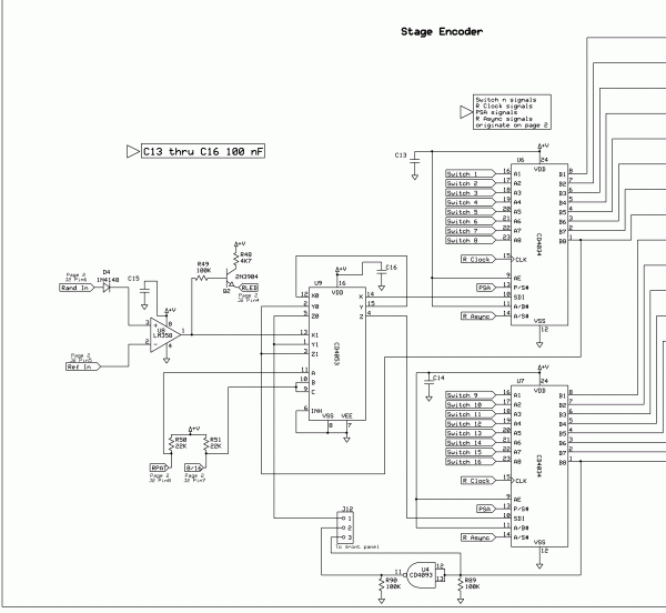

PostPosted: Fri Aug 17, 2007 9:42 am    Post subject: Reply with quote  Mark this post and the followings unread
hi Scott,
I have not committed to the mutiplexer idea yet, but I am going to at least run the shift register outputs to a pin header and the bus to another pin header. The header will also include GND, +15V, and Clock so that I can still use the Klee single-step, and clock in from the front panel. I can then just manually connect the Klee or some other sequence driver. After noticing that the common section on all sequencers is the 8-32 pots, gate switches, and step LEDs, and growing a little weary of wiring these, I decided to go with a universal approach this time. I have attached a low res picture of my progress thus far. My forum and typing skills are very marginal so hopefully the attachment works right. I have been lurking in the shadows quietly building stuff and reading the forums and I thought it was time to participate. I owe you thanks as well for encouraging me to build a Dim-C and other things from your great web sights!
Tim

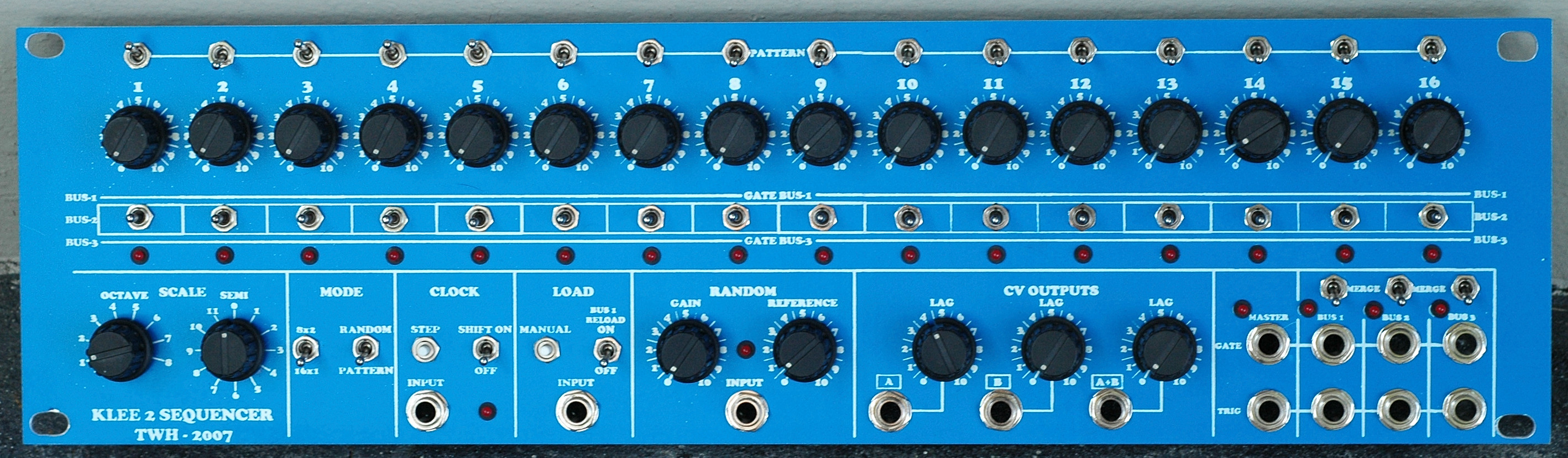

PostPosted: Fri Aug 17, 2007 2:13 pm    Post subject: Reply with quote  Mark this post and the followings unread
Thanks for the compliments on the front panel.
I have attached a better picture and an AutoCad .dwg file if anyone wants it. I actually used Turbocad for the design but figured the .dwg would be easier for everyone to view. The breadboard is about 75% complete and I have tested each section as it was finished. The only snag so far was that I was not paying attention and connected -15V to pin 4 of the U1 LM358 opamp instead of GND and it made the CMOS gates on it's ouptuts very unhappy! Once that was corrected the clock and load sections performed as expected. If all goes well I should have basic functionality this weekend.

PostPosted: Fri Aug 17, 2007 2:28 pm    Post subject: Reply with quote  Mark this post and the followings unread
That is really sweet. How did you color it and do the graphics, etc?

PostPosted: Sat Aug 18, 2007 5:18 am    Post subject: Reply with quote  Mark this post and the followings unread
Thanks guys! I used ID-Mark for the front panel graphics. It is .007" aluminum, that is photo sensitized for positive artwork and self adhesive. It comes in 12"x20" sheets and in different colors. I have used the black and the blue. I create the artwork with overhead transparencies in a laser printer. The exposure requires UV light and 2' fluorescent lights from Home Depot work well. To develop it after exposure you use water believe it or not. It's a little tricky to figure out at first but I have done over 40 3.5" x 9" modules for my synth using ID-Mark in black.
Here's the link:
http://www.horizonsisg.com/products/idmark.asp
Oh, the cost is $126.00 for 5ea. 12"x20" sheets. I think it works out to be about $4 for a "3.5 x 9" panel. The stock number is 8700 for black and 8705 for blue. They have a PDF price list showing all of the details on their web sight. I can send a picture of the synth showing these panels if anyone wants. BTW does anyone know why I could not attach the .dwg drawing file to my last post?

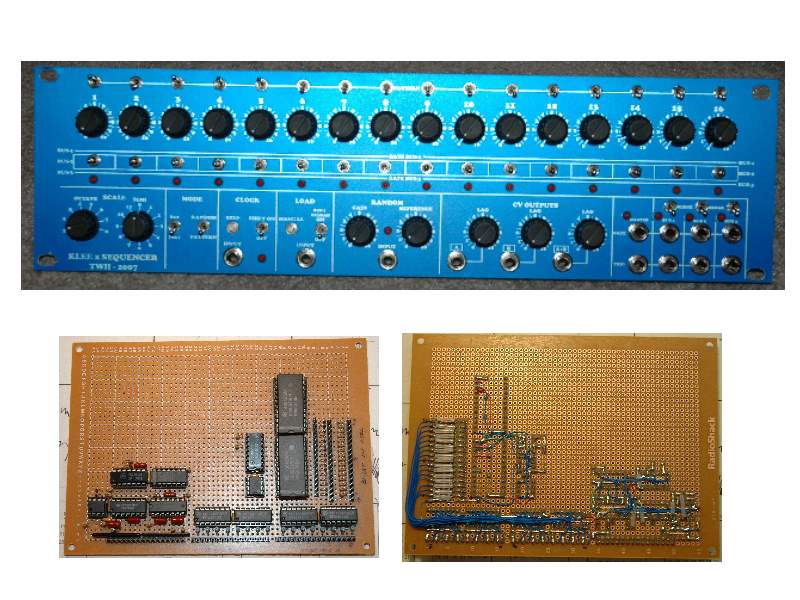

PostPosted: Mon Aug 20, 2007 11:19 pm    Post subject: THE KLEE IS ALIVE!!! Reply with quote  Mark this post and the followings unread
Hi Scott,
The Klee is about 98% functional. The scaling and voltage output sections are not right and I traced it to an error on the schematics. I should have seen this while wiring but I guess the background music was too loud! Anyway pin 12 and 13 on all of the TL074 opamps is incorrect. Pin 13 is the neg input and is shown as 12. This had me scratching my head until I said wait a minute the neg input and output pins are always next to each other. I have not fixed this yet but I know this will resolve most of my issues. I am also getting intermittent key bounce on the load and clock switches. I will probably just have to tweak the time constants in those circuits. Scott your design is awesome!
Tim

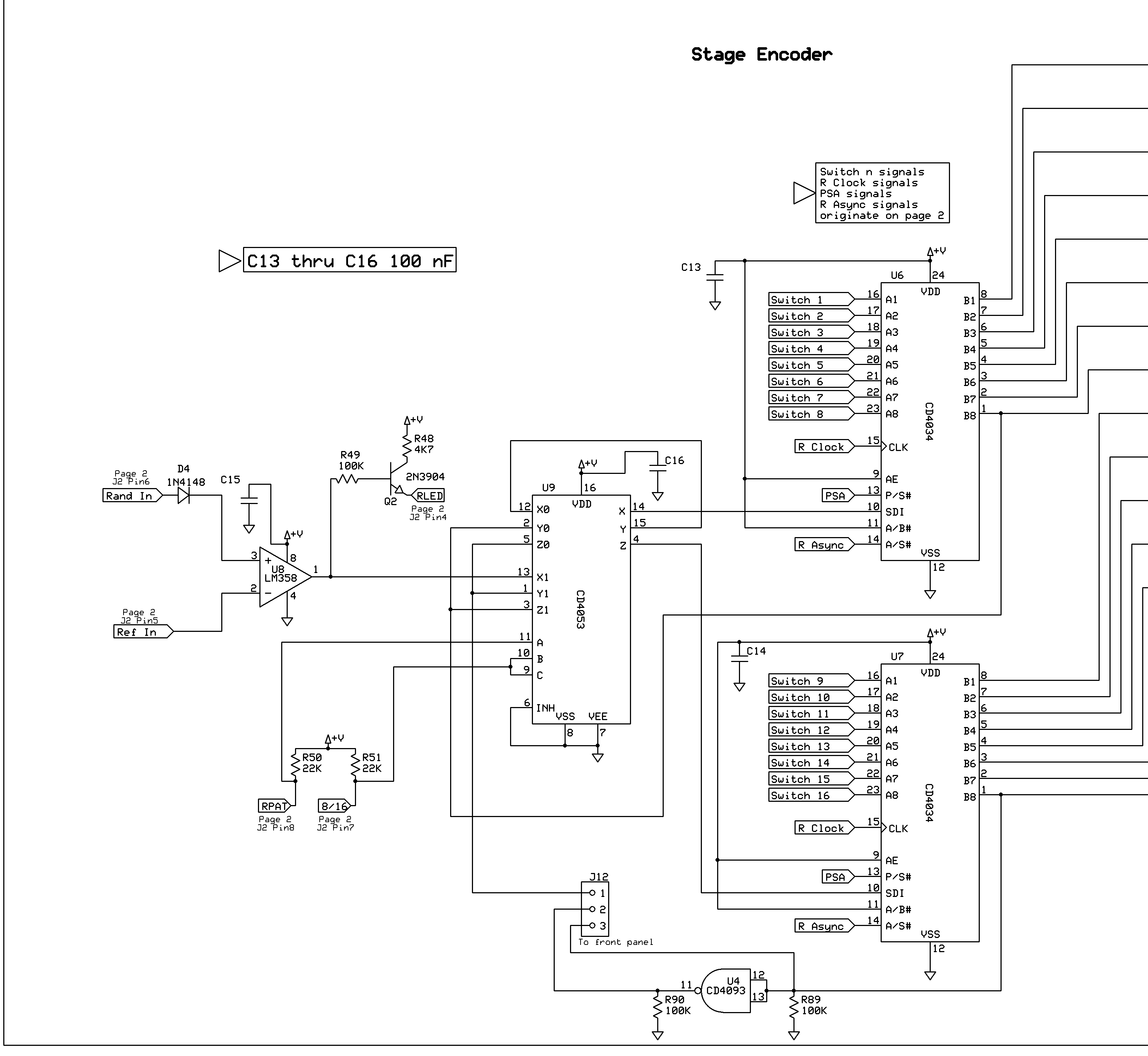

Hey Tim,
Embarassed Sorry about that - that was one thing we had to shake out of the schematics when Andy was doing the PCB. In the original, I had to manipulate the symbols a bit in Express PCB, and screwed up the pin numbers. At the time, I never got back to rev the posted schematics. I'll fix that before they're re-uploaded.
How often does this happen? That's something we'll need to nail down in the protobuild if we encounter it. I don't get any intermittency on the breadboard testing "worst case" switch selection (anything from knocking two wires together to a raspy foothswitch). But between breadboard and actual panel mounted stuff there could be a difference. What type of capacitors did you use there (mylar, ceramic)? I'll be interested to know what values you arrive at.
That's some serious work you've put into that build! Amazing, indeed!
Here are the portions from the EM Klee schematics that cover Invert B function. We just put the unused section of U4 to work. The switch either takes the output of the inverter or bypasses the inverter.
