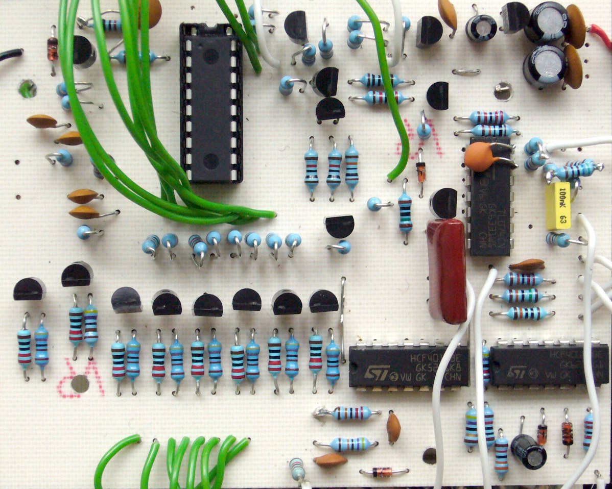

I have been making some new Roland 100m Modules, as they
have been discontinued for a while !
Here is a link to a new sequencer I have been working on
http://www.flickr.com/photos/ryktnk/sets/72157604609909924/
and a video !
http://www.youtube.com/watch?v=vK1PoQffhjk
It has step repeat switches:- [1-8] and gate mode switches:-
[off/single/repeat/long] for each stage, plus random & pingpong mode.
It is based around a PIC, so is software update-able.
I am thinking of making a run of boards for the controller PCB
if anyone is interested . . . ?
-ryktnk

PostPosted: Sat Jun 21, 2008 11:23 am    Post subject: Reply with quote  Mark this post and the followings unread
Hello
Thanks for the comments.
I am thinking of producing the main pcb.
[see attached photo of prototype]
This has all the logic circuity for the sequencer plus clock
and portamento etc.
The large panel on the with the panel components, will not
be too useful as it is formated for Roland 100m
modules, and contains a few obscure components.
So to make it work you will have to hand wire all the
pots, leds, switches etc.
-ryktnk

Price for the boards and PICs I will work out, depending on
how many to make, and post back next week hopefully.
Does anybody have strong opinions about the fixing holes ?
At the moment they are M3 sized, positioned fairly arbitrarily
due to position with Roland 100m pot-panel.
Board size is about 105x80mm.
Top two fixing holes are 72mm apart, along long side.
Bottom two fixing holes re 63.5mm apart, along long side.
-ryktnk

PostPosted: Sun Jun 22, 2008 6:54 am    Post subject: Reply with quote  Mark this post and the followings unread
Hi Ryk,
I saw this on the System 100M forum I believe. Thanks for making the project available, great work. I would like 4 sets of boards and pics.
I would recommend you put the mounting holes at the corners and if you have enough space, you could put extra holes at 4 edge centers so it gives extra options just in case someone is space challenged via the flying leads or their front panel layout. Also helpful might be to put mta.100 headers for the wires a la EM Klee. This will be good a source for clocking The Em Klee.
Sorry for asking , but here goes. Any possibility of voltage controlled stage addressing?
Regards,
Ringer

Regarding the connectors, the 8way for the LEDs and Pots are 2.54mm
spacing so should work with MTA100 or similar kind of connector.
Screw holes, they will probably stay where they are, sorry.
Ringer:-
About the voltage controlled stage, mmm
That could be possible, but would require sacrificing another feature, which
would probably be the max-stage setting; as there are no more free inputs on the PIC, and adding another socket.
The stage change to a new stage would still be dependent on the clock
pulses and the amount of step repeats on the current stage, but would
jump to an arbitrary stage set by the CV, is this what you mean ?
Floppy:-
would it be possible to add note quantize via the software ?
No as the CV's dont go through the PIC, they are just plain analogue.
-ryktnk

Quote
Hi Rick,
Yes basically, you have an input jack that samples the incoming voltage and an ADC converts it to a binary number which sets the counter to the appropriate stage. Once the incoming voltage goes past a voltage threshold, the addressing follows the voltage at the input jack.
Most systems have 0 to 5 volts or 0 to 10 volts ranges, so an option to configure the input for both would be very useful. It is a powerful feature, maybe the random switch could be switched for this feature. You could then use noise to have the random effect or other types of voltages to control the sequencer.
Here is a pdf to explain it better,
http://www.buzzclick-music.com/Milton_owners.pdf
Hopefully, it is possible without sacrificing other features, thanks.
Regards,
Ringer

PostPosted: Sun Jun 22, 2008 3:38 pm    Post subject: Reply with quote  Mark this post and the followings unread
Hello
Thanks. Tim
I was inspired by watching a Youtube clip of the excellent
YMO in the studio circa 1979, where they demonstrated
the Moog sequencer on their track Rydeen.
Which used the step repeat function.
I went to China last year, and found some pretty obscure
8way switches, so I thought this would be a good use for them.
8 pitch steps can, if used carefully, make
pretty good 4 bar bass lines, by changing the length between
notes, and repeating some notes.
I was too lazy to use a decoder, so the PIC outputs BCD, which
is quite a waste of IO pins, but it keeps the board size small [no decoder chips]
It does have a random step mode, if that's what you mean.
I keep wanting to add more features, but end up with having
to use "soft-selection" for modes, rather than nice big switches, which
is a shame . . .
-ryktnk
