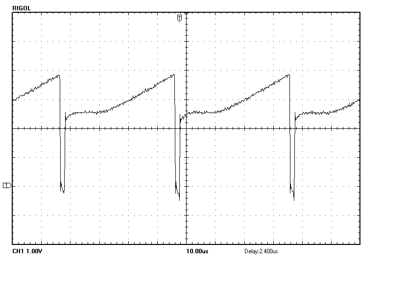

PostPosted: Sun Jun 28, 2009 3:26 am    Post subject: Reply with quote  Mark this post and the followings unread
Hey everyone,
I've finally finished my ASM-2 board and have been doing some testing of the VCO's.
As per Laurie's instructions I've been testing with no voltage connections and leaving the wire link out.
Good news is - it oscillates. The strange thing is, after looking at the output on a scope, the frequency is up around 25khz - adjusting P101(P151) doesn't seem to shift it much. The waveform on the output of the CA3140 looks a little strange too (attached). It seems the cap is being discharged when the comparator kicks in, but then immediately jumps to 2.5V or so before ramping up.
Both VCO circuits seem to be doing this as well.
Does anyone have any ideas or have seen something similar?

PostPosted: Sun Jun 28, 2009 4:47 am    Post subject: Reply with quote  Mark this post and the followings unread
My VCOs are actually running really well now, but I did have an early incarnation of the PCB which needed a little kludging and newer sync circuits added.
I don't think I looked specifically at the 3140 outputs, but I did scan the whole circuit compared to my original schem and found a few anomalies.
Make sure you have the latest schem (I'll attach it here)
I've got pretty good waveforms on all outputs now, so I'd say you need to start double checking everything. Get out the highlighter! Smile

PostPosted: Tue Jul 07, 2009 8:59 am    Post subject: Reply with quote  Mark this post and the followings unread
Got the VCO's sorted !! Very Happy
Turns out the JFETs were at fault - I replaced them with J111's I had sitting in an unused project and all is well - oscillating at an (now audible) 880Hz Smile
These J111's were Fairchild branded , whereas the J108's I had were from Futurlec and without an obvious manufacturer. A warning to others perhaps? Confused
Quite annoying, but I guess in the whole process of debugging this circuit I now understand he VCO design!
Thanks Uncle Krunkus for the PDFs - I think Laurie has updated them again on his website since - I think very minor changes though
Good news, I saw your oscillograph and was interested what the outcome would be.
Good warning. Something to be aware of when purchasing components. When selling components for the Klee sequencer, it turned out I had a mess of shift register chips that I sold and ended up bad. They were some obscure brand of chip from India and they were manufactured back in like 1984 or something. I replaced many in the field and used all Motorola or TI chips without any more incidents.
Names to trust you ask (not complete of course and just my opinion):

PostPosted: Mon Feb 21, 2011 12:53 am    Post subject: ASM-2 VCO Tracking Reply with quote  Mark this post and the followings unread
This is my first post. I just finished my ASM-2 and following the calibration procedure in the ASM-2 manual the VCOs only track over 4-5 octaves in the low frequency range. A few questions:
What should my expectations be for the VCO tracking?
Is there an alternative procedure that might give better results?
Are there any modifications or part substitutions that can improve the VCO's v/oct performance?
Why did the ASM-2 use a 1.5M resistor in the current mirror as opposed to the ASM-1's 150K?
Does it make sense to add high frequency compensation to the design?
I have already changed the resistor value in sawtooth level shifter to get the sawtooth centered about +-5V.
I bought the MAT-02 and tempco from Laurie. I got the rest of the parts from Futurlec. Should I rebuy some of the critical parts from Mouser or Digikey just in case?
