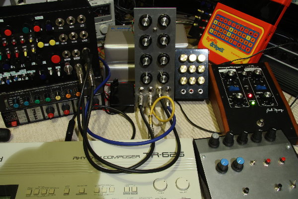

Yesterday I added a ring mod to my ring mod:
I also moved my Arduino module prototype off of the breadboard and onto a protoboard:
Posted Image, might have been reduced in size. Click Image to view fullscreen. Posted Image, might have been reduced in size. Click Image to view fullscreen.

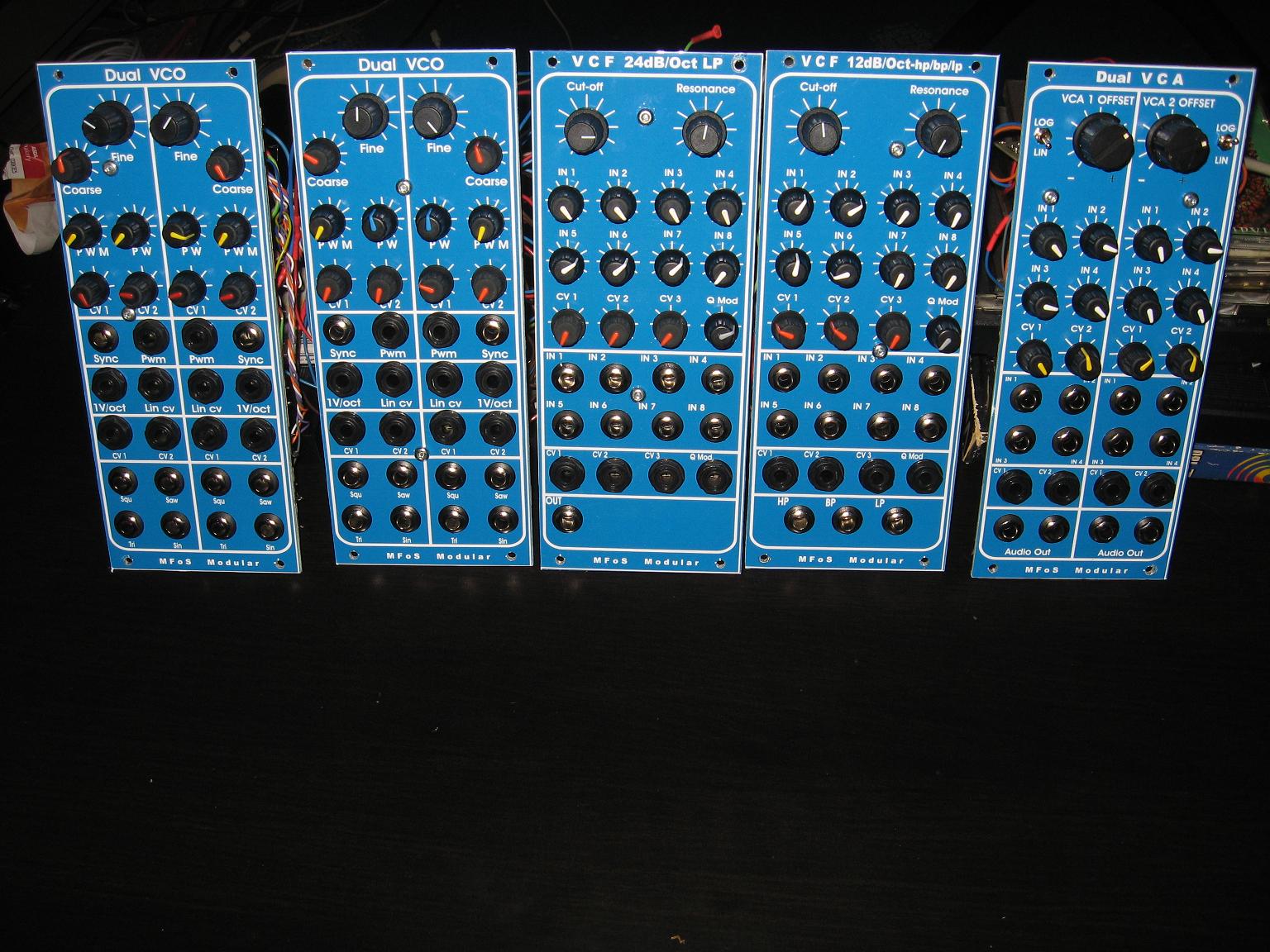

Finished some long awaited mods to some older MFOS modules.
fit 2 vco's to one module plate ( my standard is 100mm X 250mm / 4" X 10" ) also adding a pwm attenuator pot.
add an 8ch mixer to 24dB & 12dB Vcf's.
add a 4ch mixer per Vca & extra output.
Still to do.....
Quad bass++
2 more MFOS vco's
CGS digi noise
yusynth diode vcf
another mfos 12dB vcf
2 mfos ADSR
yusynth saw animator
CGS anlg switch matrix
yusynth CV standards
mfos vc-lfo

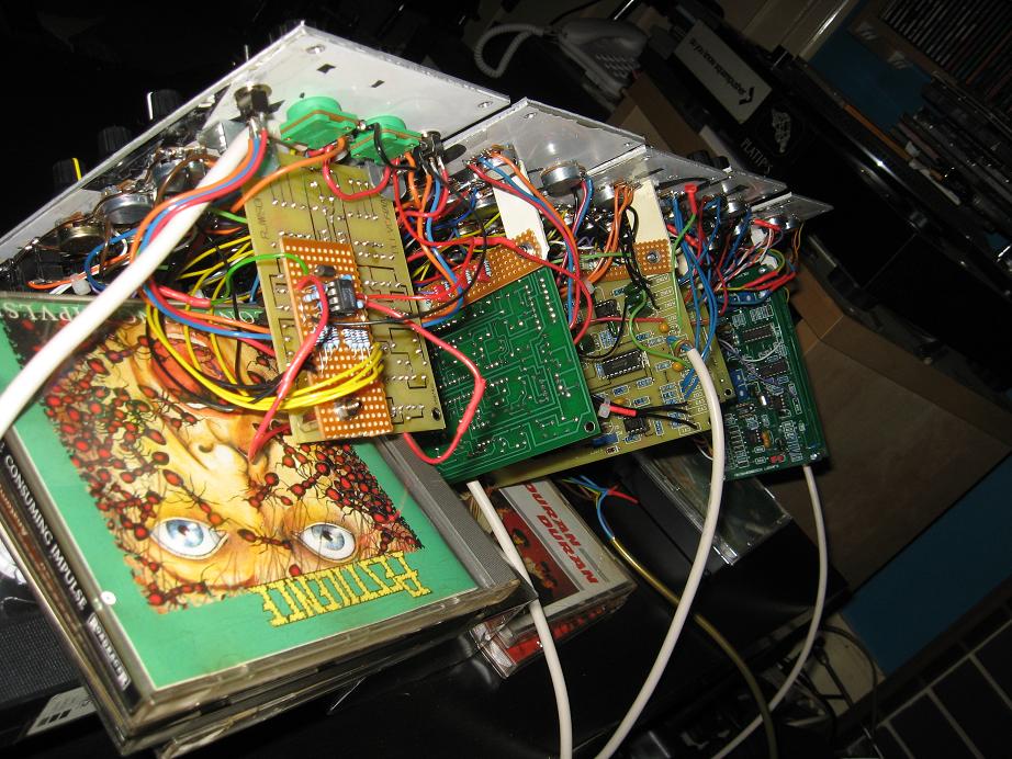

rough back end of modules , need some zip ties , Smile

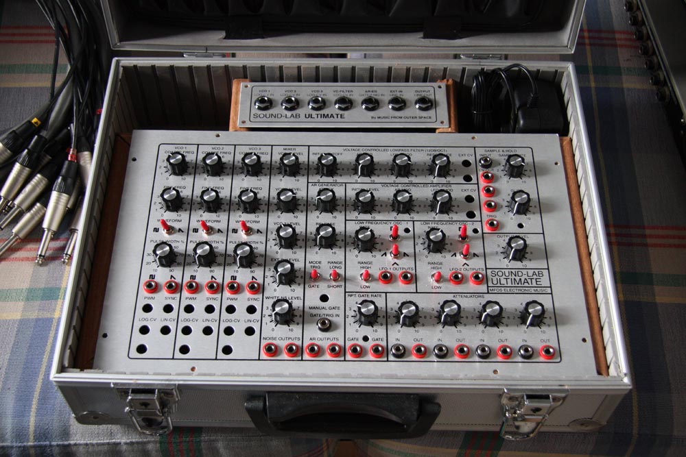

Unfinished Sound Lab Ultimate in a case.. patch cables are to go in the lid.

Nice soundlab Lektroid.

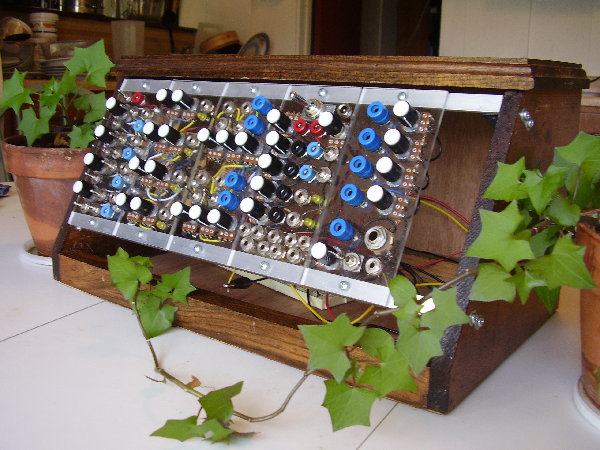

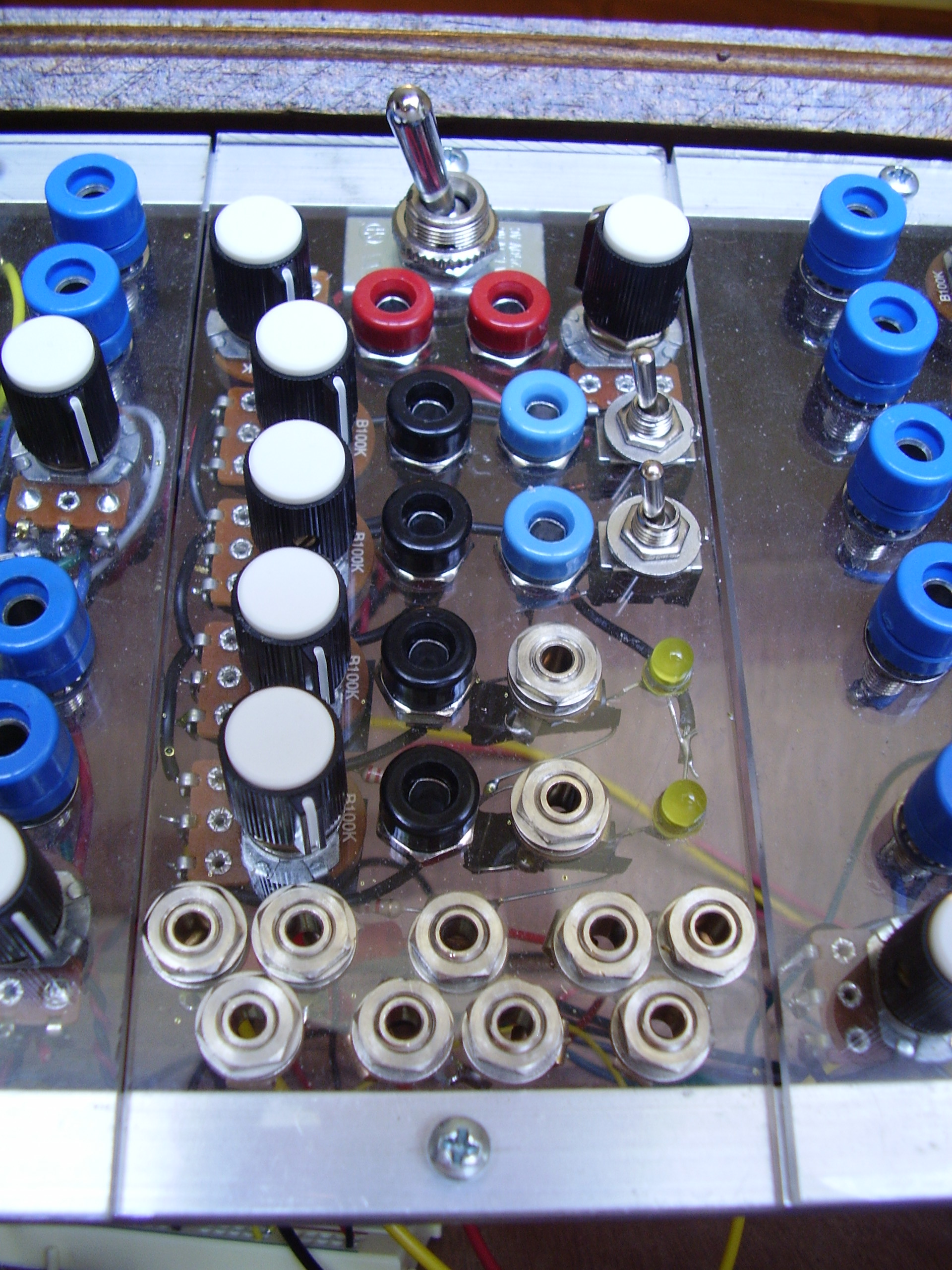

A new cabinet, and some newish modules. Things have been moving a little slow build-wise this year; being back in school has had a terrible impact on my projects... I've got some new stuff that is gaining a little steam though... hopefully I'll have more to share soon!
As usual, every one else's stuff looks amazing!
Bread-box cabinet. The extra gaps will eventually be filled with utilities and a permanent power supply. Modules, left to right: Bug's Oscillator, Quad LFO, Dual WSG filter, Power/Utility, Mixer.

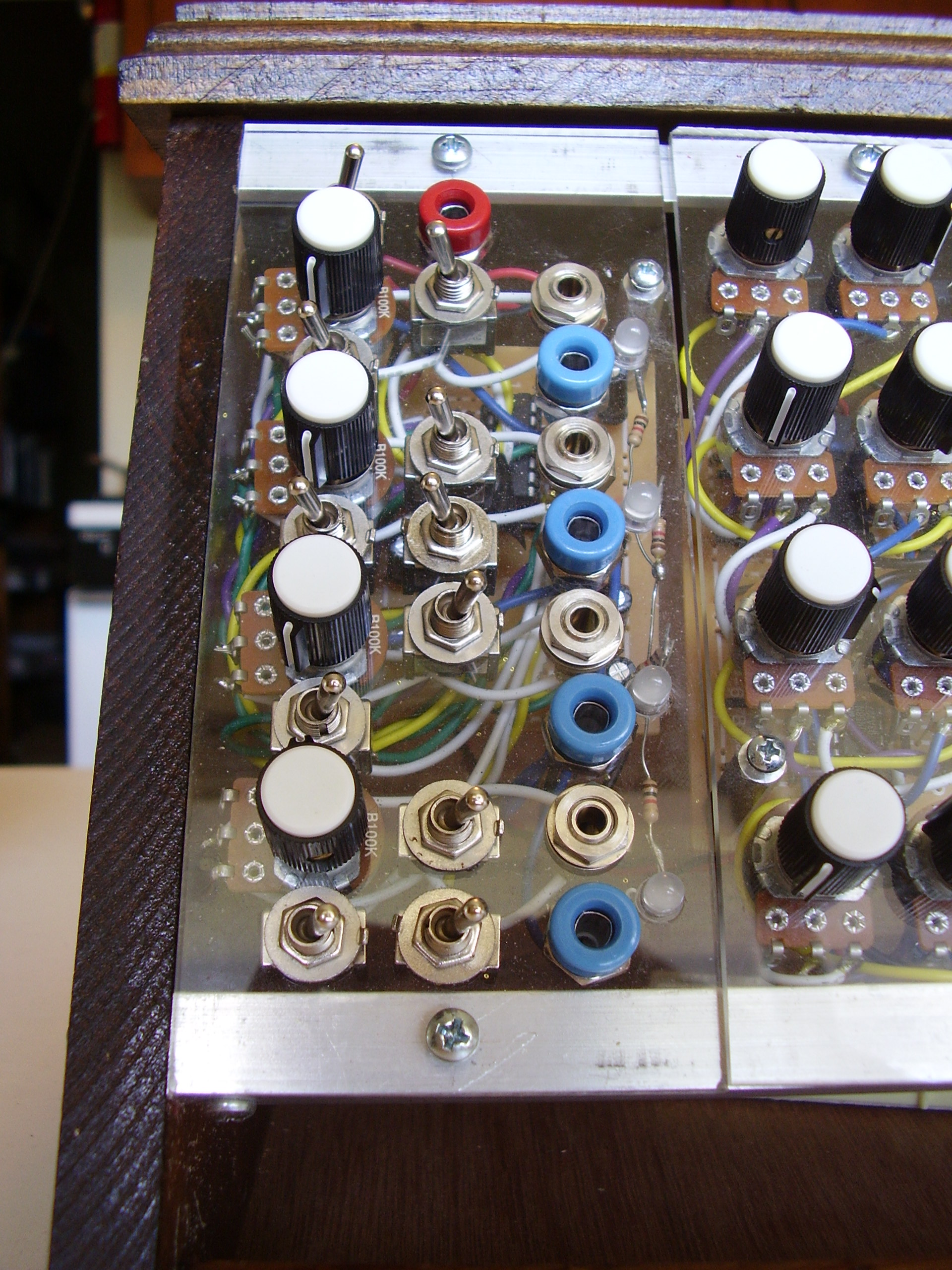

Power/Utility (my new favorite module!): master on/off switch and power jack, 2X power supply outputs (starve supply), 2X attenuators with diode addition switch, 2 audio to control converters with level control, 3X control signal summers

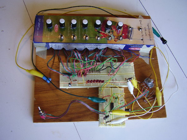

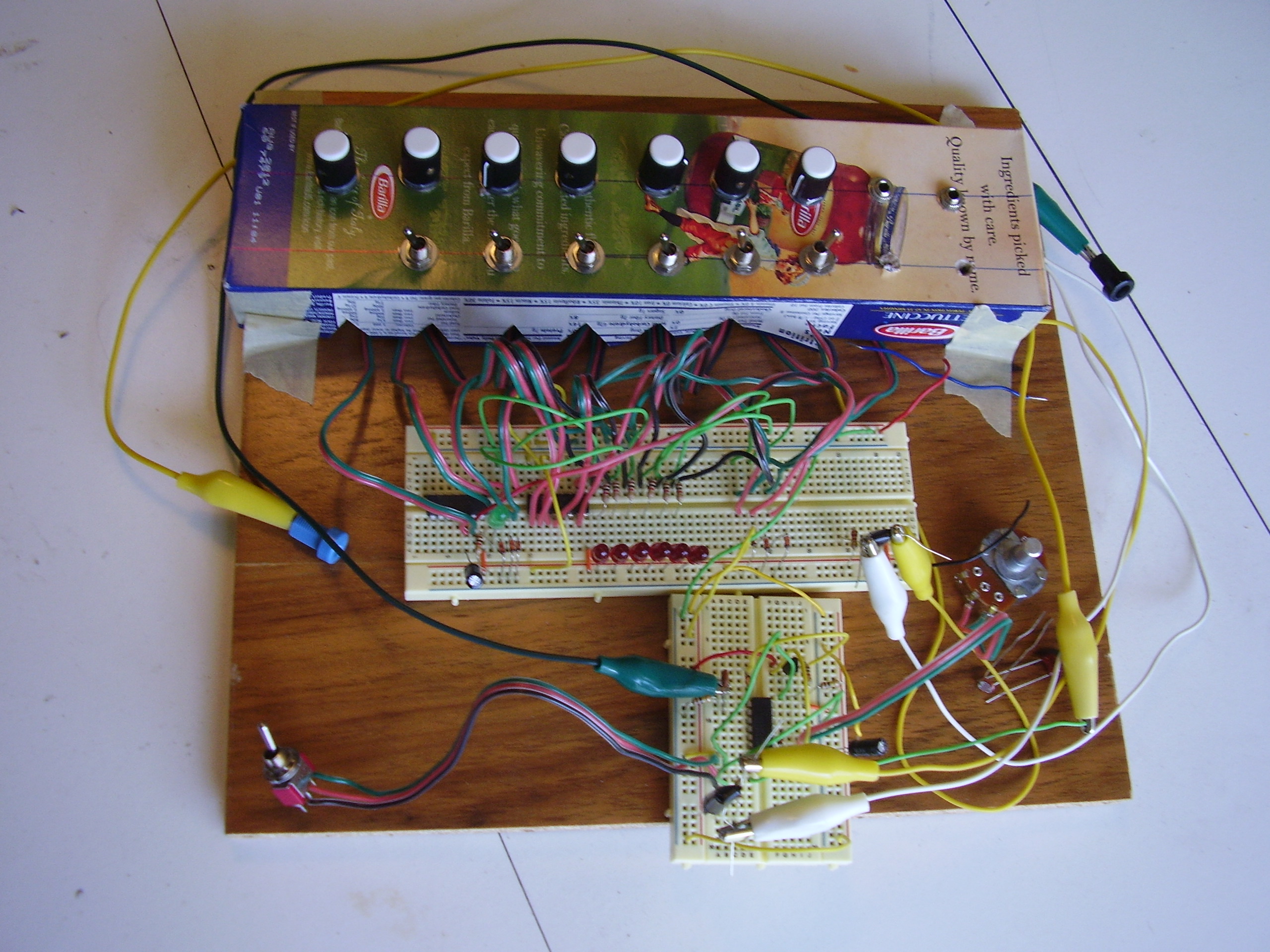

The story of my life: prototyping. I always manage to incorporate food-related containers into my protos... shown here is part of a sequencer project and a ramp/pulse generator.
