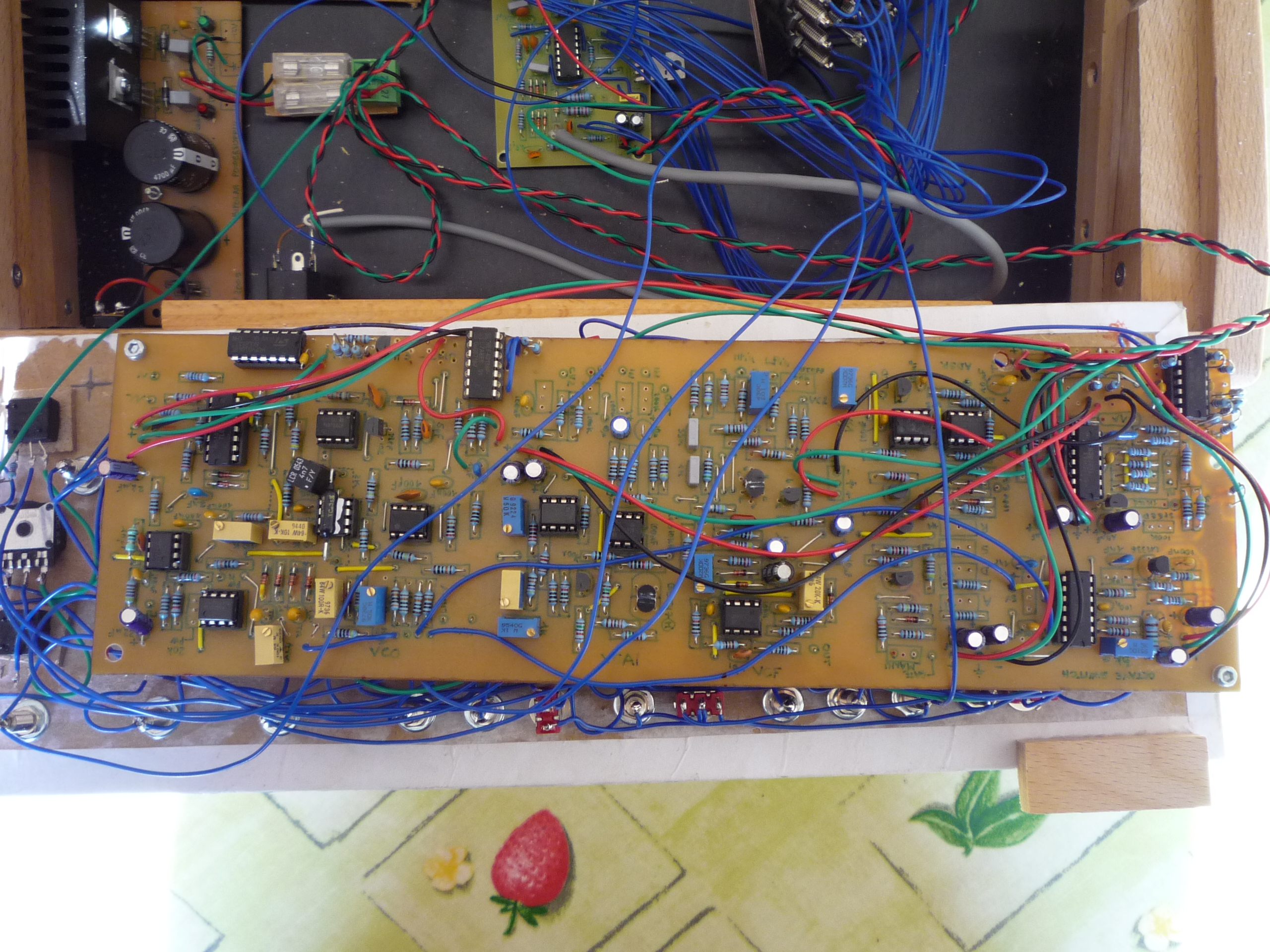

Here a crappy MP3, it seems that MP3 compression introduces a lot of distortion in the 20 first seconds of the recording, anyway here it is:
Basic patch: saw wave + sub osc (with PWM by tri LFO) + filter (Moded by same LFO) + short attack time (2ms) + decay + release on the EG.
Effect: small chorus with ALESIS picoverb
0:00 HP filter and Res
21:00 LP mode and Res (this is normal distortion)
34:00 playing with the mixer for SUB level
46:00 octage range starting from Low to high.
I built this synth as a controller for my mini modular thats the reason why a made it "patchable". I was quite surprised by the "power" of the beast as i undertook the first audio tests.
About the construction:
I used an old keyboard and removed the rubber contacts and replaced them with microswitches and added the resistor ladder. A lot of work that I would not recommend. Its the first synth i've built with integrated KB normally I use MIDI-CV converters, wich are easier to implement and much accurate than the old S&WY designs. But for this synth I wanted to give it a special look and a vintage touch...
have a small look at the mess inside Confused
Anyway DIY is a lot of fun, reading, learning, building, debugging, playing
Alain

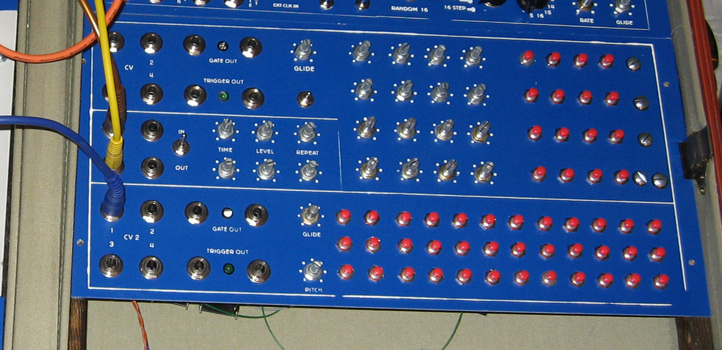

Here is what I tried with the MFOS

Hello delayed,
cool design! (Like accordion?)
For the construction of single bus KB, you'll have to choose of course really good microswitches. I took some push buttons with a very high mechanical lifetime (eg 1 000 000 cycles minimum). And you have to be sure that when you depress the key you won't push too much on the button, else you will maybe destroy them too quickly.
The design is really noise immune but this is due to the real good circuitry by Ray. Normally you should hear no noise because the KB is on the controller side of your synth and not on the audio path. The only "noise" that can be heard is the double triggering of the button's contact. With the KB you "naturally" trigger less easily that with a single button. Anyway, if you experience problems you can change the C21 capa with a higher value (max 1nF) to get larger waiting time between two triggers but, then you won't be able to play as fast of course.
I also did the wiring of the grounds in a "star" way to avoid ground loops. I also added a 20R resistor on the rails of the VCA to be noiseless ( this is not recommended by Ray but, I think it helps a lot).
Alain

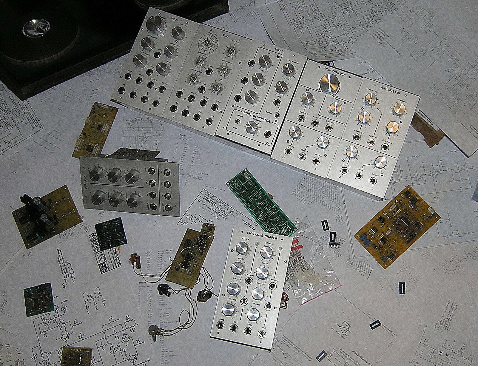

Hello everybody,
the photo demonstrates current condition of my growing modular synth:
Finished, with front panel:
- 3 VCO : Yusynth,
- 1 Signal mixer: Yusynth
- 1 Noise source: Yusynth
- 1 VCF Minimoog: Yusynth
- 1 VCF ARP 4072 Yusynth
- 2 EG: the 555 Yusynth
- 2 VCA: SSM2164 Mike Irwin
Faceplates made from the flat aluminium bar, marked up by "The Magick Touch" transfer technology
Finished, tested:
- 1 V/OCT KBD: MFOS mini kbd
- 1 ARP2600 VCO clone: 4027-1 with waveshaper
- 4 ARP 4027-1 clone (perfect tracking!!)
- Dual gated slew: Yusynth
- PSU: common design with LM723
In progress:
- Buchla inspired enclosure
- discrete SSM2040 VCF
- Oberheim SEM VCF clone
Andriy

Good looking panels man. How do you apply those trnsfers and keep them secure. Really interested in using those myself. Very Happy Very Happy

azot, I love those panels and the metal knobs make them look like they belong on the space shuttle. I must joke with you though, when I glanced at that photo, the way all the parts are scattered about made me think you were playing your synth too loud and it exploded! Haha, good luck with your builds...

nice work, those silver panels and knobs are looking very neat!

Thanks !!)
Ahaha, Inventor, it’s really looks so!)))
I entered synthdiy inspired by old analog synths and modular systems like Moog modular or 100M and first have planned classical black with white legend panel design, mooglike knobs etc. But in way of economy made test panel from anodized aluminium with aluminium knobs. That looks so neat, so I decided implement all faces in this style.
“The Magick Touch” http://www.themagictouch.com/ is enough simple for home implementation. It’s a sort of decol paper for laser print. The transfer process is cold, no thermal press needed. After drying baking is desirable for better adhesion. The surface is waterproof, well steady for abrasion. I had an accident when drilling - the drill goes wrong and left just insignificant scratch!

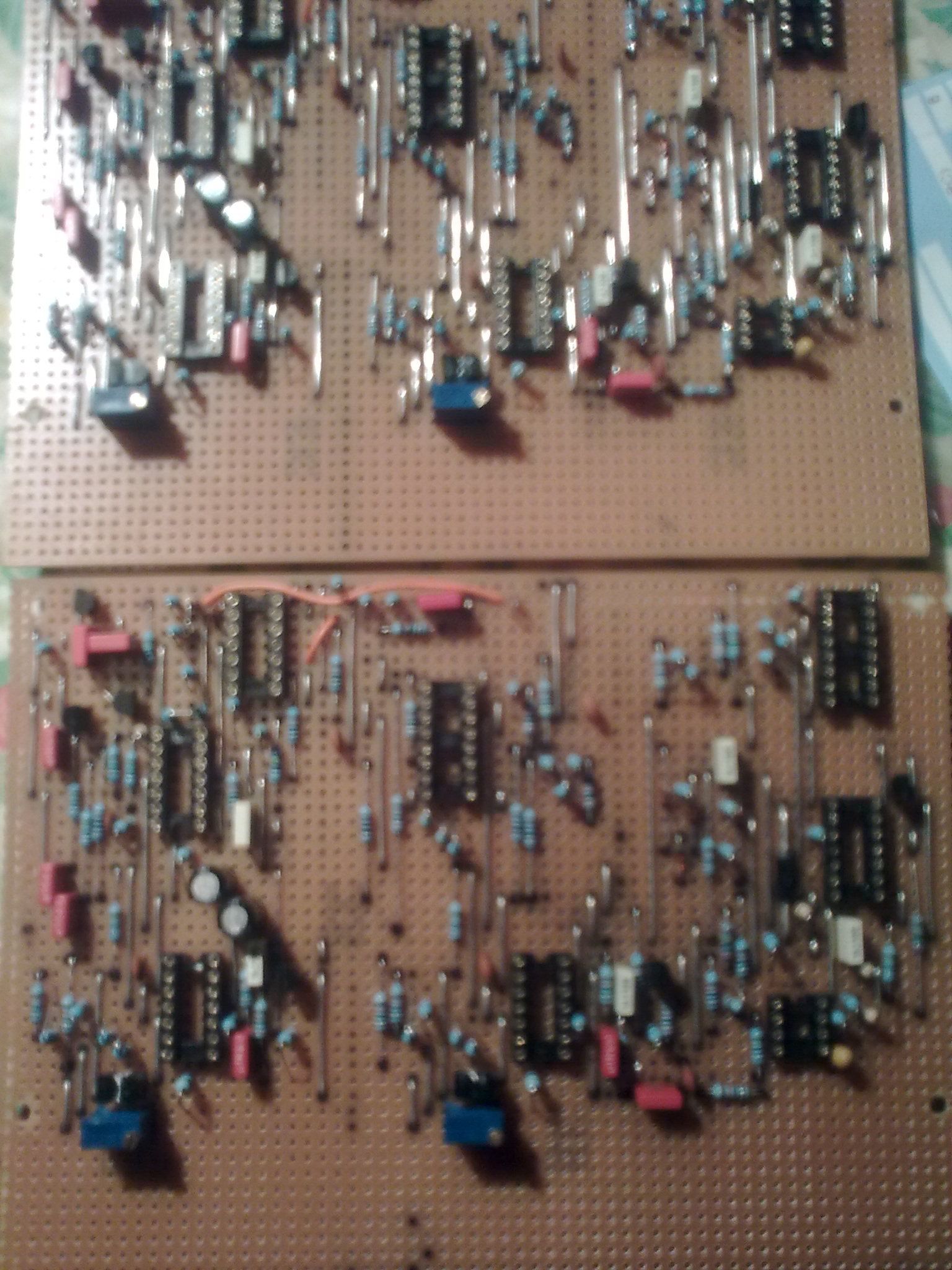

Built a couple of Soundlabs with mods a la UnkleKrunkus strip board layout. Haven't put ics in yet as I want to wire it up and check power rails. One might have two more oscs added and another one or two envelopes aswell not sure yet as Unkle's osc3,4 layout-ish. Diy sequencer is the usual baby8. Haven't got a clue what to do about front panels for anyone of them yet. Too many ideas at the same time. Sorry about quality of pics. Crappy phone camera.Very Happy Very Happy

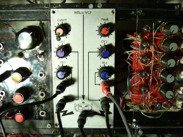

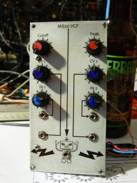

I've decided to ditch my acrylic panels in favor of aluminum panels. Now that I've got a good supply of aluminum. One of my friends chopped up some old street signs on his table saw for me. Here's my first attempt. Only 33 more to go!

crashlander,
are IN1 / In2 attenuators for the MS20 filter clone?
how did you go about when you added the second input?
i noticed that mine sometimes just goes silent when the input signal is too strong... on the other hand i have a feeling that the output is rather low as well. i guess it needs a bit more work...
(it is the rene schmitz version i am talking about, using the jörg schmitz pcb)

Wow! It's great to finally see someone other than myself - separating the jacks from the rest of the controls! Nice work. Smile (I've been doing it, since about 1995, to help keep cabling out of the way of knob control / etc.)

I added a simple input mixer. The filter is overdriven really easily without it. This filer is the Rene Schmitz version in vector board.
