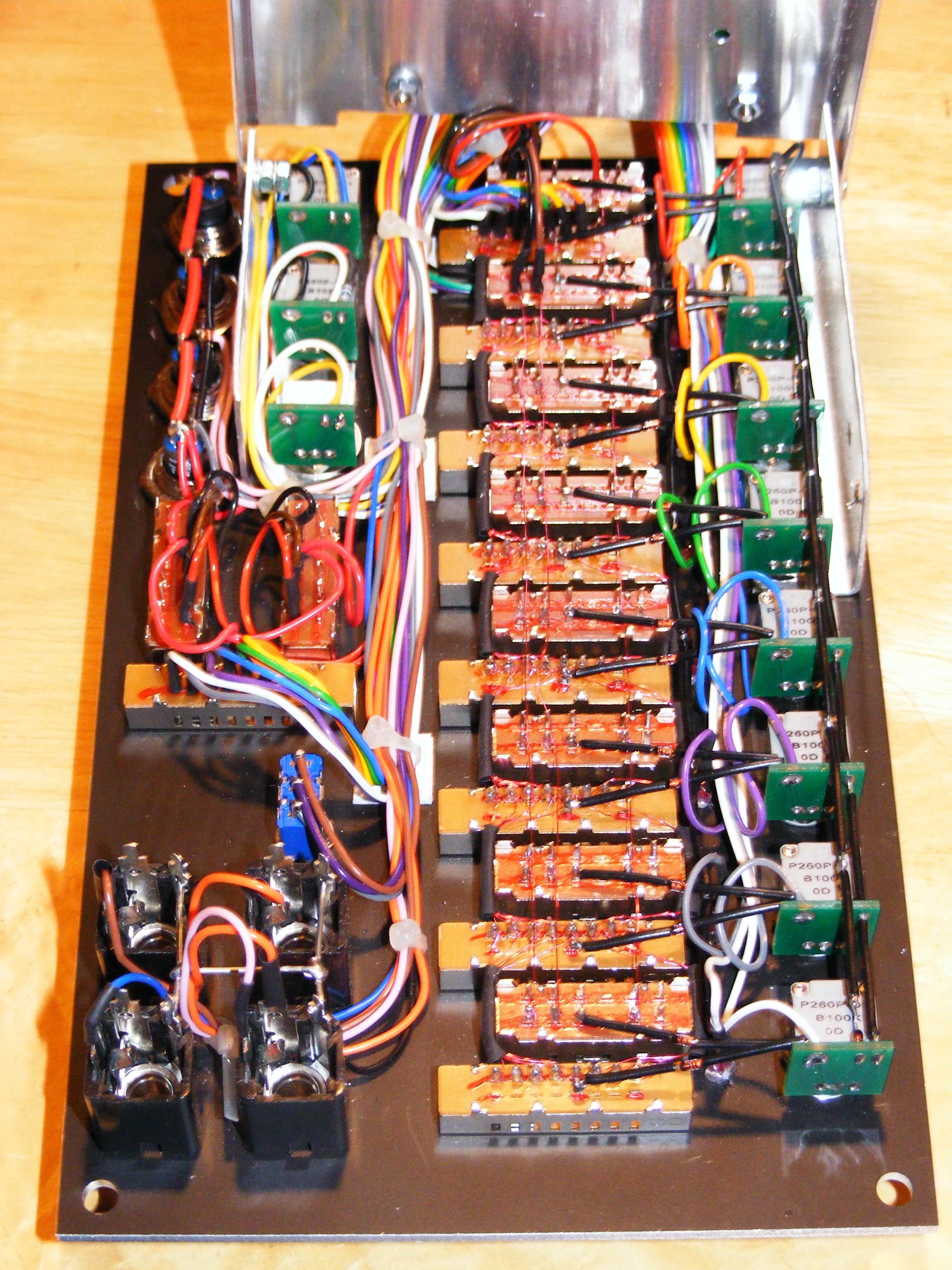

I've managed to get almost all the parts. Got a V2.3 board and a V2.1 pic.
I'm a bit confused about applying which parts to get things working.
first i used BOM 2.1 and found out there was a 2.3 BOM, so i added the parts Q6, R13, R16. R19 and R21 included in the 2.3 BOM version. Then I read something about omitting these parts when using the 4066N IC as described in the V2.1 construction manual.
Right now i've build the sequencer according to the v21 construction notes 191.pdf manual, which includes 4066N. Do i need to remove Q6, R13, R16. R19 and R21 again? They are clearly visible on the picture included in the v21 construction manual, in contrast to the writing omitting them in the build.
Can anyone help me out?
Bastian
magman
Joined: Feb 04, 2009
Posts: 363
Location: Liverpool, UK
PostPosted: Sun Feb 12, 2012 1:04 pm    Post subject: Reply with quote  Mark this post and the followings unread
Hi Bastian,
I just happen to have finally finished my pair of M-185's in the last 2 weeks.
For the 2.1 firmware (ignore the board revision, it's not important to this part of the build), you don't need the Stage CV connection, so Q6, R13, R16. R19 and R21 are not needed. I actually desoldered mine for my 2.1 build, and used one of the transistor leg connections for one of the connections needed by the 4066 to the PIC (rather than soldering directly to the PIC's pin under the PCB).
I've attached a photo of my V2.1 build, you should be able to see where I removed the components in the bottom right corner of the main PCB and took an orange wire to the 4066.
I also built a wiring helper board for the 4066 and all of the switch resistors - then wired to the switches with Ribbon cable.
Hope this helps and feel free to shout out if you have any more issues, as this build is still quite fresh in my memory.
Regards
Magman

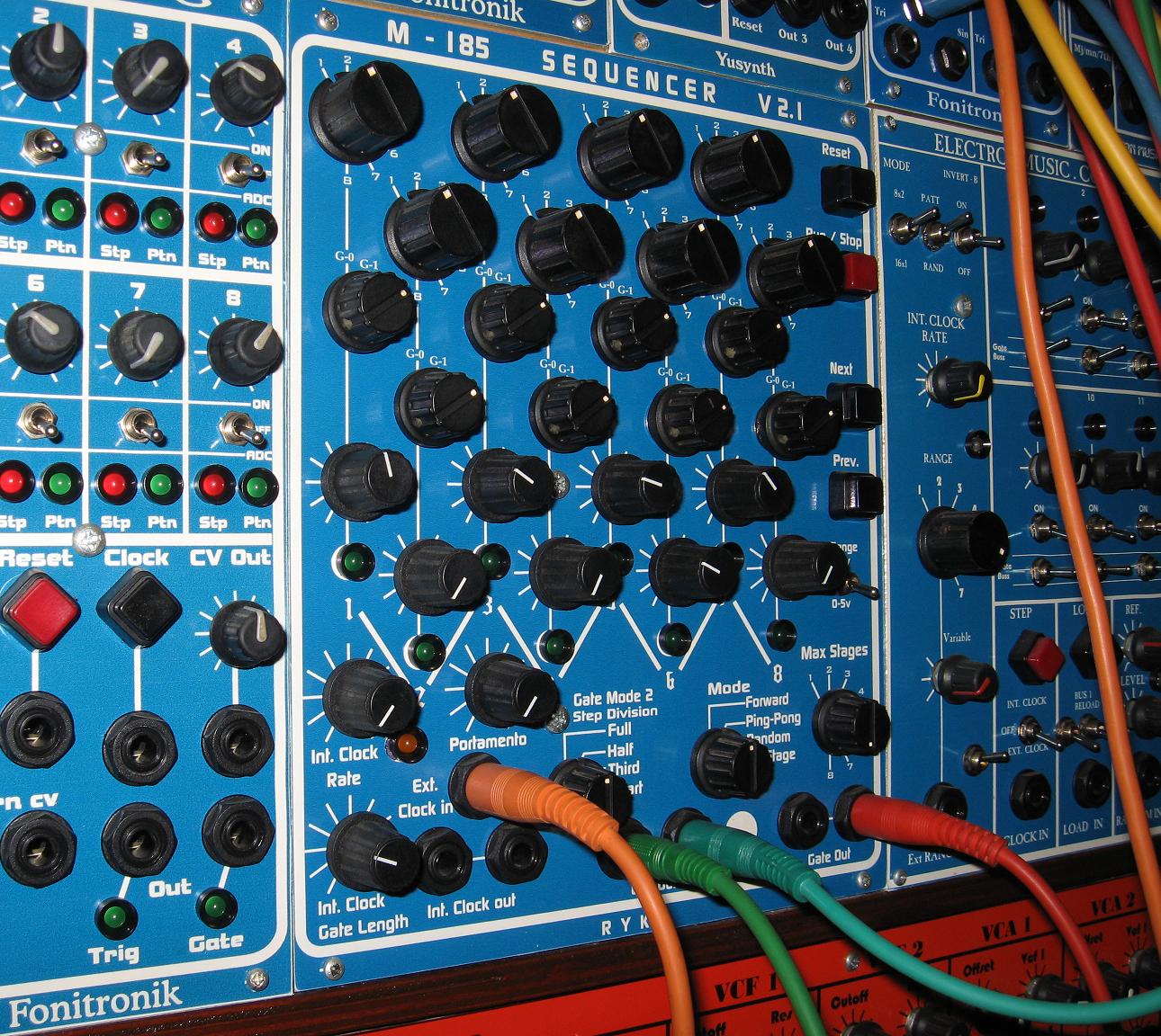

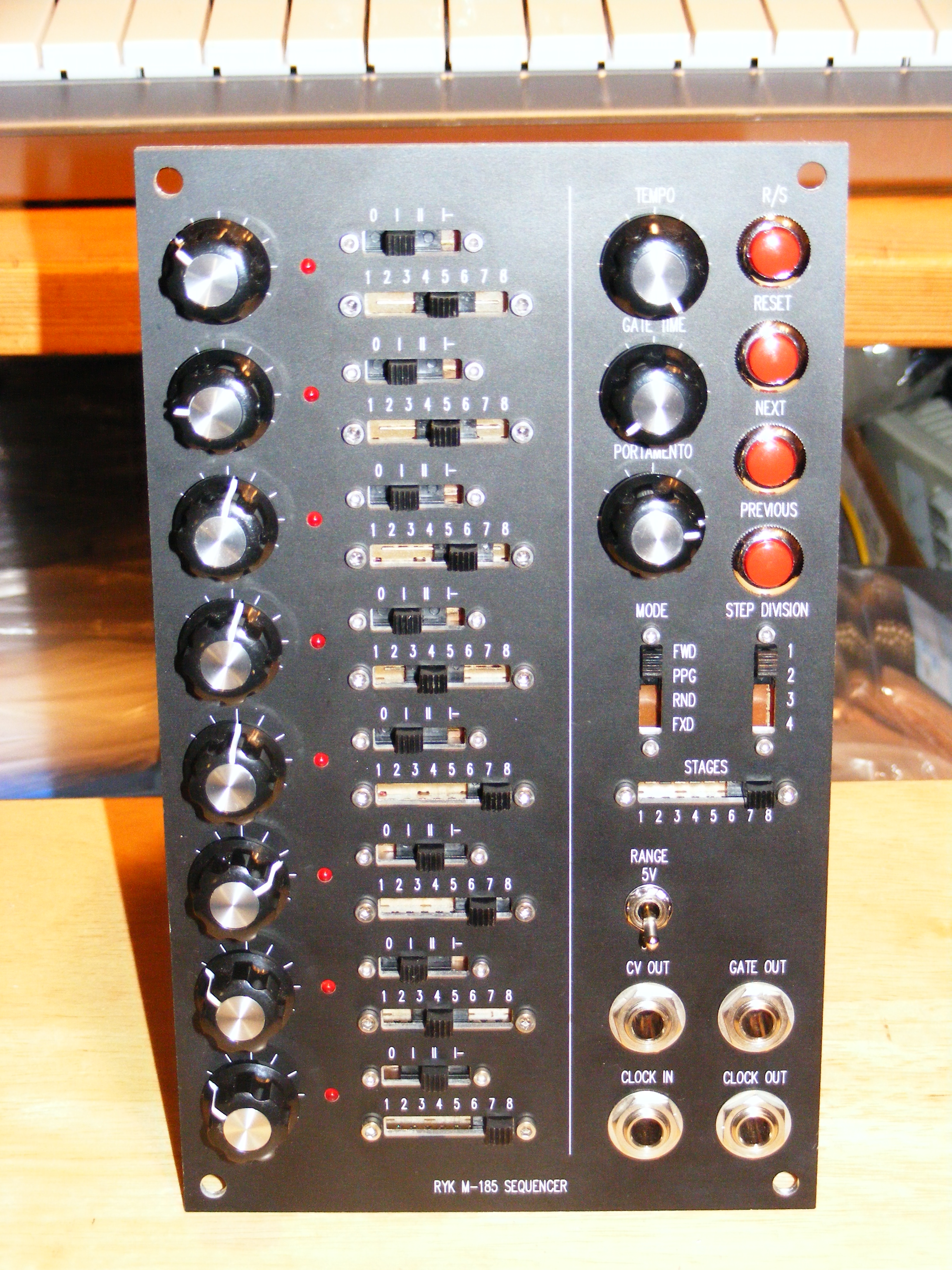

Seeing as I've just commented on Bastian's question, I have no more excuses for not posting some more pictures of my two M-185 I finally finished this month.
This is a Version 2.1 unit using a panel from The Beast. I've probably had the panels for over 18 months, but it appears my New Years resolution is to finish a load of my modules this year, so these were prime candidates.
This is by far the most complex panel I've had to wire so far - over 200 connections on the panel alone. The switch wiring I was putting off worked out quite well when I found an old Verowire pen in one of my old component boxes. This is thin insulated wire held in something like a wire-wrap pen, you just wrap it around the connections a turn or two. The neat part is that you just solder through the wire's insulation, which also contains a flux for the joint. I only had one suspect connection across all 32 switches I wired using this method.
I made a little wiring helper board on matrix board, so that I didn't have to wire resistors directly onto some of the switches. The Version 2.1 firmware needs another IC adding anyway, so this could be located on the wiring helper as well.
I also made a hinged panel so that I could keep the wiring relatively short and used quite a bit of ribbon cabling to make things neater.
I've also got a Version 2.0 M-185 competed within a few days of this one, though this gave me a few more problems. This was diagnosed to 3 incorrect value resistors (should have been 4k7, installed 470R) and a broken track that was hiding under a resistor pad.
Time to get on with building some more panels so that I can carry on working through converting some of my completed PCB's to completed modules.
Magman

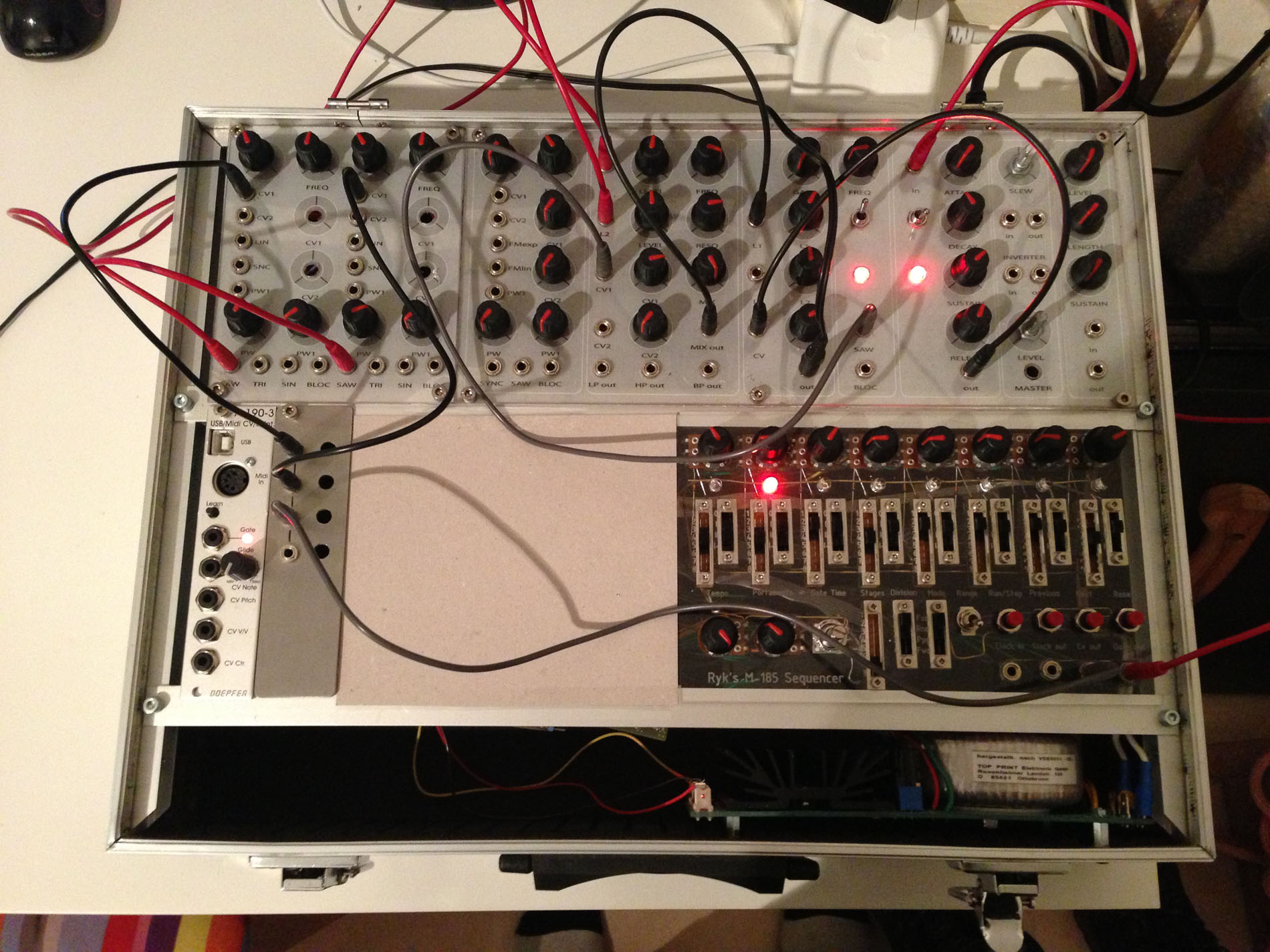

So, Finally some pictures of the finished sequencer.
Got the thing this autumn ready but had too much to do to post some pic's.
Now i've got my two MFOS vco's calibrated, it's good to go!
Made the front plate out of PMMA on a lasercutter.
Engraving is also done by the laser. Done in 2 passes, one cutting and one engraving.
Thanks ryk, for the design and development!
Bastian.
