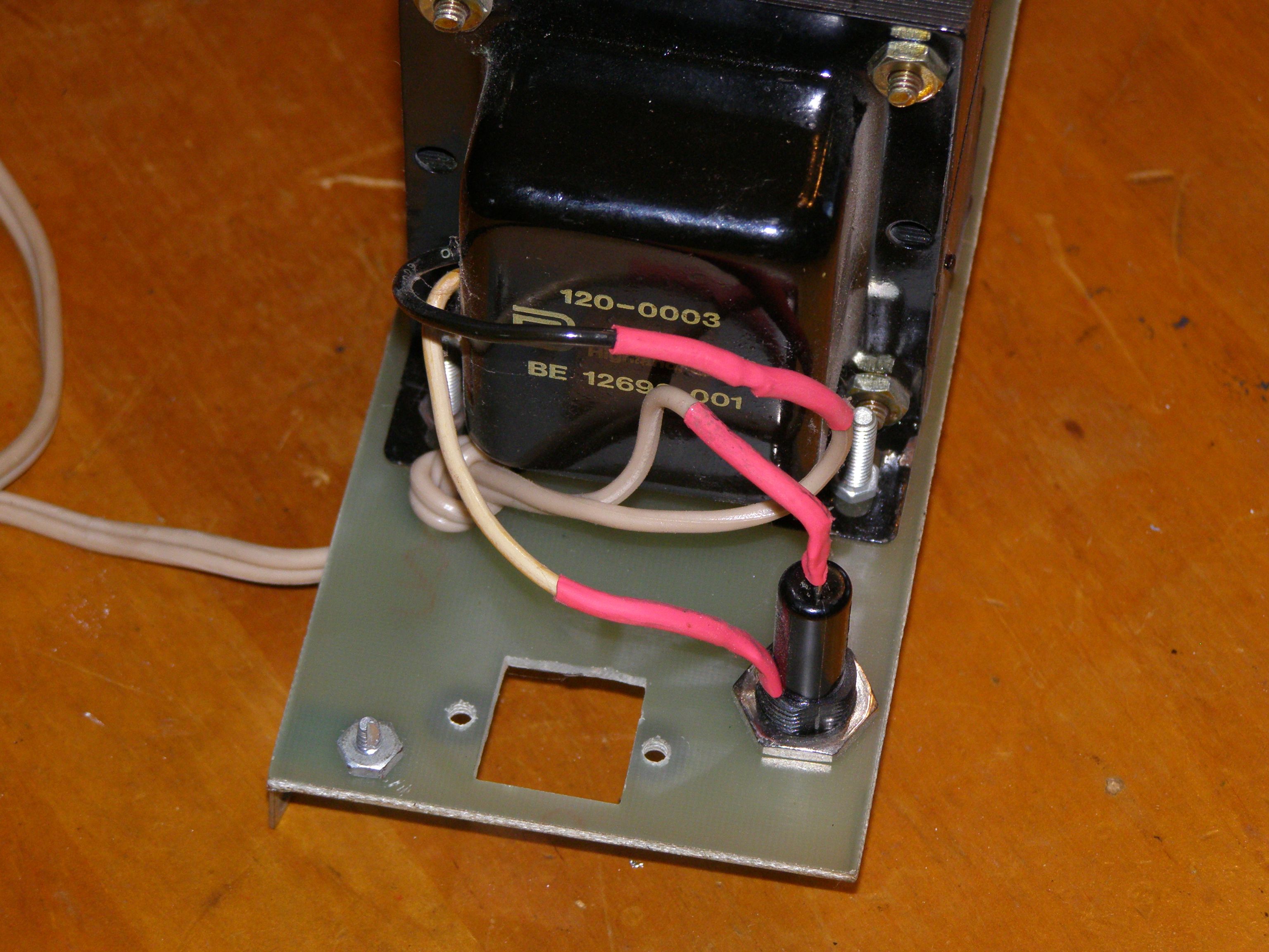

PostPosted: Mon Jul 20, 2015 11:25 am    Post subject: Repairs to my Aries Power Supply Reply with quote  Mark this post and the followings unread
One of the advantages of DIY is that one learns how to repair one's own equipment. My vintage Aries power supply still works to spec. Over the years I've had to replace the filter capacitors and the +15v rectifier and voltage regulator (my most recent repair). Attached are photographs with comments about the power supply and repairs.
The NTE1916 is the replacement Voltage Regulator. The pins (underneath) are not centered, thus the part can only mount in one direction. When I first installed this regulator, it didn't work. Then I looked and noticed that the labeling is "upside down" compared to the original. I checked the datasheet and confirmed that the pins were reversed! A quick swap on the pin connections did the trick.
The original Aries had two serious and hazardous design issues: 1) The mains voltage ran through an exposed fuse holder and, 2) the mains voltage ran through a front-panel mounted toggle switch. My solution was to do away with the power switch (it does not really need one anyway) and to replace the exposed fuse holder with a panel mount style holder.
While I have replaced this power supply with MFOS power supplies, this power supply will live on as a bench power supply (+15, -15, and +5 volts) and a backup power supply (just in case!).

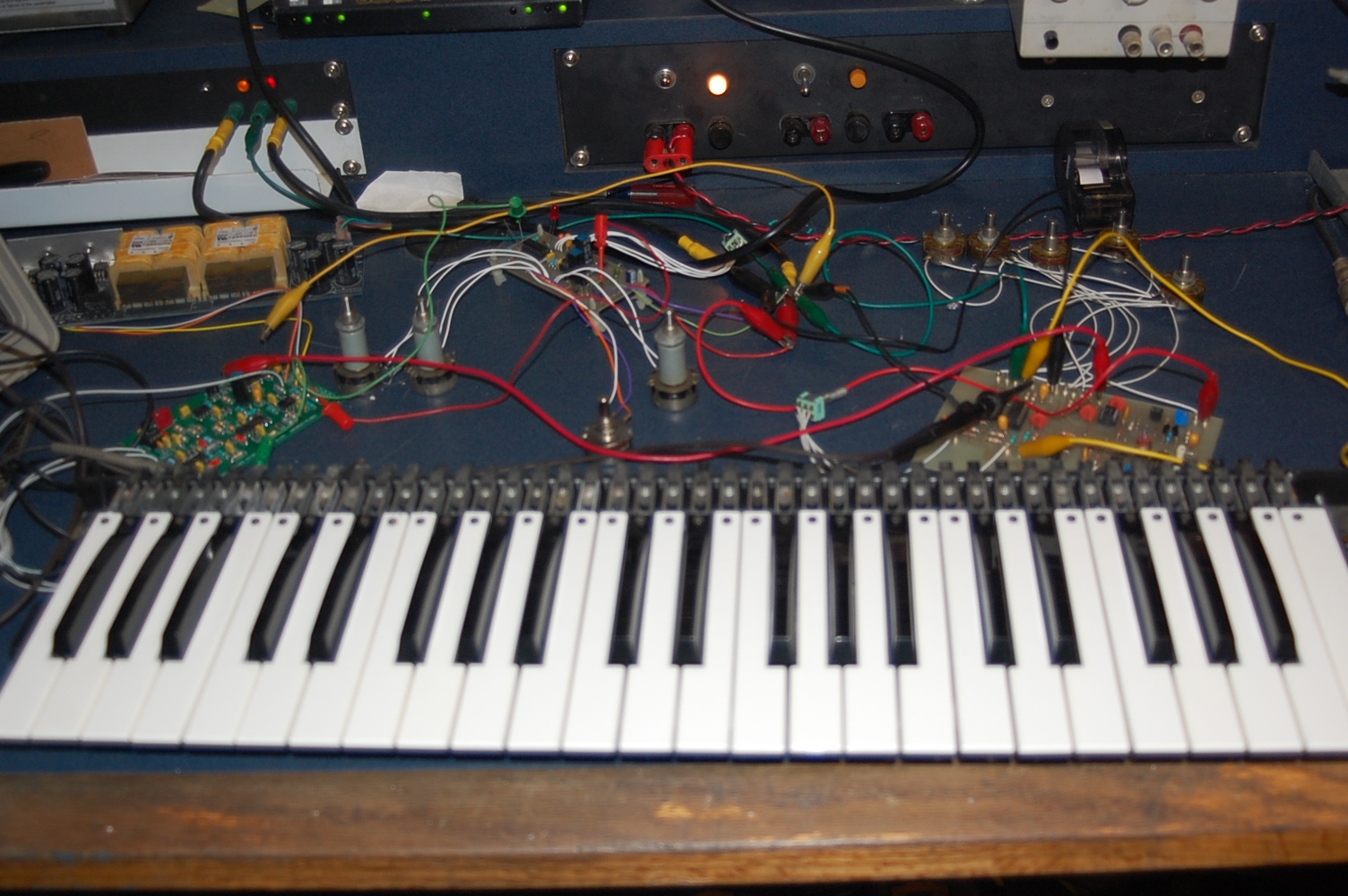

Over a year of messing about finally have something that makes musical type noise. It didn't help I ended up putting it aside for a bit in frustration then finding out the problem was bad IC's. Got the basics done can move on to more interesting stuff to add as well as putting it all in some kind of enclosure.
XR2206 VCO, Yu Synth ADSR, MFOS keyboard controller, working on a VCA this evening. The keyboard is from an old Lowery organ a friend junked.

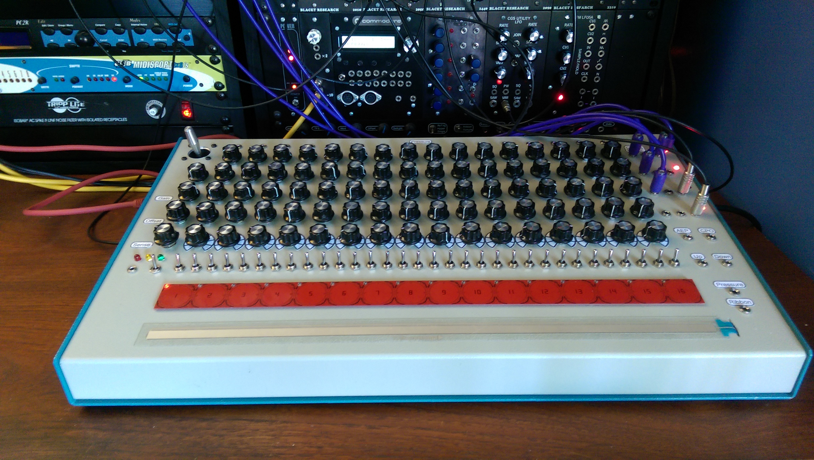

PostPosted: Tue Sep 01, 2015 5:54 pm    Post subject: My many-year project finally complete
Subject description: The Furious Microtemporal Programmer / Sequencer
Came up with the idea behind this 6 or 7 years ago, started building / designing it 2 years ago, and finally finished it!
-gerald
http://www.matrixsynth.com/2015/08/furious-microtemporal-programmer.html

There's a video in the matrixsynth link I sent before. It is a standard (Serge style) programmer sequencer touch keyboard beast, with a custom "variable note length" mode that takes in an analog waveform and sets note lengths based on windowed comparators.
More details:
Core boards
Catgirl Synth “Serge” style touch keyboard / programmer sequencer.
CGS86/87 16-pad set
4 CGS94 “pot carriers”
CGS62 slope detector
Custom boards
Arduino / hacked Narbotic Midivox MIDI clock divider / synced LFO generator
Quad gated comparators to enable step mutes by turning each pot to “zero”
16 stacked windowed comparators to enable continuously variable note lengths i.e. “microtemporal” and microtonal sequencing.
The ribbon goes to an Appendage (hiding just behind the beast).

PostPosted: Thu Sep 03, 2015 4:20 pm    Post subject: Reply with quote  Mark this post and the followings unread
That looks interesting Cool
heh, sorry, actually the whole device looks very nice, but this part drew my attention .. as in .. would like to try something like that for my own synth.
How does it work exactly?
I get the microtemporal bit from the drawing, but it is not clear to me where tonal information comes from.
A quick sketch here looked like Posted Image, might have been reduced in size. Click Image to view fullscreen. here, thought it might be nice to have a selection for the trigger outs to go to one out of three outs.
oldmanfury
Joined: Oct 20, 2006
Posts: 57
Location: CA
PostPosted: Thu Sep 03, 2015 6:01 pm    Post subject:   Reply with quote  Mark this post and the followings unread
The top four rows are all CV knobs. There are three jacks to the right of each output - Out (pitch, or whatever CV), Mix (gets mixed with Out - good for making arpeggiators), and Gate. Gate sends a pulse for every step that isn't dialed to zero.
The bottom (fifth) row is the "note length" microtemporal row. It compares any input waveform to voltage windows set by each knob. When the analog input is within a window, it sends a trigger to the corresponding step - just like tapping one of the touch keyboard pads. A sawtooth will trigger the steps sequentially - other waveforms, not so much.
Watch a video on a serge programmer/sequencer to get a better feel for the basic functionality - any stage can be triggered at any point.
Hope that makes sense?

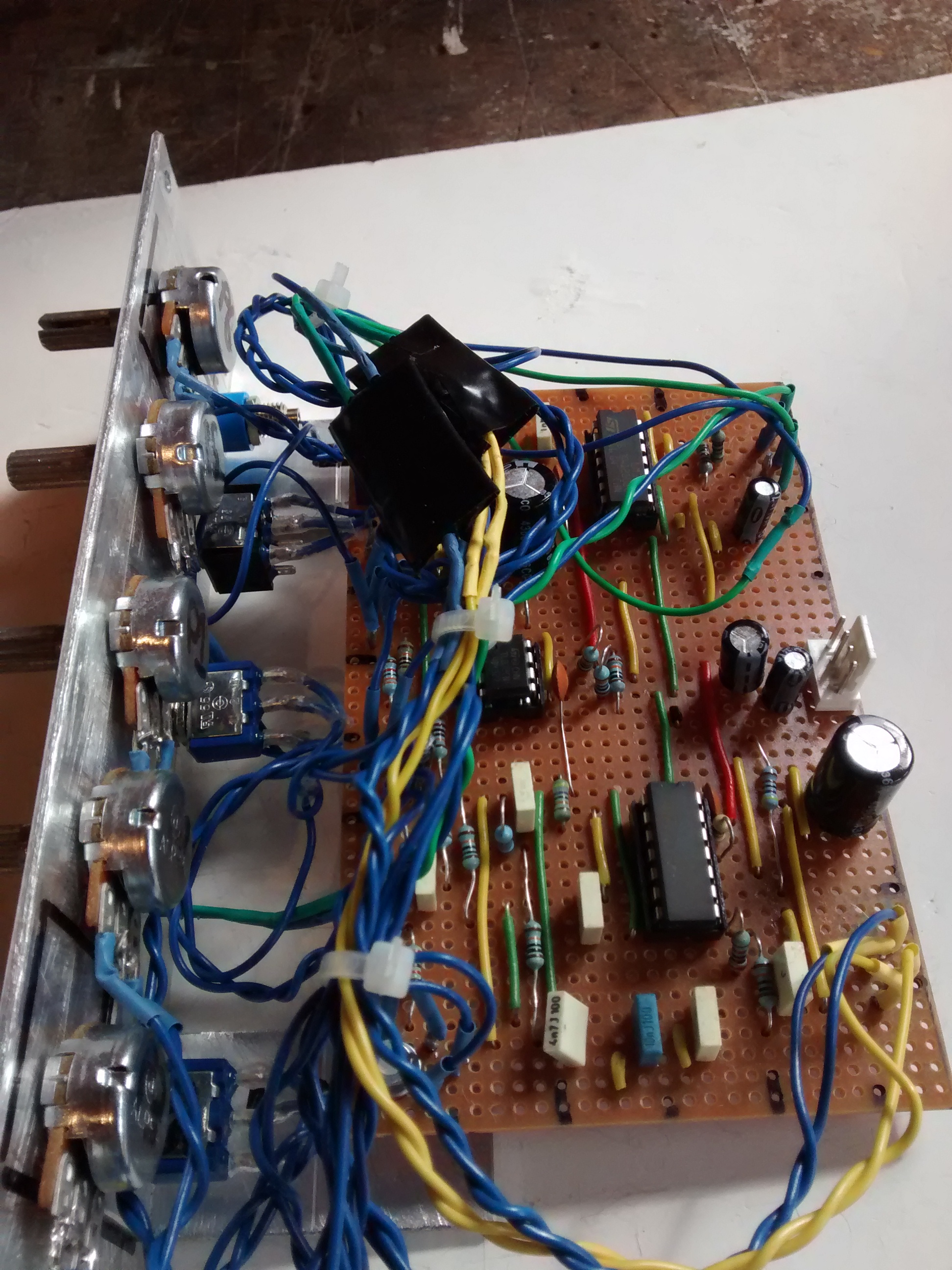

Latest build - a four 40106 drone module by PhoBoS, with a few mods, chiefly adding in an external CV input for the PWM, which allows control by an LFO or any other CV source. I also added extra caps on a switch to give a range of low-pass filter options on the output.
The things in black insulating tape are home-rolled vactrols.
Peter
