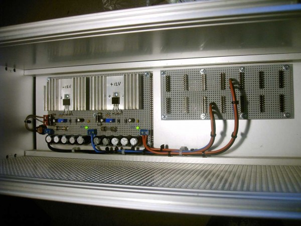

made a (wall wart) PSU for a euro-rack modular. Razz

Oh that looks fine Phobos.
How much current can your PSU provide or handle and what AC voltage has it's on the Output or secondary side?
I'm just asking because i'm thinking about an wall wart PSU for +/-15V for my Systems...
At the beginning i build one out of a real transformer but that took too much space in my box and i was a bit afraid of having that big transformer with it's 230V AC in my metal box... even if i took care about grounding, main fuse and protecting the mains from touching accidentaly with some strips of adhesive and protecting the cable against pulling it out of it's terminal clamps...
I always fear that the adhesive may someday get loose and a flying cable could get in touch with my mains... that wouldn't be that funny...
Posts: 5935
PostPosted: Sat Jan 16, 2016 7:17 am    Post subject: Reply with quote  Mark this post and the followings unread
Thanks Very Happy
I can not give a simple answer about the current since it depends on a couple of factors. The absolute max would
be 2x 1.5A since that is the maximum current the regulators (LM317/LM337) can handle. However they can only
do this if the heatsinks are sufficient and that in turn depends on the input voltage.
Higher input voltage = larger voltage drop = more heat
But I have no idea what the K/W rating is for these heatsinks, they came out of an old CRT monitor as did the diodes
I think (BY255, 3A /1300V! Razz). It could be calculated I guess. And than there are the large capacitors. Rule of thumb
for a double wave rectified PSU is at least 2000uF/A , but this is a single wave rectified PSU so that value doubles.
I have 5x 1000uF on each rail which should just be enough for 2x 1.20A.
All in all I would say the max is 2x 1A as long as the input voltage isn't too high but it would probably run a bit hot.
However the wall wart I am currently using is only 12VAC/12VA so if the PSU was 100% efficient (which it isn't) that
would be 2x 500mA max. Modules usually don really use a lot of current though so for now that should be enough.
And although you didn't ask the copper wiring on the busboard is not added so it can handle more current without the
traces on the stripboard going up in smoke, they should be able to handle the current easily, but to lower the impedance
which means less crosstalk between modules (0 ohm would be ideal). For the same reason I used 2 sets of thick cables
and I also added extra copper wiring to the PSU board.

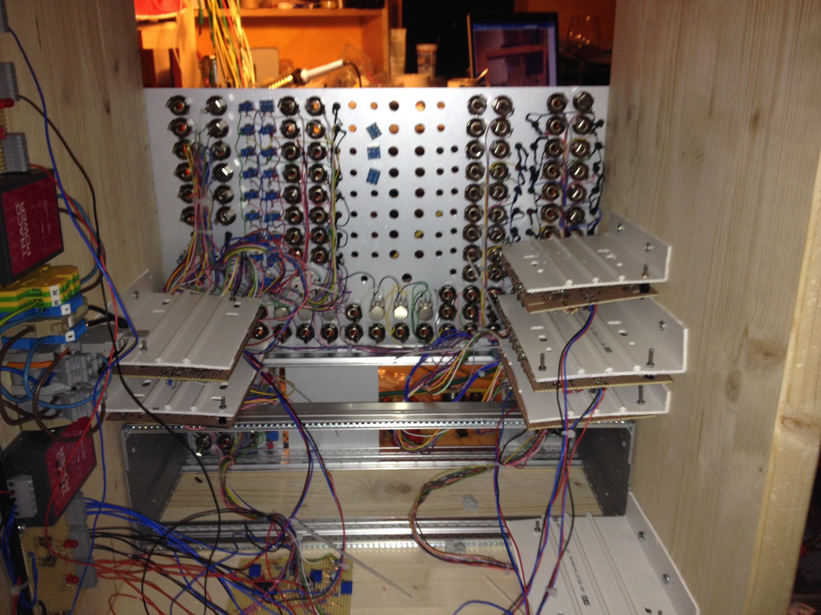

Not finished yet...
Right now working lower left Corner Scott Bernardi VC Delay,
lower right Corner Thomas Henry 4046 VCO
On the greater frontplate:
1x CGS MAster divider
1xCGS Pulse Divider
1xCGS Gate Sequencer
2xCGS Burst Generator
2xCGS Mixer (3Input)
4xCGS Gate to Trigger (or 2 if you count as per orignal PCB)
2xCGS And Logic (Trannie)
2xCGS OR Logic (Trannie) which acts like a Nand (right now i'm to lazy to fix it)
One Gate Sequencer and one pulse divider soon to be added... but i ran out of diodes and on-off-on Switches...
not mounted yet is also a cgs triple-bi-directional Switch... board is ready but will be mounted in the spare samller Panel to be fit on top
Behind the Panels are 2 +/-15V PSU's one for Sound-stuff and one for all the blinky modules...
btw. i will never use such big Panels again... that was horrible to drill These 208 holes with a accu-driven Drilling machine... as the material is a bit thicker it was at least more than 600 times i drilled holes in there... going from small to bigger drills...

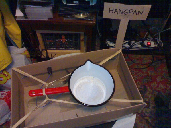

I built a temporary experimental instrument, using a pan, a piezo pickup,
some rubber bands, a pair of shoelaces and a cardboard box. Laughing
edit: posted a recording here
Hangpan

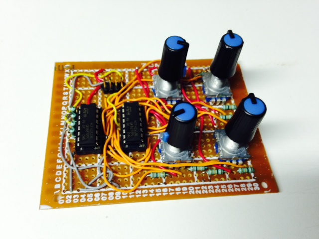

Four encoders and 2 x 4051 mux, for hooking up to an arduino or a pi. The encoders have a push action too. They're super-cheap ones from China, so will probably have a nice dirty signal and need some serious debouncing bounce .
