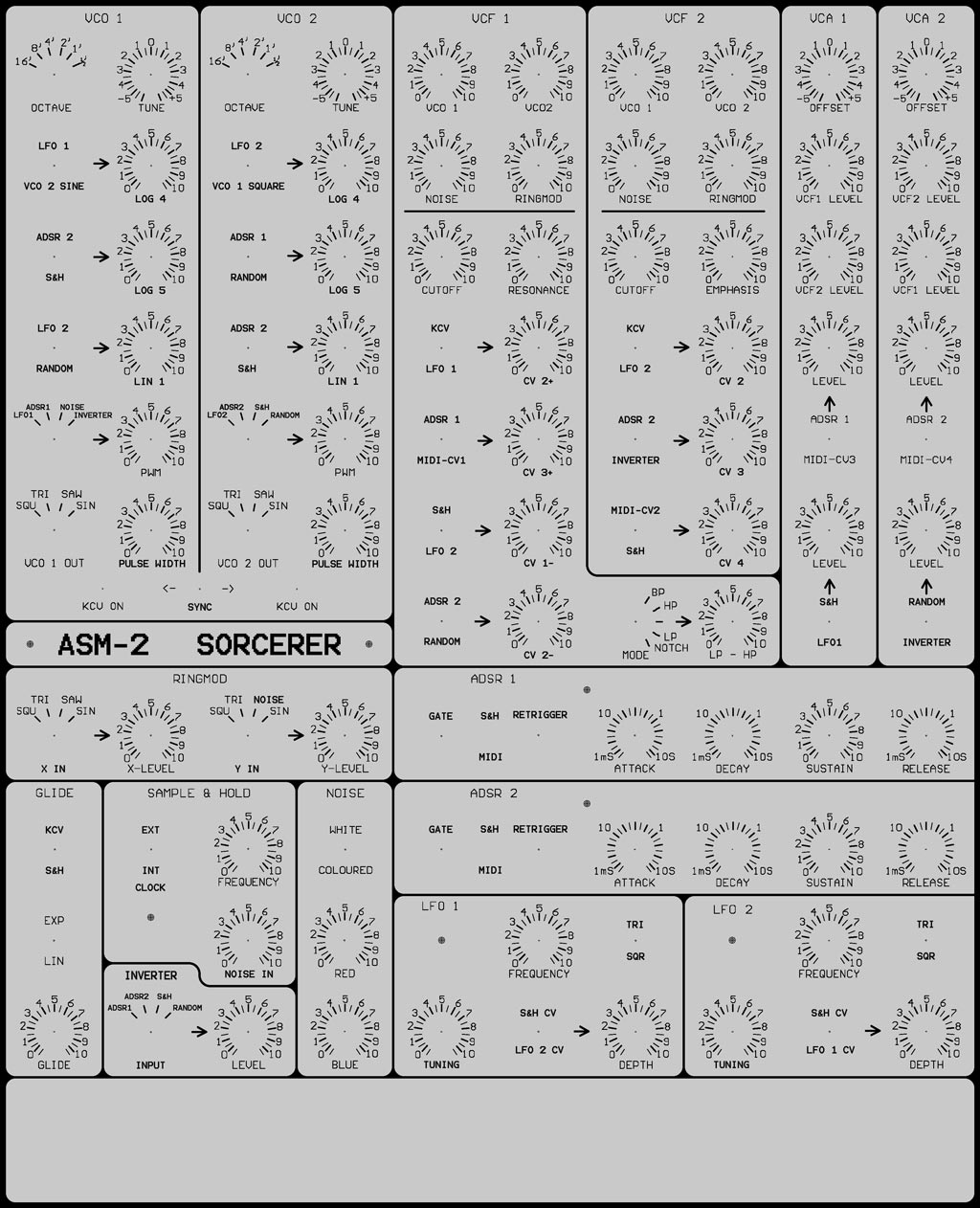

PostPosted: Thu Jul 27, 2006 5:55 am    Post subject: Reply with quote  Mark this post and the followings unread
Opinions wanted please! Critique away. All recommendations considered. Very Happy
Here is the front panel layout at the moment. I haven't re-done the text yet, but I plan to. I hope you can read what all the controls do, 'cos I'd love some feedback on whether I've included everything crucial in a pre-patched synth of this size. If I've put in stuff I won't really need then let me know that too! The space at the bottom will have 6.5mm patch sockets for about 20 key points. What would they be? Mostly inputs? Mostly outputs? 60/40? 70/30? Confused
This image is only 1024 across, the working version is over 3500 across and looks heaps sharper.
Thanks heaps to anyone who can be bothered to scrutinize my plans! Cool

PostPosted: Thu Jul 27, 2006 9:21 am    Post subject: Reply with quote  Mark this post and the followings unread
Hey Uncle K,
Very sweet indeed.
My take on it, just food for thought. You'll have to forgive me, it's a subject I'm quite passionate about.
One word: Modulation, Modulation, Modulation. IMO, this is what makes the difference between a great synth and an outstanding mind and ear gobbling monster. You can have a jillion doodads and jewjaws that perform all kinds of awesome functions, but if you can't route and control them, they will never serve more than a limited function.
So, here goes
External VCO outputs
External VCO Modulation inputs
You may find, for FM, pulse wave modulation can be nice, but tires the ear much more quickly than sine or tri modulation (speaking in reference to VCO2). Crossmodulating VCO 1 and 2 is an interesting patch, particularly dynamically controlled through a VCA or two under control of a non-related function. Self modulation of a VCO produces unusual waveforms.
External VCF modulation input
Audio rate modulation of the VCF is a powerful tool. Just one example: processing VCO 1 sawtooth while modulating the cutoff with a variable pulse width VCO (VCO2) will produce formant tones, adjustable by the PW of VCO2.
External VCA Signal Input, CV input and Output
IMO, the VCA is one of the most underrated modules in a system. Being able to pipe audio/subaudio (if the VCA is DC coupled) into the VCA and routing that signal for modulation can produce wonderful dynamic effects (dynamic depth FM of VCO or filter, for example).
External LFO CV input, external LFO outputs
If you want to modulate the frequency of the LFO with the second LFO through the VCA controlled by the EG output, well there you go.
If the LFO can clock the S&H, pipe a bit of the output of the S&H output back into the LFO CV input. Subotnick.
External EG outputs, External EG Gate Inputs. I notice the EG's can be set for repeating, so I imagine a signal occurs when the EG ends it's cycle. Pipe that out of a connector. An EG just became a gate or trigger delay. Put it on both and alternate between EG's on each cycle.
Noise output. How else are you going to modulate your filter with it? Very Happy
External S&H input
Noise is the choice most often seen as the input of an S&H. I rarely use noise myself, it wears thin pretty quickly for me. I'm more interested in the effects obtained from varying the frequency relationship between the clock and an LFO input. Or, gently frequency modulate a triangle LFO set for around 50 Hz with pink or red noise and sample that. You'll be glad you did. Or that may just be me (and Don Buchla, too, I suppose).
A mult or two wouldn't hurt, but cover the important things first, you can always build or make Y cables, or build an external mult box. Us non-banana jackers are at a distinct disadvantage here, but switching jacks are much more than enough payback for that, IMO. I'd die without my switching jacks.
Asking too much, I know, but IMO, another sadly underrated module in a synth is the DC coupled mixer. You'll understand what I mean once you start patching this puppy. An ideal DC mixer would have a number of attenuverters feeding the input, with inverted and non-inverted outputs. If you really wanted to get jiggy with it, each attenuverter could have a separate external ouput. That arrangement serves not only to have an inverter (as you already have), but a number of inverters plus inverted and non-inverted composites of the signals as they're processed. But, that's knobbage that would take up room needed for the other catalog of stuff mentioned above, and space is limited. There is always Krunkus Sorcerer II, the plans for which will begin forming in your mind as soon as the soldering iron cools......
Did I mention modulation?
Cheerios,
Scott
PostPosted: Thu Jul 27, 2006 2:35 pm    Post subject: Reply with quote  Mark this post and the followings unread
Thanks Scott,
That's exactly the kind of in-depth response I was hoping for. It might take me a little while to incorporate all those ideas, but I'm getting a lot better idea of which patch points to include.
bigtex
Joined: Mar 30, 2006
Posts: 323
PostPosted: Thu Jul 27, 2006 2:49 pm    Post subject: Reply with quote  Mark this post and the followings unread
Scott's routing comments were great. Flexibility is very important. One thing I'd change (aside from adding more routing flexibility) is the layout structure. For example, you have two VCFs next to each other, but the common modulator inputs are not in the same order between them. Why not put the ADSR pots side by side rather than on the bottom for VCF1 and in the middle for VCF2. For me, this would make more sense and my hand would just know where to find the knobs, without thinking. I'd know that for anything that gets modulated by the ADSR, it's always the second knob down, or the bottom knob, or whatever you like. Consistancy, though, throughout the panel. That's what I like.
Now, so far I've only made designs, I have yet to actually fabricate anything... so take what I say with a grain of salt. In the designs I have made so far, though, I always try to repeat a pattern, and lay things out in a set order rather than just cramming knobs where they will fit. It might take up more panel space, but it will be worth it in the long run to have a very logical and orderly layout. In fact, I find that it often ends up taking the same ammount of panels space, but it just takes longer to find the right layout style.
Just think: if you build this yourself, you'll want to keep it for a very long time. I've been adjusting and remaking my panel designs for the Ray Wilson PCBs I bought (some modules and a Sound Lab) since April. I'm just now getting the layout refined to the point where I'm really happy with it. Of course, I only work on it for an hour or so every so often, but coming back to something after some time I see things that I dislike that I wouldn't have noticed before. But, then, I guess I can't delay this for ever... one of these days I'm going to have to actually build these things Smile
Anyway, I'm kind of rambling here... but just think about your own ergonimics and the way that you personally like to have things organized. Approach the layout from that perspective and you should settle on something that you like for years to come.
