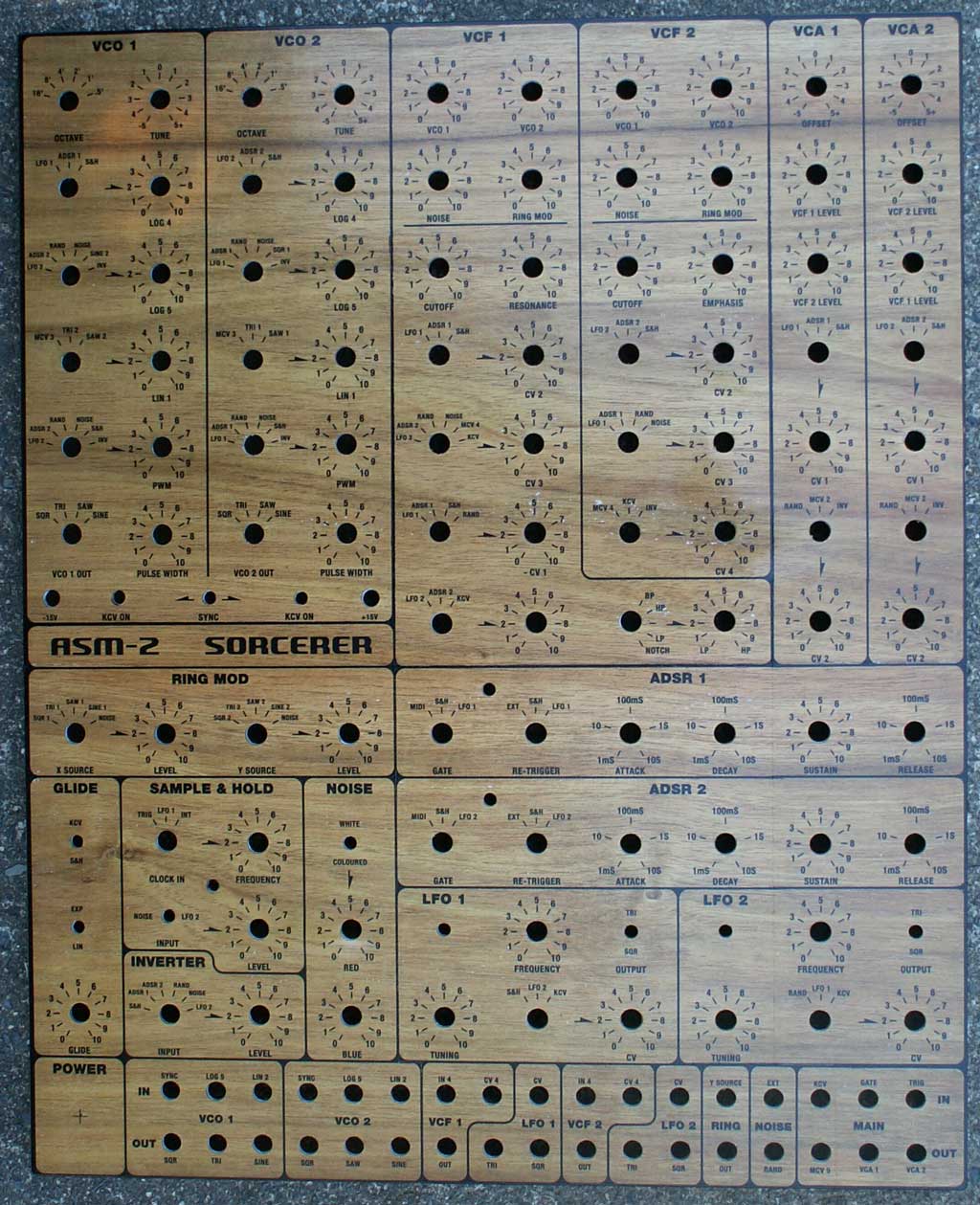

PostPosted: Tue Aug 15, 2006 3:53 am    Post subject: Finalising the layout (help needed) Reply with quote  Mark this post and the followings unread
Okay dudes, (and Dudettes)
I need some serious help now.
The layout is almost finished, but I need some sharp eyes to look it over and give me some specific feedback about connection options, etc. I'm particularly unsure about the gate and trigger options on the ADSRs.
I've included some of your previous ideas; -
Like similar mod option groupings, and noise mod options for the VCFs and RingMod, and LFO as a S&H input. In fact I've doubled the number of modulation options by incorporating more rotary switches (I had a stock of them anyway).
And any problems with the aesthetics of the layout as well.
As you can imagine, once I start drilling holes and mounting components, Murphy's law says that some things will need to change. I just want the list of unplanned modifications as short as possible.
Thanks in advance to anyone who has the time to help. Very Happy

PostPosted: Tue Aug 15, 2006 10:24 am    Post subject: Reply with quote  Mark this post and the followings unread
Just some thoughts: I would like some patching options and say 1 or 2 mixers with the option to rout them to your cvs. You´ve already covered most possibilities, but you never know. Those rotary switches might have a few more settings.
You´ve got octave and tune pots. If the tune-pot has to cover an whole octave it might not be finetunish enough.
For the lfos i would include a shape-controll. Never want to miss it!
And independant rise and fall lag can be very powerful and takes only another pot.
How are the vcfs and vcas connected? parallel/seriel?
The overall design looks really cool!
PostPosted: Tue Aug 15, 2006 4:14 pm    Post subject: Reply with quote  Mark this post and the followings unread
The section at the bottom will have normalised 6.5mm patch points, but I'm afraid I can't fit any more controls, (I've already got the sheet of aluminium, and at 430*530 I wouldn't want it any bigger.)
The octave switchers will have their own trimmers, referenced off the precision +/- 10V supply inside, so I don't think the fine tuning will be a problem.
What exactly do you mean by shape control, and rise fall lag? The PCB is finished, so I'm not really doing much more in the way of actual circuit function mods.
I'm going to have separate outputs for each VCA. They can be fed by mixed levels of either VCF, which in turn have a separate mix of the four sources.

Rise and fall, i mean that instead of one speed (or lag) pot, you have two, each with a diode. One controlls the charging, one the discharging of the cab. This can be musically very interesting.

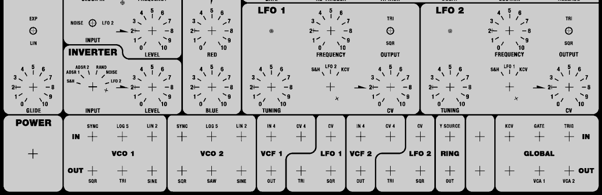

PostPosted: Fri Aug 25, 2006 4:02 am    Post subject: Reply with quote  Mark this post and the followings unread
Here's the patchbay section at the moment.
I've got some extra spots to fill up, but I'm unsure of what I might want. Anyone got any suggestions?
This photoshop doc has now reached the 140MB mark! Surprised
And it's only in greyscale!! Shocked
Over 80 layers, in case I suddenly decide to change the fonts! Rolling Eyes
But it's almost finished! Then I'll be able to start putting it together! Yeah! Very Happy

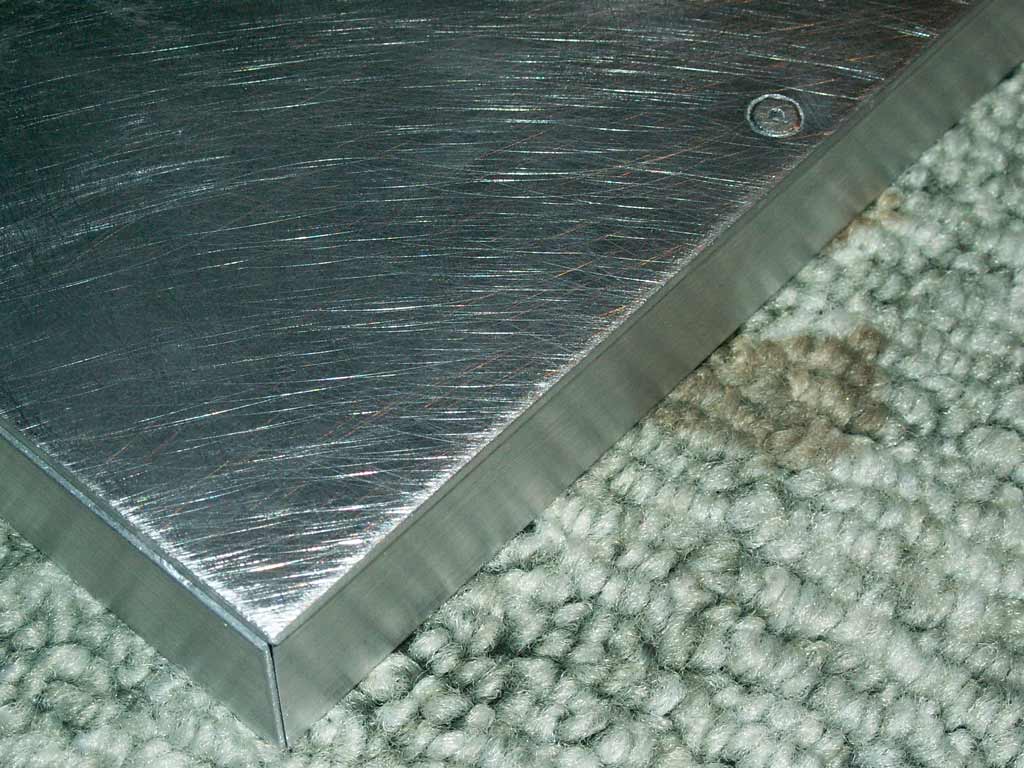

PostPosted: Wed Sep 06, 2006 7:17 pm    Post subject: Reply with quote  Mark this post and the followings unread
Here's the first three construction photos. Let me know if anyone finds these handy or inspirational.
First up, I attached a 20*12mm L stock frame all around the 2mm front panel. This helps to stop any flexing in the panel, and gives me something to attach the rest of the case to.
 Filesize:  103.73 KB
 Viewed:  518 Time(s)
I decided to pop rivet the frame on, as the front will be covered in veneer and I didn't want any chance of things coming loose etc.
I had to countersink the rivet heads so they wouldn't cause lumps behind the veneer.
 Filesize:  83.22 KB
 Viewed:  557 Time(s)
Then I filed the rivet heads flat with the surrounding panel. The great thing about covering this in veneer is it actually helps if you scratch it up.
 Filesize:  113.08 KB
 Viewed:  572 Time(s)

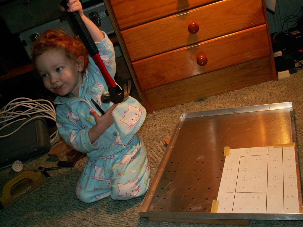

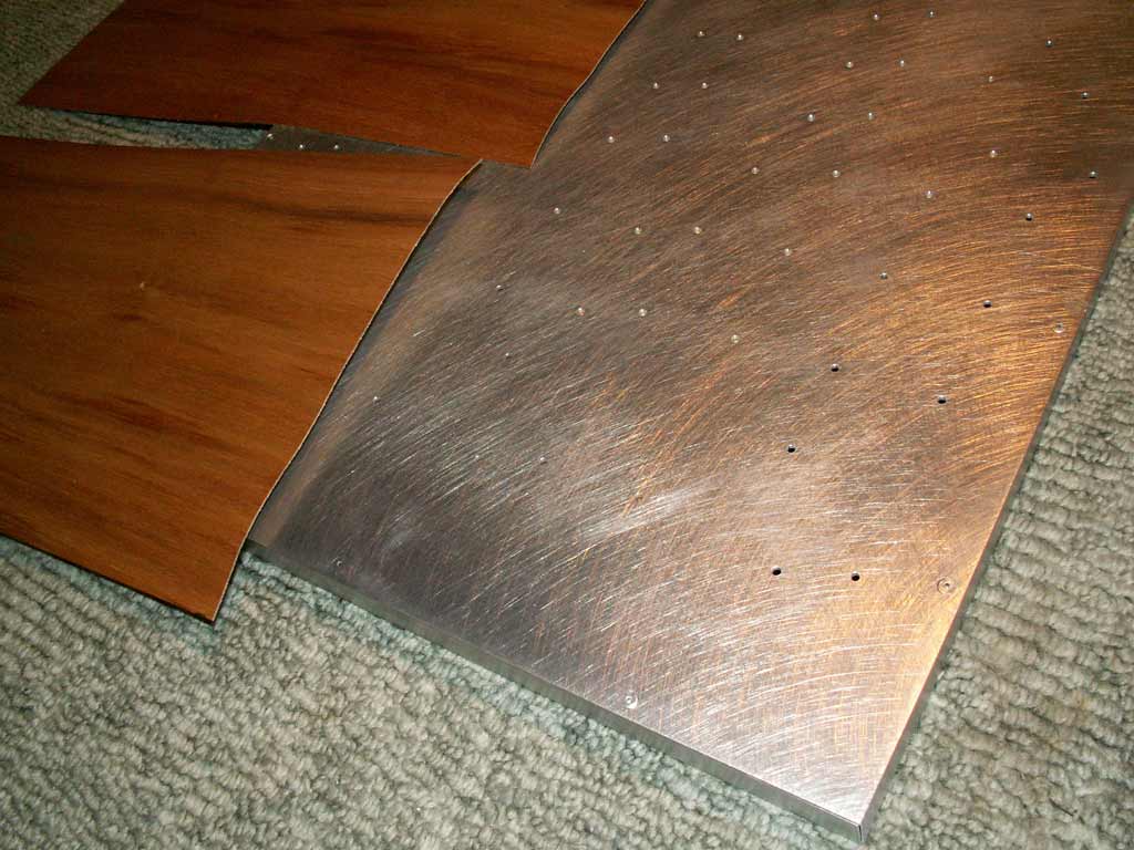

PostPosted: Thu Sep 14, 2006 3:52 am    Post subject: Reply with quote  Mark this post and the followings unread
Okay,
here's the next set of three pics.
Things are moving along really well.
I printed off some reversed drilling guides and centre punched every hole from the inside.
I wanted to drill the locator holes first, as they only go through the aluminium. I always put pilot holes of 1.5mm (1/32) through first and then use wood drill bits (they have the outside edges raised with a spike in the middle) for any hole which you want centred and round! You can buy them from hardware stores, but you can make your own out of a standard bit, if you have some kind of grinding wheel, and a bit of practice.
With all the locator holes drilled and cleaned, I wiped over with some isopropyl alchohol and ironed on the veneer sheets. After filling the grain and sanding smooth, I gave it a coat of satin enamel. Next morning I decided it was too thick and wiped it off with turpentine and an open weave cloth. It actually ended up being a really beautiful finish. Now to drill the real holes!
Here, my beautiful assistant shows how easy it is to swing a hammer!
 Filesize:  62.82 KB
 Viewed:  452 Time(s)
Locator holes drilled, time to iron on the veneer.
 Filesize:  92.87 KB
 Viewed:  492 Time(s)
Finished panel ready for real holes.
 Filesize:  104.36 KB
 Viewed:  516 Time(s)

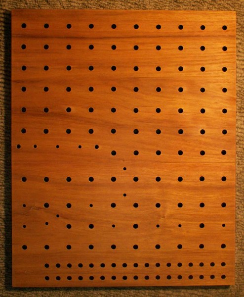

PostPosted: Mon Sep 18, 2006 4:34 am    Post subject: Reply with quote  Mark this post and the followings unread
And here we have it with all holes (except the power switch) drilled.
 Filesize:  107.33 KB
 Viewed:  484 Time(s)

PostPosted: Mon Sep 18, 2006 7:40 am    Post subject: Reply with quote  Mark this post and the followings unread
that's impressive! does it qualify as furniture too? heheh
i forgot if you mentioned how you're going to label it - i'm quite curious.
i'm having visions of you using one of those "wood burning kit" engravers Wink
have you received the kit from elby yet?
michel
Sneak-Thief - raw electrofunk
Posts: 24606
Audio files: 310
PostPosted: Mon Sep 18, 2006 8:47 am    Post subject: Reply with quote  Mark this post and the followings unread
Those holes are in line !! wow ! wish I could do such ...
PostPosted: Mon Sep 18, 2006 8:55 am    Post subject: Reply with quote  Mark this post and the followings unread
Oh it's furniture all right!
This is gonna be a work of art!
Family heirloom kind a thing.
The labeling has already happened.
I did it with Lazertran yesterday.
It's looking Beautiful! Very Happy
Photo coming tomorrow.
