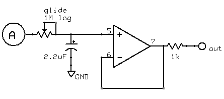

PostPosted: Tue Sep 26, 2006 10:56 pm    Post subject: Reply with quote  Mark this post and the followings unread
Coriolis wrote:
...where would I put the optional lag pot?
below i posted a small schematic. just replace the output protection resistor (1k) by this little circuit (the left opa from the tl084 can be used as a output buffer...). the cap doesn't have to be polarized, i think.
 Filesize:  2.8 KB
 Viewed:  14255 Time(s)
PostPosted: Tue Sep 26, 2006 11:01 pm    Post subject: Reply with quote  Mark this post and the followings unread
concerning the voltage processor i'd recommended to replace the 10k resistor at the negative input of the first opa by a 2k 10T trimmer (used as variable resistor) and a 9k1 resistor in series. this way you can use a center taped pot and calibrate the circuit.

PostPosted: Wed Sep 27, 2006 12:04 pm    Post subject: Reply with quote  Mark this post and the followings unread
Thanks fonik, those look nice and easy to try, and probably deserve a module of their own as you say.
So, if I understand correctly, the lag circuit is the same as glide?
If, for instance, I put a sample & hold fed by white noise through the lag circuit, the output voltages would glide from step to step smoothly, instead the abrupt random stepping one usually gets with s/h?

PostPosted: Wed Sep 27, 2006 10:38 pm    Post subject: Reply with quote  Mark this post and the followings unread
C
yep!

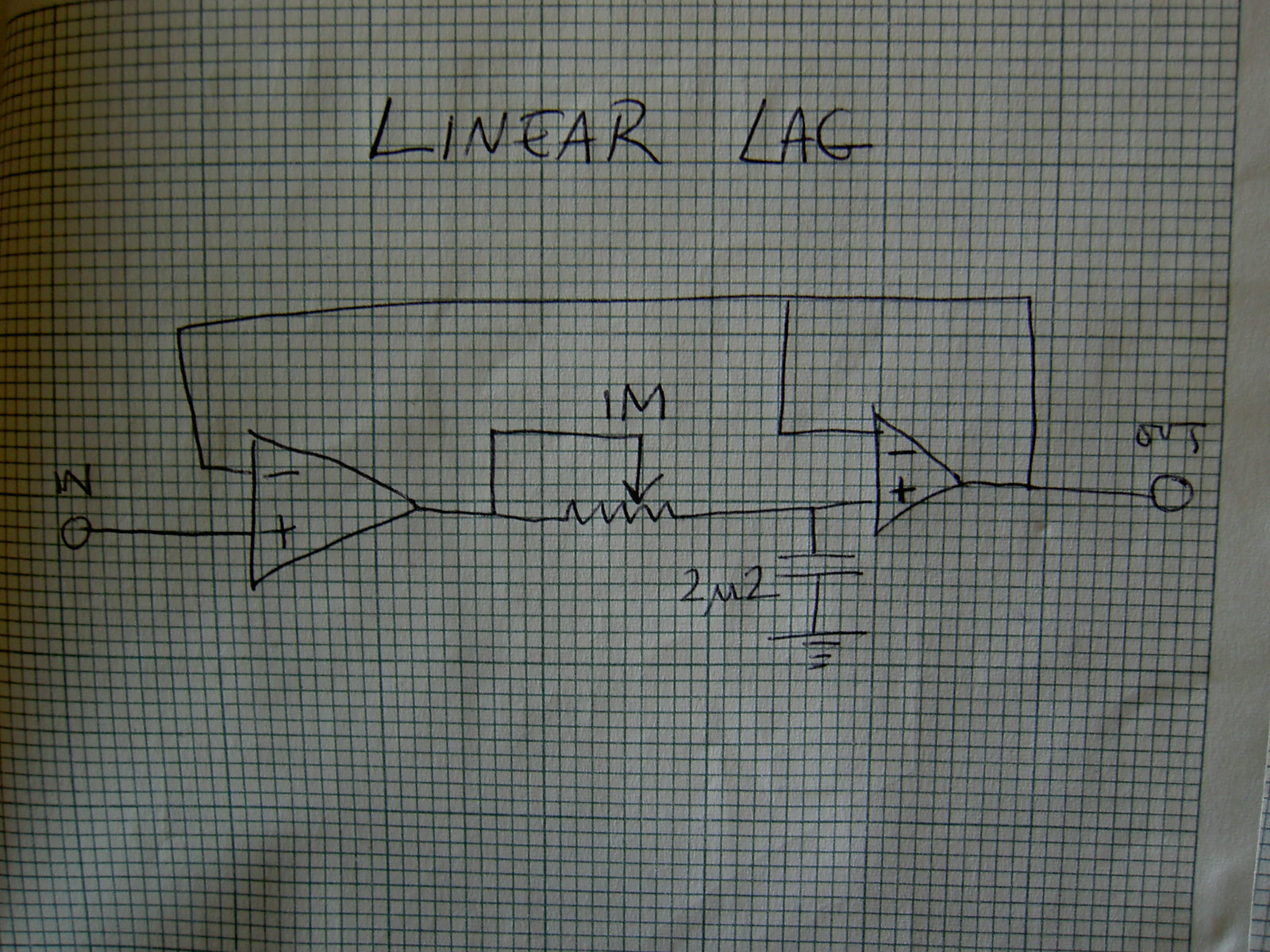

PostPosted: Tue Oct 10, 2006 1:01 am    Post subject: Reply with quote  Mark this post and the followings unread
hi coriolis, i know the klee2 deserves all our attention, but the voltage processor is easy and fast to build. i breadboarded the circuit and came up with some improvements. besides some minor changes i incorporated a lag pot, a trimmer for calibrating a center taped pot (+/- processing) and there's a resistor missing in the original schematic. to bring the LEDs to live they'll have to go to ground via a resistor. so here's my breadboarded and tested version of the buchlidian voltage processor:
voltage processor (+/- attenuvertion, offset, glide)

PostPosted: Tue Oct 10, 2006 10:07 am    Post subject: Reply with quote  Mark this post and the followings unread
i just want to say, that in case you want to use the processor for 1V/oct CVs, R4 should be matched with R3/T1 and P1 to have the OPA at 1:1 amplification - mmmh, am i right or just a little bit confused?
