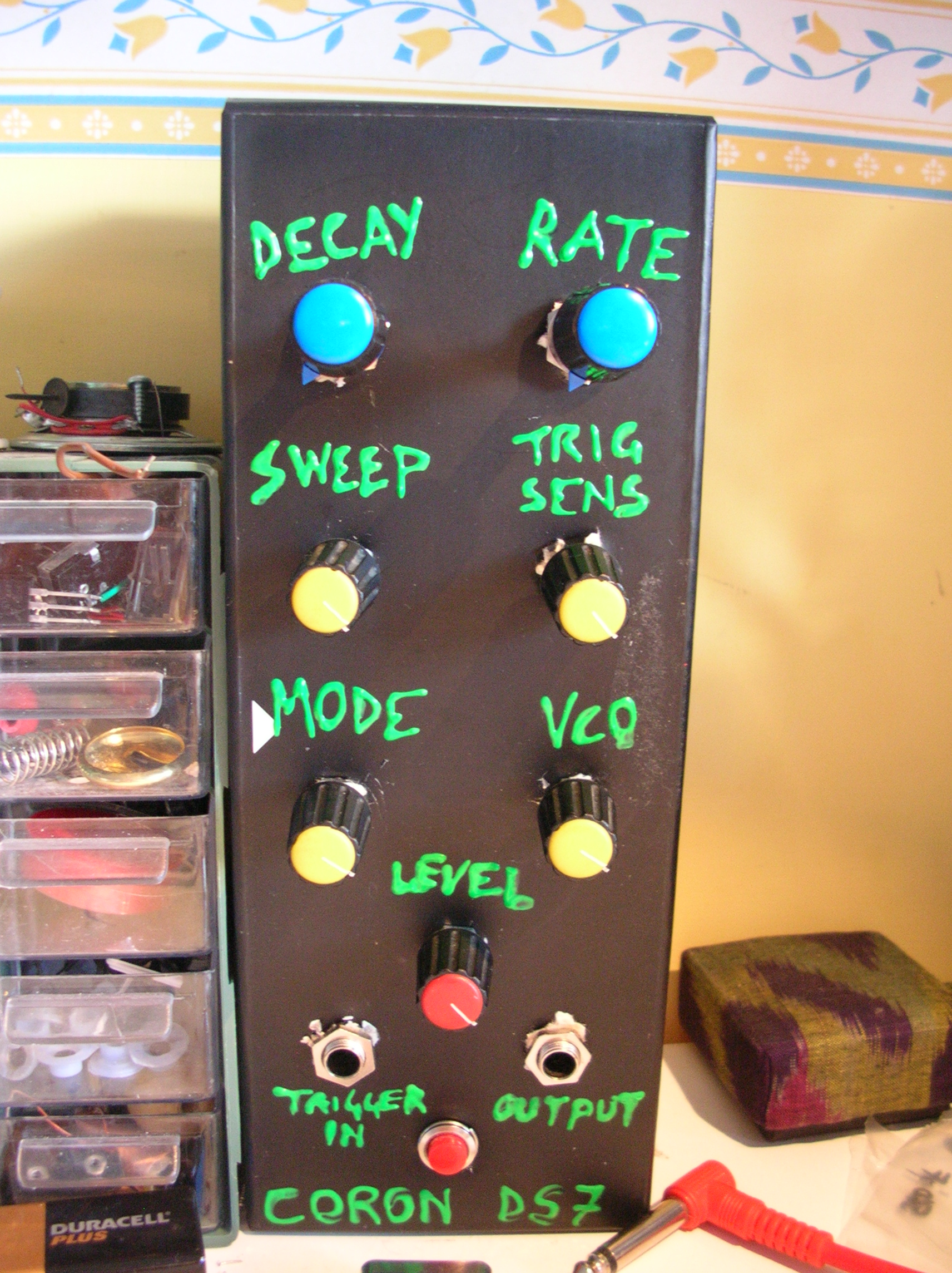

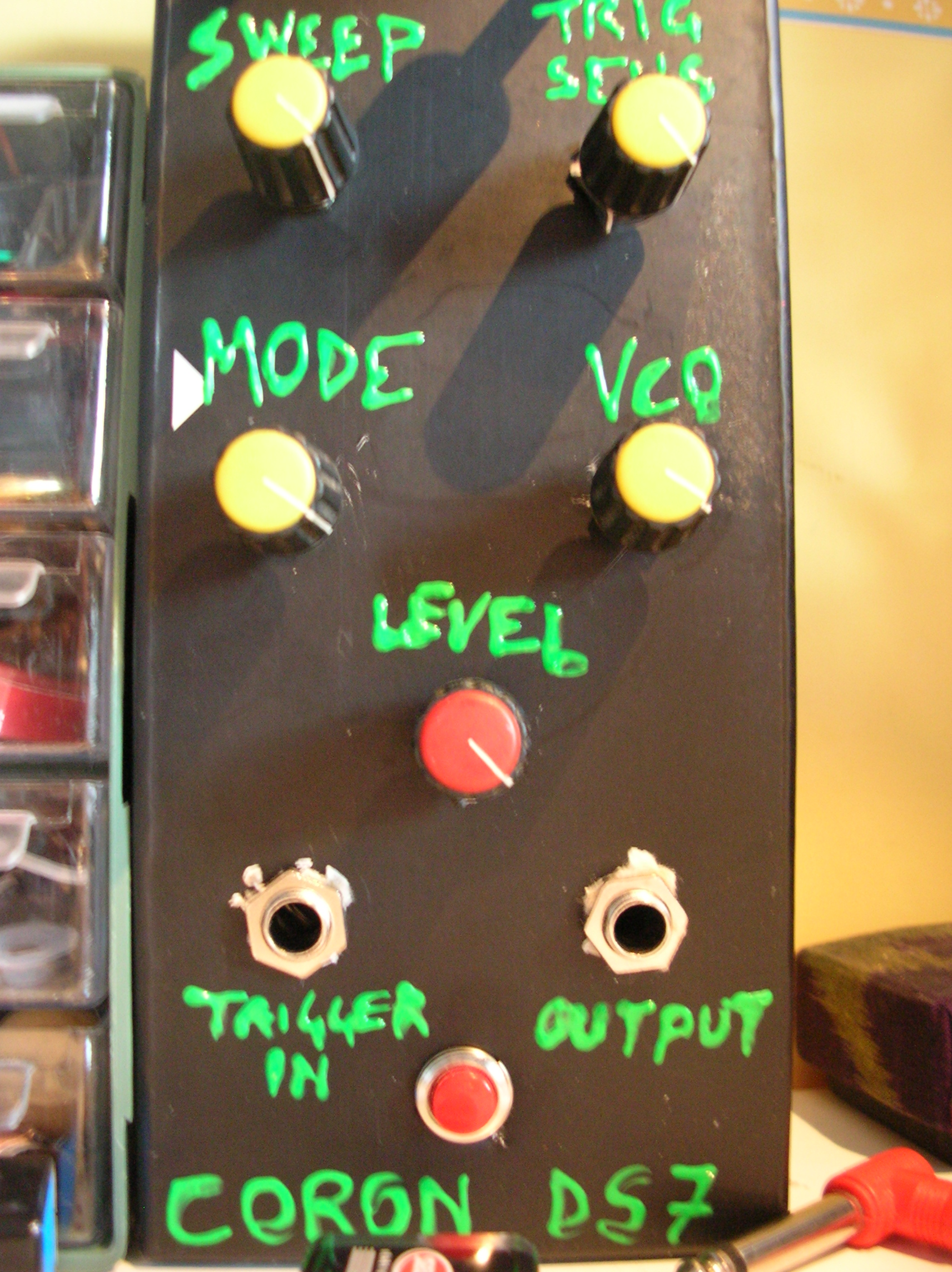

PostPosted: Mon Oct 23, 2006 4:12 pm    Post subject: Reply with quote  Mark this post and the followings unread
Yes!My DS7 clone is born. surprise It works ok and sound very "electronic".I'm ready to build another DS7...and another ....another....another....... Laughing
I have housed it temporarily in a cartoon case...and it looks to me very cool Cool
So....Thanx Dnny for this thread. Wink

EraSer
Joined: Apr 12, 2006
Posts: 82
Location: Italy
PostPosted: Mon Oct 23, 2006 11:54 pm    Post subject: Reply with quote  Mark this post and the followings unread
Thanx Pehr Wink
I've made text whit multisurface 3D colour.
dnny
Joined: Mar 12, 2005
Posts: 519
Location: Helsinki, Finland
PostPosted: Tue Oct 24, 2006 12:56 am    Post subject: Reply with quote  Mark this post and the followings unread
wow - that looks really nice - not that "lab gear"- look but cool in other ways banana and really nice that its working.
did you substitute the LM324 whit CA324 or HA17324?

EraSer
Posts: 82
Location: Italy
PostPosted: Tue Oct 24, 2006 1:10 am    Post subject: Reply with quote  Mark this post and the followings unread
Thank you Dnny.
Yes I've used these two different ICs like subsitutes of LM324 and DS7 sounds good. Very Happy
Just few questions to know how to use it better:
1) I have added momentary push button for the manual trigger mod:maybe I don't understand how to use it Embarassed .What do you think saying "you get continuos signal if you hold the button down"?
2)What can I put in VCA input?
3)I don't have intense changes when I turn VCO pot.Why?
dnny
Posts: 519
PostPosted: Tue Oct 24, 2006 5:09 am    Post subject: Reply with quote  Mark this post and the followings unread
balance wrote:
1) I have added momentary push button for the manual trigger mod:maybe I don't understand how to use it Embarassed .What do you think saying "you get continuous signal if you hold the button down"?
by signal i mean the sound of the "drum" - so when you push that button you should hear the sound - and when you release the sound should decay.
if you have some noise source plug it´s output to VCA input and you get "cymbal" or "hihat"-kind of sounds.
a radio tuned off channel works fine or you can input "any" audio signal. CD-player or such.. go experiment.
there is a problem in the main Oscillator. the pitch should change when you turn that knob. triple check connections and look for short circuits.
Hope this helps
daniel
www.koelse.org
flickr: cable porn group
