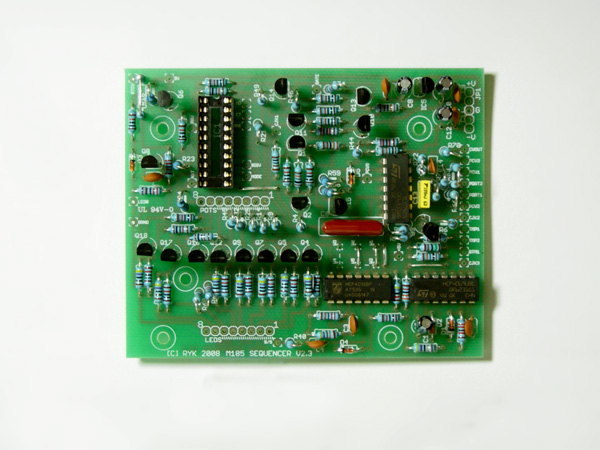

Hello
I have received the boards, and testing seems ok.
When I am done burning 100 PIC Micros [phew]
I will PM everyone who reserved the boards
with payment details.
thanks
-ryk

PostPosted: Mon Aug 18, 2008 3:35 pm    Post subject: Reply with quote  Mark this post and the followings unread
So amazing that all that functionality fits on such a small PCB!

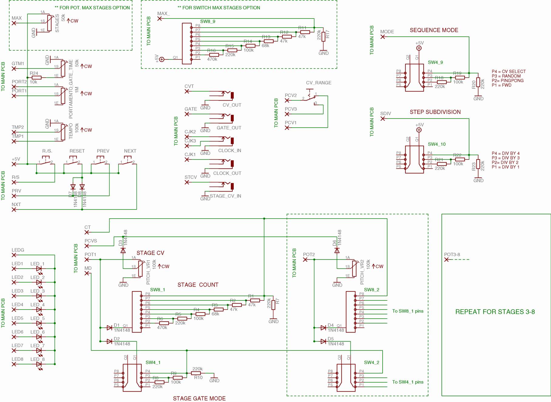

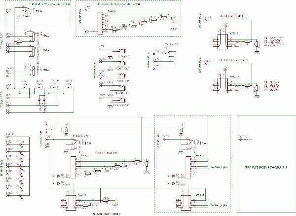

Funky40 wrote:
Its planned that i draw a PCB for those switches( like the alphas) , so one can wire those with Ribboncable as used for Euro Powerconnections.
Here is the wiring diagram for the panel components
which you might need.
It is fairly particular, but hopefully not too tricky.
-ryk

PostPosted: Wed Aug 20, 2008 4:55 pm    Post subject: New sequencer project Reply with quote  Mark this post and the followings unread
Note that you can also use a pot to select the number of repeats per stage, as the input on the micro is actually an A/D input. You don't get the distinct 'steps' you do with a switch, but it certainly simplifies the wiring (you don't need the switch and the resistor voltage dividers anymore). the truly adventurous might even want to add an external CV input for modulating this. :-0
Tim (doesn't have distinct 'steps' either) Servo
ryktnk
Joined: Apr 24, 2008
Posts: 285
Location: london
PostPosted: Thu Aug 21, 2008 8:39 am    Post subject: Reply with quote  Mark this post and the followings unread
Hello.
Yes, Tim is correct the switches can be replaced by 50k pots, like
the Max Stages option at the top of the drawing.
Please note tho, the resistors on the "stage" switches are only for the first
switch, the rest are all wired in parallel with this first switch.
I hope this makes sense.
-ryk
