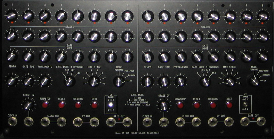

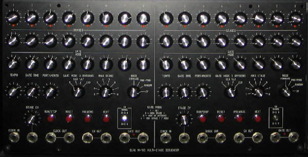

Here's a pic of my finished Dual version.

oh la la !
That looks great, and big.
Well done.

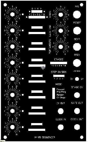

Here's my attempt at a panel for the M-185. It's not done yet, I'm just waiting for the hardware in the mail to make any last tweaks so that I can make sure it all fits Cool I'm not sure whether I should have a sub panel for the switches or just mount them directly to the panel.

It's My first try for the adaptation of the faceplate for Eurorack format :
http://www.themeloon.net/wp-content/uploads/2008/12/frontdesign-ryk-m185-sequencer.pdf
Of what do you think of it?
I added a modification, a gate out by step.
Have you an idea of cabling for this modification ?
Thanks Wink
PS : ->ryktnk : You have a HPGL file for your logo or FPD file of your faceplate ?

Hello del_poolp
The panel looks very nice !
But you have missed out a switch
and need to change the "mode" switch.
Have a look at the panel wiring PDF as there
is a 4-way switch for the sequencer mode [this
used to be random on/off on my old panel picture]
Also there is a new 4-way switch which is for the stage
subdivisions, sorry.
If you would like to add a "RYK" logo I can send
one over, very flattered !
cheers
-ryk

I have corrected my front panel Wink
Thanks, it's a same for my other module :
http://www.themeloon.net/diy/papareil-synth-labs-ds8/
http://www.themeloon.net/diy/papareil-synth-labs-mcv876/
http://www.themeloon.net/diy/papareil-synth-labs-polivoks-vcf/
Yes, send me your logo Wink (Look on bottom of my front panel)
For the mod (Gate out on each step), if possible, you have any idea for Wiring/Schema.
Bye,
PooLP

That dual version by The Alison Project looks great!
