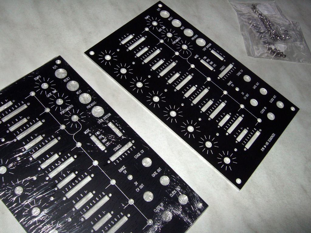

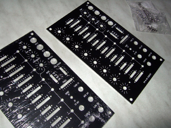

julian
Joined: Jan 11, 2008
Posts: 103
PostPosted: Wed Mar 02, 2011 7:26 am    Post subject: Reply with quote  Mark this post and the followings unread
Have uploaded the photo shown below. The forum is reducting it in size though, so you may need to click things to get it bigger (should be 1024 wide)
As previously mentioned, i have 2-off these (@GBP49ea.), and screw kits (if required@GBP4ea.)
They are slightly different from the panels i was selling previously in that they also have cut-outs for additional toggel switches and line work for the portamento mod. Otherwise though, they are identical to those cut before.
Thanks, Julian

nerdware
Joined: Jul 11, 2009
Posts: 91
PostPosted: Wed Mar 02, 2011 9:56 am    Post subject: Reply with quote  Mark this post and the followings unread
I have a PIC with the V2.1 firmware, so that'll be perfect. The panel nearest the camera appears to have blemishes, so unless that's just a camera artifact, I'd like the other one please.
Thanks.

julian
Posts: 103
PostPosted: Wed Mar 02, 2011 10:12 am    Post subject: Reply with quote  Mark this post and the followings unread
I know ive replied by email, but, just for the benefit of anyone else reading...
Both panels are actually identical, cut in the same pass, out of the same sheet of metal - i generally wrap jobs in cling film before packing them properly, and the atrifacts in the photo are just where the camera flash is catching on the film - nothing to worry about at all : )

nerdware
Posts: 91
PostPosted: Wed Mar 02, 2011 10:27 am    Post subject: Reply with quote  Mark this post and the followings unread
Aha, clingfilm. Of course. Phew! That's ok then!

emdot_ambient
Joined: Nov 22, 2009
Posts: 667
Location: Frederick, MD
PostPosted: Thu Mar 03, 2011 7:48 am    Post subject: Reply with quote  Mark this post and the followings unread
Uh...looks to me like those panels are for V2.0, not V2.1. Or am I confoosed?
nerdware
Posts: 91
PostPosted: Thu Mar 03, 2011 8:17 am    Post subject: Reply with quote  Mark this post and the followings unread
The panels have the Portamento pot and switches, but still refer to the CV stage selection. That's no problem, I'll know what that mode really does.
I may even find a use for the CV input, like transposition. I often wonder why so few sequencers have a transpose input. I've not seen any in the DIY world, and yet a unity gain summer appears to be simple enough - just a simple mixer using matches resistors. Anyway, adding that shouldn't make this project significantly harder. It already requires some extra components on a stripboard.

emdot_ambient
Posts: 667
PostPosted: Thu Mar 03, 2011 8:47 am    Post subject: Reply with quote  Mark this post and the followings unread
So with V2.1 you can use the portamento switches? I wasn't sure if that worked with V2.1.
The construction notes document for V2.1 only shows the daughterboard configured so that the portamento is programmable without the switches. For V2.0 there was the other option for doing it with switches (which actually I prefer because the function is then immediately available without pressin/holding a button).
I was wondering about a CV In offset function as well. Maybe the DIY developers don't put it in because it's a relatively easy mod?
nerdware
Posts: 91
PostPosted: Thu Mar 03, 2011 10:12 am    Post subject: Reply with quote  Mark this post and the followings unread
It had been a while since I last looked at the docs, but I just looked and you may be right. I can't find the port switches on the wiring diagram. Oh well, I can ignore those holes. A slightly odd panel is better than none at all!
I'm still a bit confused by the panel pics and fpd files - they don't appear to have the port switches, but they do have the stage selection stuff. Confused
[EDIT]
I just checked the pics again, and one of the panels is for the V2.1 firmware. Still no port switches for each stage! So these two panels here are odd hybrids. I don't have an FPD for V2.1 anyway, so I can't complain. Odd still beats nothing.

julian
Posts: 103
PostPosted: Thu Mar 03, 2011 10:21 am    Post subject: Reply with quote  Mark this post and the followings unread
Two software versions -
v2.0 -
Has a CV input for CV stage select. The "Mode" slider is marked with "CVS" for, well, cv stage select : )
v2.1 -
Has no CV input. The "Mode" slider is marked with "FXD" for fixed.
...but, in that, it seems that 2.1 is a reduction on the features of 2.0, whilst 2.1 was actually a later release. So there must be more to it than that, but thats what i remember.
The two panels above were both cut for the v2.0 software, but the person who they were originaly cut for wanted the portamento toggels included.
The panels are not cut from the fpd files that were floating about, so dont expect a direct comparison. I, personally, wasnt happy with the fpd files, so, although its the same basic layout, i redrew the work in my usual CAD application from scratch when i started making the panels for this project.
