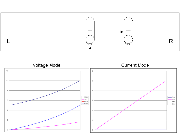

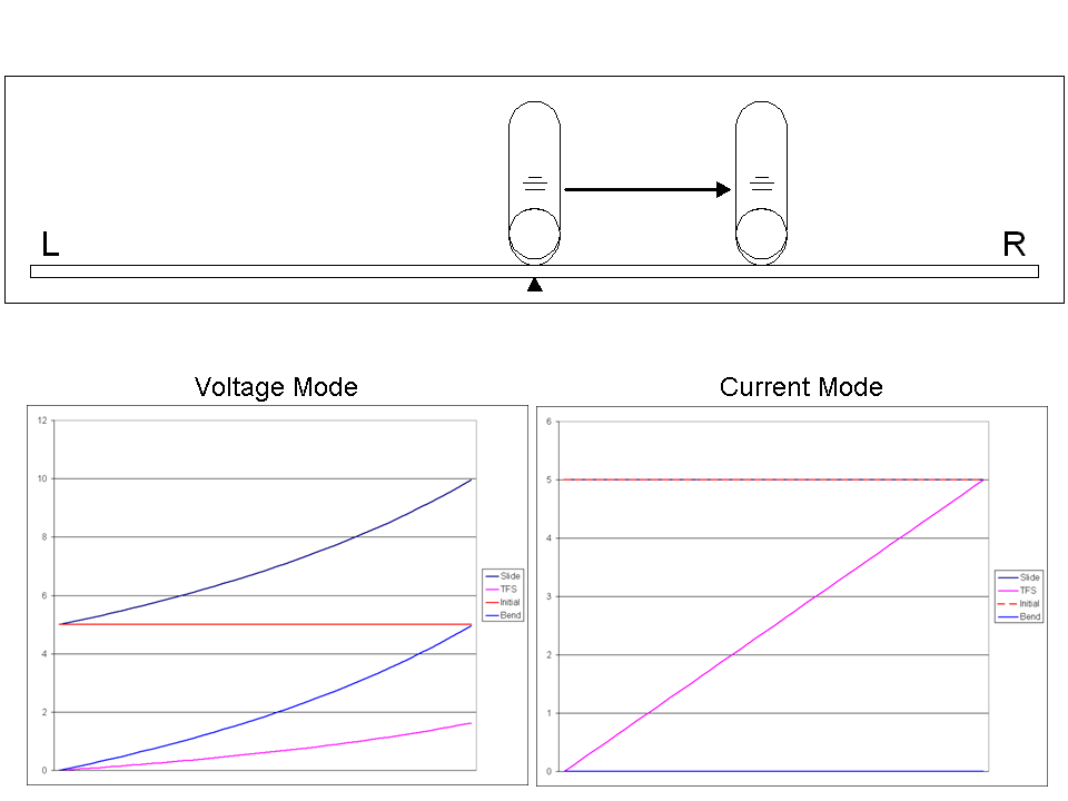

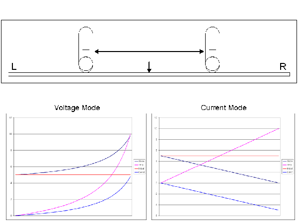

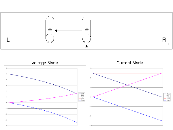

PostPosted: Mon Oct 06, 2008 1:34 pm    Post subject: Reply with quote  Mark this post and the followings unread
It's proving to make a nice complement to the Klee - it's fun to feed the Klee external range with it, or to pipe the Klee into the external signal input, or modulation input.
Here are some voltage graphs of two pressure point voltages (IE, using two fingers). The single pressure point response between voltage and current mode is the same - linear positional voltage on slide, linear bend voltage, 0V TFS, with initial voltage reflecting the initial point of contact.
However, once you apply two fingers, the differences are rather profound, and created a huge internal conflict with me as to choosing which method to use. I finally decided on my standard "cake and eat it, too approach" because there are so many advantages of one over the other.
These graphs only show a few instances - things vary considerably for voltage response, depending on where you start and end up. These graphs just concentrate on what happens when starting from the middle.
Center_Spread.png shows the response when starting at the middle with two pressure points and spreading both fingers out to the ends of the ribbon.
Middle_Down.png shows the response when starting at the middle, and moving the left finger down all the way to the end while keeping the right finger in the middle.
Middle_Up.png shows the response when starting at the middle, and moving the right finger up all the way to the end while keeping the left finger in the middle.
As can be seen, the responses between voltage and current mode are pretty interesting. It's not obvious from the graphs what some of the implications are (particularly when mixing voltages or when controlling things from TFS), but I guess some were interested in the response curves. You can see why I like to think of Voltage two finger operation as "West Coast" and Current two finger operation as "East Coast". Current is all straight lines and linearity, A to B, and Voltage likes to take the scenic route....
Just like music....
 Filesize:  36.3 KB
 Viewed:  217 Time(s)
 Filesize:  35.85 KB
 Viewed:  231 Time(s)
 Filesize:  30.1 KB
 Viewed:  233 Time(s)
