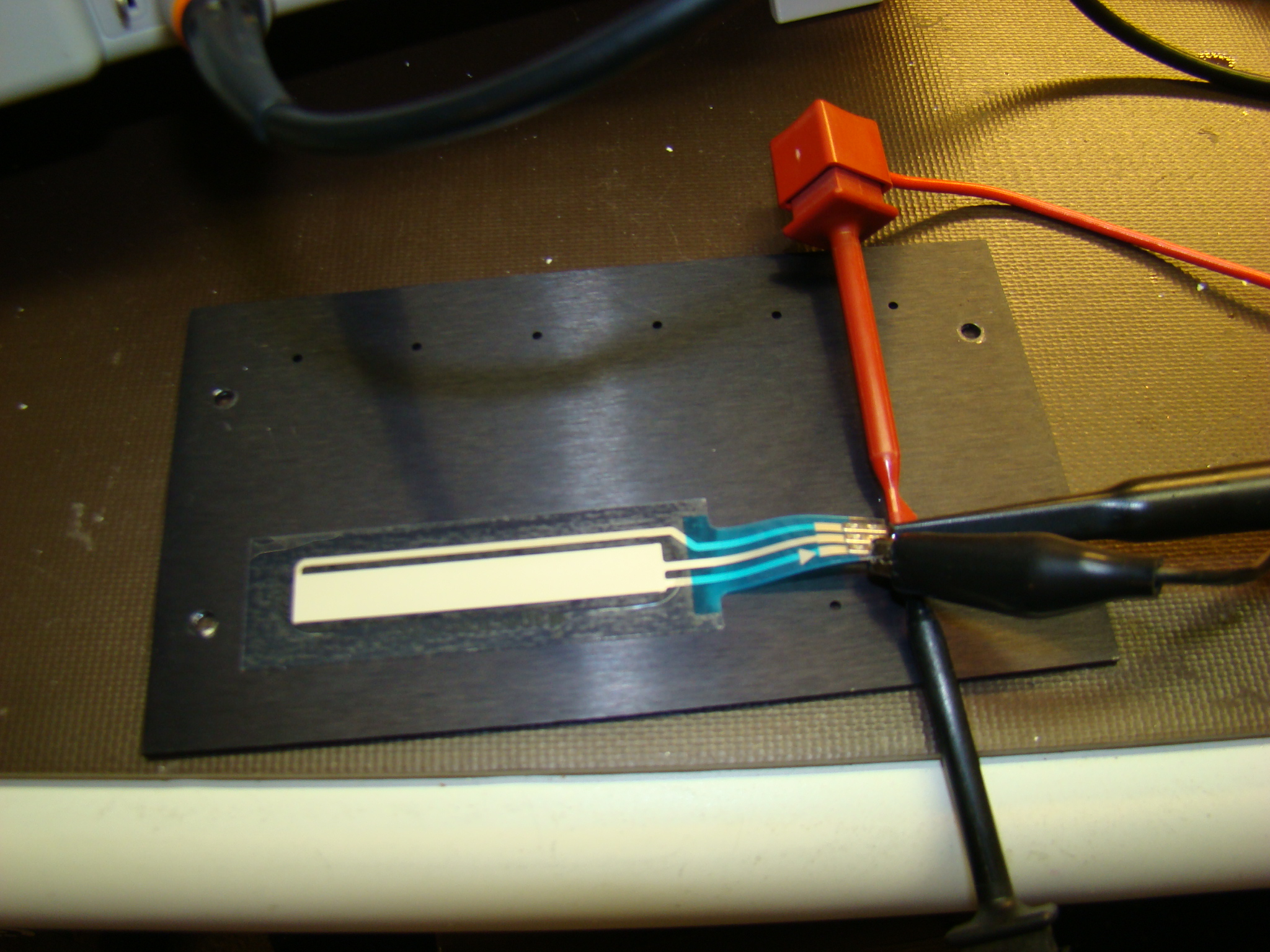

I tested a 50 mm softpot this evening just to see how it behaves. The fourth picture below shows how I mounted it. I think it's very important that these get mounted to a firm surface. These pots had an adhesive backing so you can stick them anywhere. I chose a blank metal plate. I biased the pot with a 10V power supply and attached the scope to the center wiper as shown in the last picture.
IMAGE 1 shows a typical release with a worse case bounce of about 100 milliseconds. The interesting thing here is that no bounce ever goes beyond about 200 millivolts so you can reference a comparator to 300 millivolts and get a clean pulse just about every time. A Shockley diode reference would work fine for this.
IMAGE 2 this image shows the lead edge bounce which is never as great as the trail edge bounce. Again, I had repeatedly pressed the softpot and never got anything higher than about 200 +/- 10 millivolts.
IMAGE 3 this image shows an interesting property of the softpot and that is, it's pressure sensitivity [spelling wrong in the image]. This oscillograph shows a press for about 2 seconds. During this time I press the pot surface, I vary the pressure with my appendage while the graph reveals about a 6 semitone span when driving a 1V/Octave VCO. Thus, the softpot is pressure sensitive. The one thing to watch is that the harder you press, the lower the voltage so an oscillator would lower in frequency. This could make for some nice vibrato effects though.
Hope some of this information helps others ........

Thanks Bill! 200 ms of bounce was what the problem was getting a good voltage with my first go. Mine is not glued to anything, and I imagine a portion of the bounce I'm seeing is just that. I don't have a decent surface yet to put it on (my brother is preparing a nice chunk of walnut for me) and there's really no good way to tack the things down otherwise.
And pressure sensitivity - you're right again. Generally it gets more obvious towards the high end. It does make for a nice vibrato; so does rolling the finger on the Softpot. One has to take care with held notes with enough pressure to bend the note and suddenly releasing - it'll cause a bit of a shift. In fact, I thought "WTF? Why is that happening?" 'til I measured the voltage coming off the ribbon itself. It's a neat effect once one prepared for it though...kinda Asian music sounding if you do it right.
And, oh, my, my circuit is working just as I wanted it to - rock solid, responsive, and fun. I'm going to love this new addition to my synthy family. I think I'm going to put an extra voltage input to it as a substitute for the voltage at the top of the SoftPot - just insert an LFO and control the level with the Ribbon controller, for example.

Great work guys! This is getting really interesting. I used to play cello a bit and have always wanted to try some kind of monochord.
Interesting that the "bounce" actually looks more like a small ringing. In fact, unless my eyes are failing me again, it's at exactly 60 Hz! Maybe there could be an easier way to get rid of it. This makes more sense to me, because it is a bit difficult to see how a squishy polymer would bounce mechanically like a switch.
The pressure effect. You might want to check whether the pitch shift is merely due to a length change caused by your finger squishing out or an actual property of the polymer. Maybe push with a stick or something?
I think that's certainly what I'm seeing. If I play it with the soft edge of my long nose pliers, the effect is not nearly so pronounced. The data sheets always mention a stylus of some sort, which at higher ranges (voltages) makes playing the thing more precise. One of those ball point styluses....styli?....would be handy to have around.
Yes, "ringing" would be a more accurate description of it. I'm wondering: this is a very long, very, very thin layered tape. A conductor on one terminal and a resistive strip on the other terminal, separated by a very thin dielectric. Doesn't that pretty much make the thing a giant capacitor? The strip I'm working with is 500 mm.
Yes, it's more like ringing than it is "bounce" I will go back and measure the frequency of this ringing effect. Very good observation Ian Cool
Oh yes, right. Another very good observation Cool I will press using both a blunt metallic object and a non-metallic object to make observations on the ringing and pressure sensitivity effects. This will further characterize the softpot behavior. My guess it's due to the finger "squishing out" effect that gives the appearance of being pressure sensitive. Either way, however it's derived, it is sensitive to pressure simply because your finger, or other appendage, deforms Very Happy
I will report my results .........
I do want to point out that these softpots would form the basis of a very nice analog trigger pad for electronic drums. The are not so sensitive that they false trigger all the time and they have just the right amount of sensitivity to even be great for "finger" drumming !!!! The oscillograph below shows the response of some finger tapping along the length ofhte softpot. I am impressed with the response and will inspire me to do more with these. This would make a great trigger pad for hte UD-1 or MPS drum voices !!!
Bill

More observations ........
The pictures below prove that a) the material is not pressure sensitive. Something we all sort of concluded before I did this little experiment. A point contact with the pot using the blunt end of a dental tool, while applying varied pressure, does NOT change the output voltage.
b) the ringing is indeed 60 cycle, and would be most like 50 across the pond Wink The ringing is due to most likely a capacitive coupling between the finger and potentiometer.
c) ringing is close to being eliminated when using a non-metallic stylus to put pressure on the softpot.

Sounds great , Scott. No extra or missed triggers -- very robust.
Scott Stites wrote:
Yep, having the gate and trigger outputs really expands the uses of it. It doesn't re-trigger (ie produce a new trigger when the note changes), but it does trigger/gate every time you apply the appendage.
So if you hold one appendage down and trill with another you don't get triggers? Or if you put down four appendages sequentially only the first generates the trigger?
On my wind controller I have two kinds of triggers -- one when you start a note by tonguing and another when you change fingerings (slurred notes). You could do something similar. The triggering you have would be like tonguing and you could add a differentiator (there he goes again) which fires a trigger when the voltage changes faster than a certain rate. So it wouldn't trigger while gliding, just when you slap down a new appendage.
Another idea would be to add a force sensor (maybe under the strip), to give you a touch sensitivity.
Just some thoughts based on things I've done, and of course you have your own requirements. But I think this little strip could be very expressive.
Ian
Scott Stites
Joined: Dec 23, 2005
Posts: 4127
Location: Mount Hope, KS USA
Audio files: 96
PostPosted: Mon Aug 11, 2008 8:55 am    Post subject: Reply with quote  Mark this post and the followings unread
Right - just one trigger until all appendages are removed than applied again. This was how I originally envisioned a ribbon controller to work.
After playing with it a while, I can see where one would want to re-trigger with trills. Maybe not all the time (and re-triggering could be defeated under those circumstances), but re-triggering would certainly expand the expressiveness greatly when one wanted that sort of action.
Absolutely quite welcome - I just wasn't sure how one would do re-triggering, but your suggestions show how it could be done.

i especially like the relative output idea.
I think it's certainly doable. Use a S&H for note on reference and run that and the tracking S&H into a differential amplifier. I worked it out briefly over lunch, with several options of when and how to return to zero volts.
For example, if you're using a keyboard and you're actually bending notes rather than applying vibrato, you might want to bend up to a played note. The return to zero (no offset) of the relative output could reset to zero from the trigger signal of the keyboard.
You may want to return to zero when the keyboard gates.
You may want to return to zero just when you lift the...appendage. This would be sort of like a spring-centered control wheel.
I had fun working through the logic for any/all of these settings.
"Zero" itself wouldn't be all that difficult, even if there is S&H droop - zero would simply be setting up the reference S&H to track the tracking S&H. Since they're moving together, they should cancel each other out in times of zero.
you guys are talking about your nose, right?
But, of course!
ok, so i think you better just start calling this device "the appendage"
Good idea. It sure beats the hell out of "The Finger". Laughing

Scott, the sample certainly exemplifies the expressiveness attainable with this controller. The gate/trigger seem to work in flawless fashion Very Happy
I really like this idea quoted below for the "duophonic" effect. This can turn out to be a very feature rich module if you wish to continue adding these sorts of features. Problem is, there are so many great ideas floating around, deciding which to pick may be the hardest part of the project. Wink I do think that adding the BAR/DOT driver will add some nice "flash" to the project. I wonder if the softpots can be backlit?
In fact, this morning I was thinking it wouldn't be too far of a stretch to make the gate/trig/CV outputs alternate between a set of jacks, which would allow notes to overlap - it would be sort of a duophonic effect, or triphonic, etc., depending on how far you wanted to go with that.
Bill
Scott Stites
Posts: 4127
Audio files: 96
PostPosted: Tue Aug 12, 2008 10:52 am    Post subject: Reply with quote  Mark this post and the followings unread
I imagine if you laid the softpot on Plexiglass with LEDs underneath, it would show through. It'd probably look pretty cool, I imagine.
For me the bare minimum features would be a range control (to set the range of the ribbon) and perhaps an octave select, much like on keyboard. I've got a simple range control right now, but no octave select (yet).
The differential output is high on my list - seems I saw someone using a ribbon controller on a synth (maybe it was a CS80, dunno) that seemed to bend the notes the same, regardless of where the ribbon was touched. I'd find that immensely useful, myself, when using it as a modulation controller.
Ian's re-trigger idea has me by the short hairs, too. It's something I definitely want to try out and see if I can make it work, though I'll have to futz with it a bit, not having really worked a lot with differentiators (at least for figuring out how fast a signal moves). That will be educational for me, as well as fun.
I need to reduce the block diagram and complexity of the circuit, too. Right now it's overly complex, because the ideas sort of overlapped, and there are a few stages I think are unnecessary. Mainly the debouncing/edge detector. I think the comparator is solid enough to do its thing without that. I'll have to work with it a good while to make sure it actually doesn't make any difference when I take those sections out. I did pull the timing element out of the debouncer last night, and it didn't seem to make a bit of difference, which is a big clue that it's not necessary.
I've got a feeling I'll be off to Malaysia again, soon, so I'd like to get as much done before that as I can.
