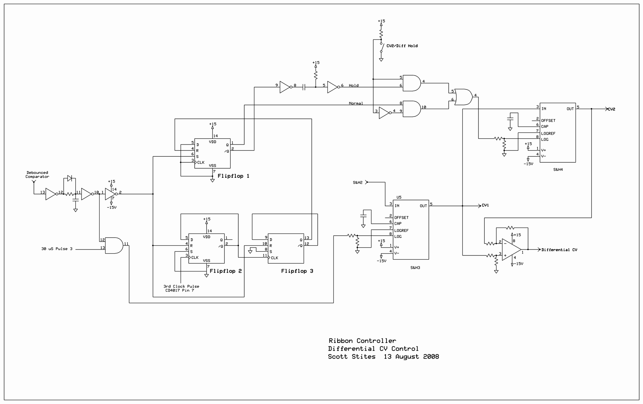

There are a number of opportunities to make this thing a really versatile instrument. Hopefully it can provide a lot of versatility, yet remain fairly easy to set up and use.
The greatest power, of course, is that it provides a simple control surface with which to generate and control output voltages and synchronization. Right now, the number of unique unique simultaneous control voltages it produces is nine (not counting some inversions or signal input mode). Differential voltage really let the cat out of the bag - six of the control voltage responses were derived from that function.
Right now I'll try to describe the three main generated voltages from which all the others are derived:
1. Continuous Positional Output Voltage. While moving up or down the ribbon, the voltage tracks the position. When pressure is released, the voltage retains the last positional voltage that was generated before pressure is released.
2. Fixed Positional Voltage (CV2). Each time pressure is applied, the initial positional voltage is sampled and held. While retaining pressure on the ribbon and moving the appendage up or down on the ribbon, this voltage does not change. Its action on release depends on if "hold" or "normal" is selcted. If "normal", the fixed positional voltage will go to the last positional voltage sampled by CV1 before pressure is released. If "hold" is selected, the voltage will remain unchanged until the next pressure is applied, whereupon it will sample that initial value, and the process repeats. Mixing differential voltage with this voltage will provide a means of sliding or vibrato.
3. Continuous Differential Voltage (Diff CV). When the ribbon is first pressed, this output is at zero volts. When the appendage slides "above" the original point of contact, while pressure is applied, the differential voltage will rise (positive) relative to the original position. When the appendage slides "below" the original point of contact, the voltage will fall negative, relative to the original position. For pressure release, like CV2, its behavior depends on if the "Hold" or "Normal" mode is in effect. In normal mode, the voltage will return instantly to zero (if it's at some non-zero value) when pressure is released. In hold mode, it will lock to the current value when pressure is released. In that case, when the next pressure event starts, it will return to zero volts, and the process will repeat.
I've uploaded a block-like schematic of what I have working so far (it all works as of this writing).
All three voltages are derived from manipulation of two different Sample and Hold's - S&H3 and S&H4 (S&H1 and S&H2 are part of the analog shift register responsible for grabbing stable voltages for S&H3).
Starting with note off - the comparator is low. Flipflop 1 Set input is high, so Flipflop 1 Q output is high.
If the CV2/Diff Hold switch is closed, this high signal is transferred straight to the S&H4 clock input, which allows it to track its signal input, which is fed from the output of S&H3. The output of S&H3 and S&H4 are therefore at the same potential, so there is 0V differential - the Differential CV is 0V. CV1 and CV2 are at the same potential as well - which would be the last voltage sampled by S&H3.
If the CV2/Diff Hold switch is open, the clock input of S&H4 is low, so it is holding the last sample it took - which was the voltage initially loaded into S&H3 at the initial press of the ribbon the last time it was pressed. The differential voltage will be the value of S&H3 voltage plus or minus S&H4 voltage.
In this state, the reset pin of Flipflops 2 and 3 are held high, which holds their Q outputs low, and /Q outputs high. Because they are held in reset mode, they ignore the clock pulses coming from the third output of the CD4017, which is used to sequentially clock the first three S&H's.
When the ribbon is pressed (note on) Set goes low on Flipflop 1. The Q output does not go low yet - it's waiting to be reset by Flipflop 3.
At the same time, Reset on flipflops 2 and 3 also goes low. This allows Flipflop 2 to be clocked by the third sequential clock pulse from the CD4017. These two flipflops form a divide by four counter. This is intended to give S&H3 plenty of time to acquire a stable voltage before its output is sampled by S&H4 (by plenty of time, I don't intend to imply observeable latency - there is no apparent latency).
At the rising edge of the fourth clock pulse, Q of Flipflop 3 goes high. This resets Flipflop 1, which brings its Q output low and its /Q output high. When /Q goes high, this initiates a pulse that is blocked by the switch's action on the AND gate feeding the summing OR gate on the input of the S&H4 pulse input.
If the CV2/Diff Hold switch is closed, S&H4 been constantly tracking S&H3 already. When Flipflop 1 Q goes low, this locks the current voltage on the ouput of S&H3 into S&H4. The voltage on CV2 is now fixed at this same voltage (because CV2 always reflects the contents of S&H4). As the appendage is dragged up and down the ribbon, S&H3 voltage varies and so does the differential CV output, because its output is added and subtracted with the fixed output of S&H4.
If the CV2/Diff Hold switch is open, S&H4 been holding the initial voltage value recorded when the ribbon was first pressed on the previous note - it hasn't been tracking S&H3. When Flipflop 1 /Q goes low, this creates a sample pulse that "locks" the current voltage on the ouput of S&H3 into S&H4, creating a new initial note voltage. CV2 puts out this same voltage now. As the appendage is dragged up and down the ribbon, S&H3 voltage varies and so does the differential CV output, because its added and subtracted with the fixed output of S&H4. The voltage on CV2, which is S&H4s output voltage, remains fixed at the initial voltage of S&H3 when the pressure was first sensed on the ribbon.
Once again pressure is released. If the switch is closed, S&H4 locks the last value of S&H3 onto its output. This causes the differential to snap back to 0V (if it was at some other value) and causes CV4 to snap to the last positional voltage recorded by S&H3.
When pressure is released and the switch is open, S&H4 does not take another sample of S&H3 and remains fixed at its current voltage, which was the initial note voltage recorded when the ribbon was pressed. The differential output stays at whatever value it was at when the ribbon was released - it will only return to 0 at the start of the next note.
Cheerios,
Scott

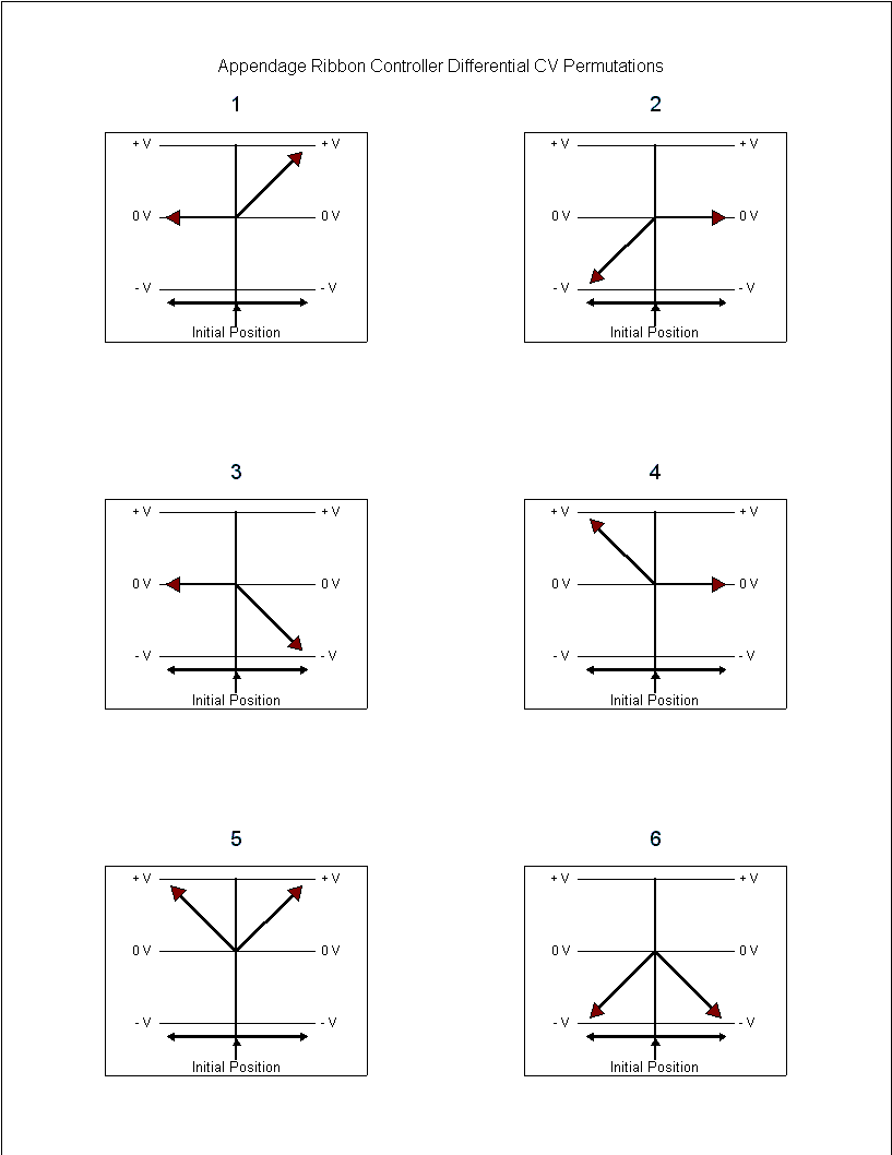

Here's a diagram of the six control voltage permutations I mentioned in the previous post.
The bottom of each graph illustrates that the initial point of contact is always 0V. This can be anywhere on the ribbon controller, not just the center. The horizontal line at the bottom shows the direction of movement on the ribbon cable while applying pressure after the initial contact. The graph above shows the direction of travel and polarity of voltage on each CV output as the appendage slides up and down on the controller from the initial contact point.
This is not just kitchen sinking for kitchen sinking's sake - I've tried these out, and they can have some very profound uses. Take number 5 for example: say you are using CV2 (fixed initial note, no slide) and you're using a slide control out to control filter cutoff. If you hit a note at the upper end of the ribbon, you don't have any more room to slide up. However, you've got plenty of room to slide down, which will also open the filter just as sliding up from the initial point of contact will do (and sliding back up to intial will close it back down). In fact, playing this really opened my eyes to how musical opening a filter on oscillator slides going up and going down is. I used the continuous output to slide a VCO, and the number 5 output to control the filter cutoff. The initial note is darker - as the note slides up, it gets brighter (as is normal). Sliding back down also opened up the filter for some gnarly bass.
This arrangement is also very, very good for smaller ribbon cables that would be used as controllers (like a pitch or modulation wheel). In that case, you could view it as sort of a one axis JAG. Very Happy
Cheerios,
Scott
Differential CV Permutations
 Filesize:  12.25 KB
 Viewed:  263 Time(s)

If one were to set up a selector switch to a mix input from any of the differential permutations, that would allow one to set the response of CV2 to any slide response one wanted for that CV.
1. Normal: Fixed initial, no slide
2. Slide 1: Left slides down, right slides up
3. Slide 2: Left stays fixed, right slides up
4. Slide 3: Left slides down, right stays fixed
5. Slide 4: Left slides up, right stays fixed
6. Slide 5: Left stays fixed, right slides down
7. Slide 6: Left Slides up, right slides up
8. Slide 7: Left slides down, right slides down
Then, of course, one could invert the selection. This would bring in the "left slides up, right slides down". Very Happy
Taking it a step further, one could provide a selector switch for CV1 that did sort of the same thing, though CV1 slides naturally. By sort of, I mean the responses would be different yet again (because of summation and subtraction).
Going in the same order, the permutations would have this effect:
1. Left slides down, right slides up (normal).
2. Left slides down at twice the rate and right slides up at twice the rate.
3. Left slides down at normal rate, right slides up at twice the rate.
4. Left slides down at twice the rate, right slides up at normal rate.
5. Left stays fixed and right slides up at normal rate.
6. Left slides down at normal rate, right stays fixed.
7. Left stays fixed and right slides up at twice the rate.
8. Left slides down at twice the rate, right stays fixed.
This could be inverted as well. In that case, inverting the response of the permutation as it's mixed in would cause number 2 to create no slide at all.
Reason I mention this is I've got a cool patch running that has a high oscillator controlled by CV1 and a low oscillator controlled by CV2, only CV2 now slides up left or right. The interplay is cool. Cool
This stuff could go on forever, you realize......

I took a break from the Appendage BB on Sunday, for the most part. Yesterday I moved the main gate/trigger stimulus to the output of the divide by four counter. I noticed that synchronization with differential and its permutations would cause a 'knock' on the first new note if there was a wide gap (when using differential CV to modulate something). That's now fixed.
I recorded most of the breadboard circuitry yesterday, with the exception of the trigger generators and differentiator values. I need to re-organize the breadboard - it's crowded with a lot of unused stuff. I killed a CD40106 yesterday because of that, so I'm documenting it as it is now.
Having said that, the schematic is really not all that complicated. There are a few things I want to try to enhance it a bit more.
One of the things that makes it rather difficult to use yet for some aspects of pitch control is that the pressure (area of finger) laid on it will cause the pitch to shift. For pressure-related vibrato, that's pretty nice. For trying to end a held note at a specific pitch, it can be a bitch - it very easily can drop as the finger is removed. Part of it is due to technique - how one removes the finger, for example, but I think it could be made easier. Tapping the finger for short staccato notes doesn't incur this particular wrath, BTW. CV2 is immune as well, as it grabs only the initial pitch value (unless, of course, it's mixed with differential voltage to provide a slide).
The softpot is very sensitive, and there's a fine line between enough pressure and no pressure. It's fairly difficult to unflatten the finger enough to get the desired ending pitch without inadvertently triggering another note. What I plan to do is create a release time on the order of milliseconds - if when releasing the pressure, there are brief openings and closures, it will not produce a gate/trigger event, but instead just update the sample and hold. After a certain amount of time expires (unnoticeable during normal play), then it will accept a new note. This (I think) will make it easier to gradually withdraw pressure (unflatten the finger) to end with the desired pitch during slide play.
It would be very easy to add a "hold" switch - a momentary switch that ensures the pitch you're at will not deviate, no matter how you remove the finger. That breaks my philosphy of having this a one appendage device, but, at the same time, would be a very simple thing to operate.
I have another line of attack planned as well - this will serve to make pitch deviation on release an easier thing for fast, heavy play. As mentioned before, mixing differential voltage with CV2 causes a very nice, controllable slide. CV2 itself is fixed at the initial value when pressure is applied - the differential voltage slides it up and down past this point. The idea is to be able to modify the differential voltage to have a certain space between upward and downward movement where the voltage doesn't move at all. This would have the effect of placing the finger on the ribbon, then having a "null" spot of variable width. This null spot would be at the initial note value. Sliding up past the right side of the null would raise the pitch, sliding down past the left hand side of the null would lower the pitch. This would keep pressure deviation from happening at the initial note value (though that would go away once one slid past the null). Better still, though, it could provide a nice, more easily nailable point to slide to. Say you enter a note, slide up, then want to slide back to that original note. This would make that very easy to do.
On the kitchen sink front, I think it would be entirely possible to turn the single axis ribbon output to a dual axis output. Left finger would provide an output and right finger would provide a separate output. Sort of like a two axis joystick split out on a single axis. But, that comes later (it will require a bit of re-tooling of this idea, which I want to thoroughly wring out first).
