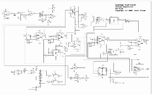

This would reduce the count by one 14 pin IC.
Seems like a point of diminishing returns to me. Not even worth it to rid the circuit of a single IC.
Bill

I found this video on You Tube of Scott's escapades with his new toy:
Hey! We said no video cameras allowed!
Normally I wouldn't bother, but in this case I think it's worth it for a few reasons. For one thing, I can spot two redundant inverter stages. Another thing is the 4093 is a vestige of my first attempt - I was experimenting with gating the clock, so it started out as a gated clock. Right now that one IC is performing two functions. A 40106 could perform the same functions with two spare remaining inverters. The clock doesn't need that much drive, because it's going to only one destination.
But the main reason is the intended purpose of the circuit - it's not only intended to drive a 500 mm SoftPot as a ribbon/touch performance controller, but also any size of SoftPot that could use this board as a mod wheel type of controller (situated next to the keyboard, etc.) or any other application where a SoftPot can be attached. In other words, one may want to put two or more of these into a controller. The unnecessary space taken by just one IC could make way for a quad op amp which will give some leeway in the CV processing portion, which isn't going to be very small.
The CV processing linearizes the response, smooths the 200 mV S&H spikes out of the slide CV, scales all of the CVs in as many ways as room allows, cross-mixes the CVs, and applies external modulation to the CVs (a very cool thing I'll have to make a sample of).
As an example, Ringer had a great idea of using 13 of these as a polyphonic touch controller. His idea had never occurred to me, and really trips my trigger. He was thinking vertically (I've been thinking horizontally).
His idea is to have thirteen of the smaller softpot ribbons situated vertically in a row - each softpot is a "key" of the controller. One could control pitch, amplitude, bend, triggering, and gating with each key (not to mention any other voltage controllable, gatable, or triggerable parameter) - sort of on the scale of a Buchla-type touch controller, only this one is resistive instead of capacitve. To do that effectively, it would be nice to have an adjustable breakpoint on the slide CV - a space at the bottom wide enough to always start at zero and move up to 5 or 10V at the top for controlling, say, a VCA. That takes a bit of extra opampage, so that space freed up will allow that functionality to be there should it be needed. With that many boards, every mm saved would be nice for cramming them into a chassis. So size of the PCB is of paramount concern to me.
Cheerios,
Scott
My Site

PostPosted: Wed Sep 03, 2008 11:24 am    Post subject: Reply with quote  Mark this post and the followings unread
Yipes - musta miscounted. Count is 14 ICs with the changes.
Here's what I'm shooting for - the changes clean things up a bit, leave no unused gates, and make the schemo a little easier to grok.
U1 CD4017
U2 CD40106
U3 CD40106
U4 CD4081
U5 CD4013
U6 7556
U7 LF398
U8 LF398
U9 LF398
U10 LF398
U11 LF398
U12 LM358
U13 TL074
U14 TL072
Last night I added the inverters to the 7556 inputs and put in the 4081. Haven't done the re-do on the trigger or the CD40106 clock, but they should work fine.
Cheerios,
Scott
Rev 0.28
 Filesize:  183.16 KB
 Viewed:  413 Time(s)
My Site

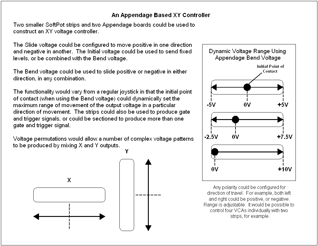

Here's an idea for an Appendage based XY controller.
Appendage XY Controller Application
 Filesize:  21.39 KB
 Viewed:  286 Time(s)
My Site
