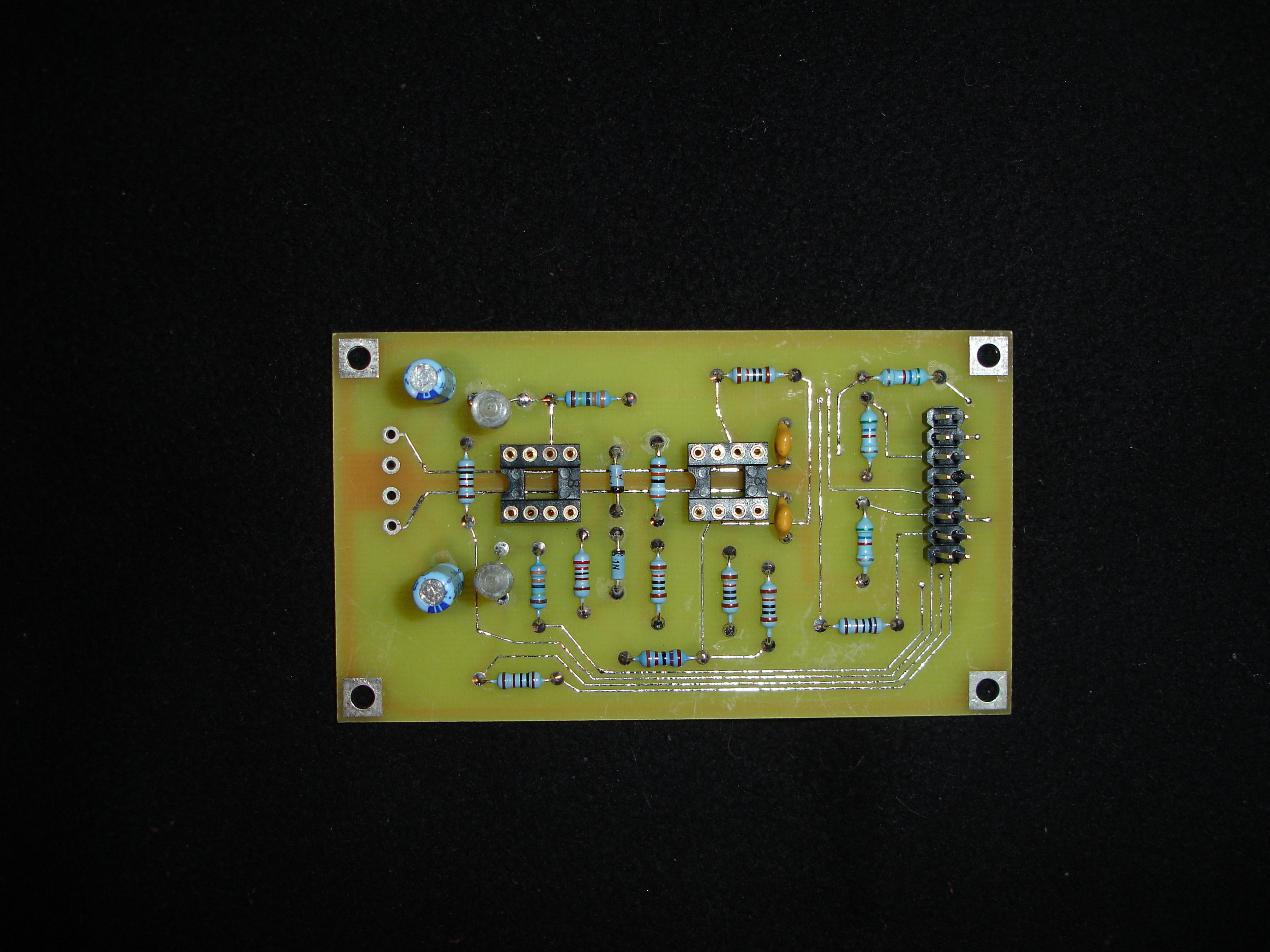

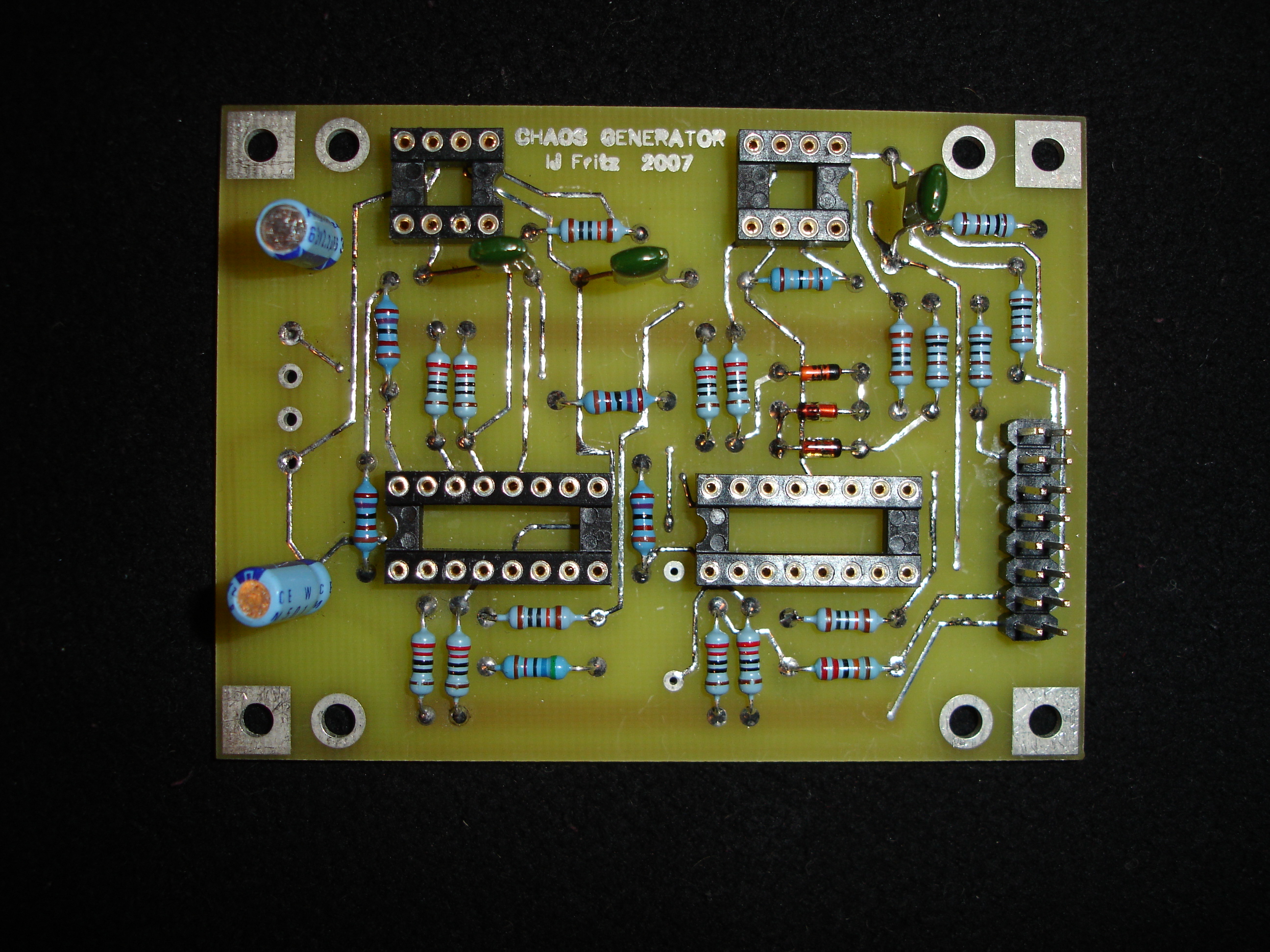

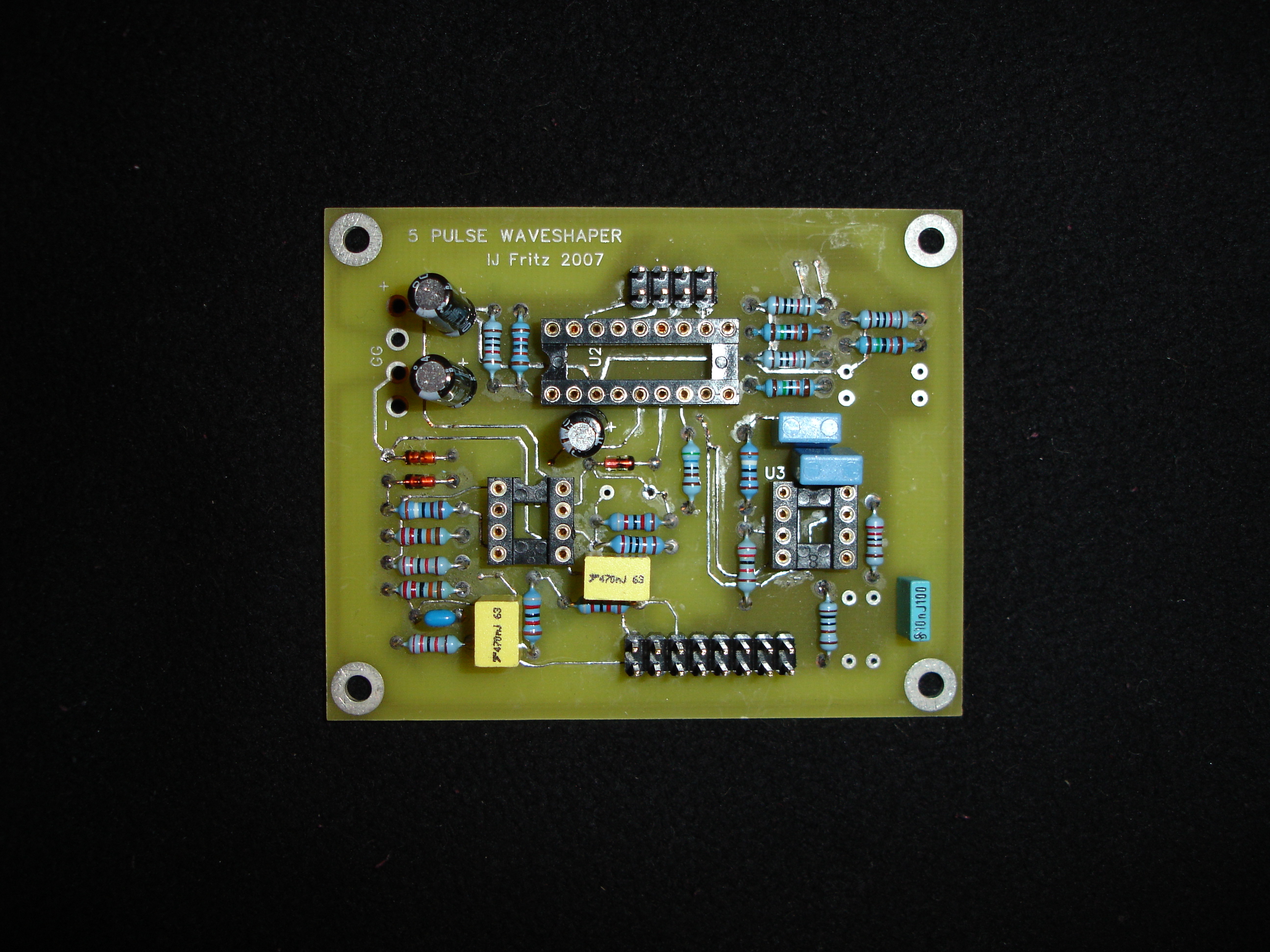

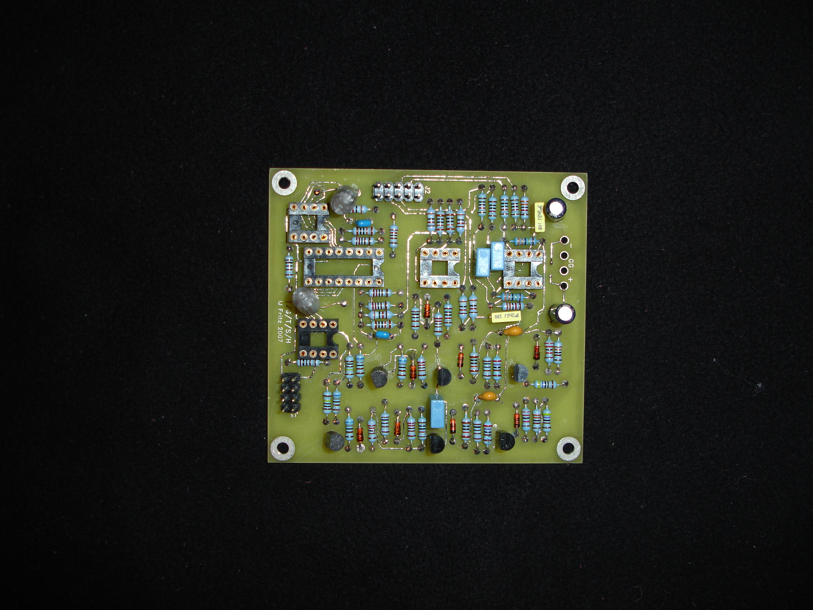

PostPosted: Wed Jan 16, 2008 10:12 am    Post subject: Reply with quote  Mark this post and the followings unread
Hi Ian,
I would like to thank you for the circuits. I am enclosing 4 pix of the stuffed boards. I am currently designing the front panel.
It will be a chaos pot-pourri module including the Jerkster, the EZ Chaos and the Threshold/Gate/Trigger/Sample/Hold circuits. To make the module a complete system on it's own, I will be adding 2 Buchla LoPass Gates derived and enhanced from Fonik's version, plus the Thomas Henry Super Controller and a pair of A/D A/R generators.
I have a question, on the Combination Threshold/Gate/Trigger/Sample/Hold Circuit web page you write,
"I have made a short sound clip of it operating on the output of a slightly modified version of the EZ Chaos system. (The modification is the addition of an extra cross-coupling within the circuit.) ".
Would it be possible to further expand on this modification, and if possible, could you please post a schematic, so I can breadboard it and try it out. I am finishing up the modules this evening in a prototype box, based on a Serge rox box I use to test circuits in the real world with my modular.
Here is a pic of the EZ Chaos Board, I used electrolytics instead of tantalums and polystyrenes instead of the Mica caps. Will the circuit function properly or should I change them?
Next is a pic of the Threshold/Gate/Trigger/Sample/Hold circuit, I noticed your board has the 4 bottom right transistors coloured red, are these matched and should I match mine? Should I use polyfilm caps like the 2 red ones or keep the yellow mono's I have?
I will post pix and mp3's once everything is completed and fully integrated, again many thanks .

PostPosted: Wed Jan 16, 2008 11:25 am    Post subject: Reply with quote  Mark this post and the followings unread
ringer wrote:
Hi Ian,
Ringer
Nice boards, are these the ones Ian was selling? Or did you make them yourself?

PostPosted: Wed Jan 16, 2008 11:35 am    Post subject: Reply with quote  Mark this post and the followings unread
Hi Ringer --
Thanks! You're going to have a nice toy there. Cool
It's further up in this thread -- just look for the scribbly drawing on May 7. You will need to cut one trace, as shown by the wiggly line, and tap into three points on the circuit for the signals, plus three for the power.
Those substitutions are fine.
The transistors can be any switching devices. No need to match. I have no idea why mine are colored -- they're some old surplus I picked up years ago. The yellow monos are fine.
Can't wait to hear some demos! Don't hesitate to ask if you have more questions.
