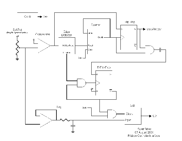

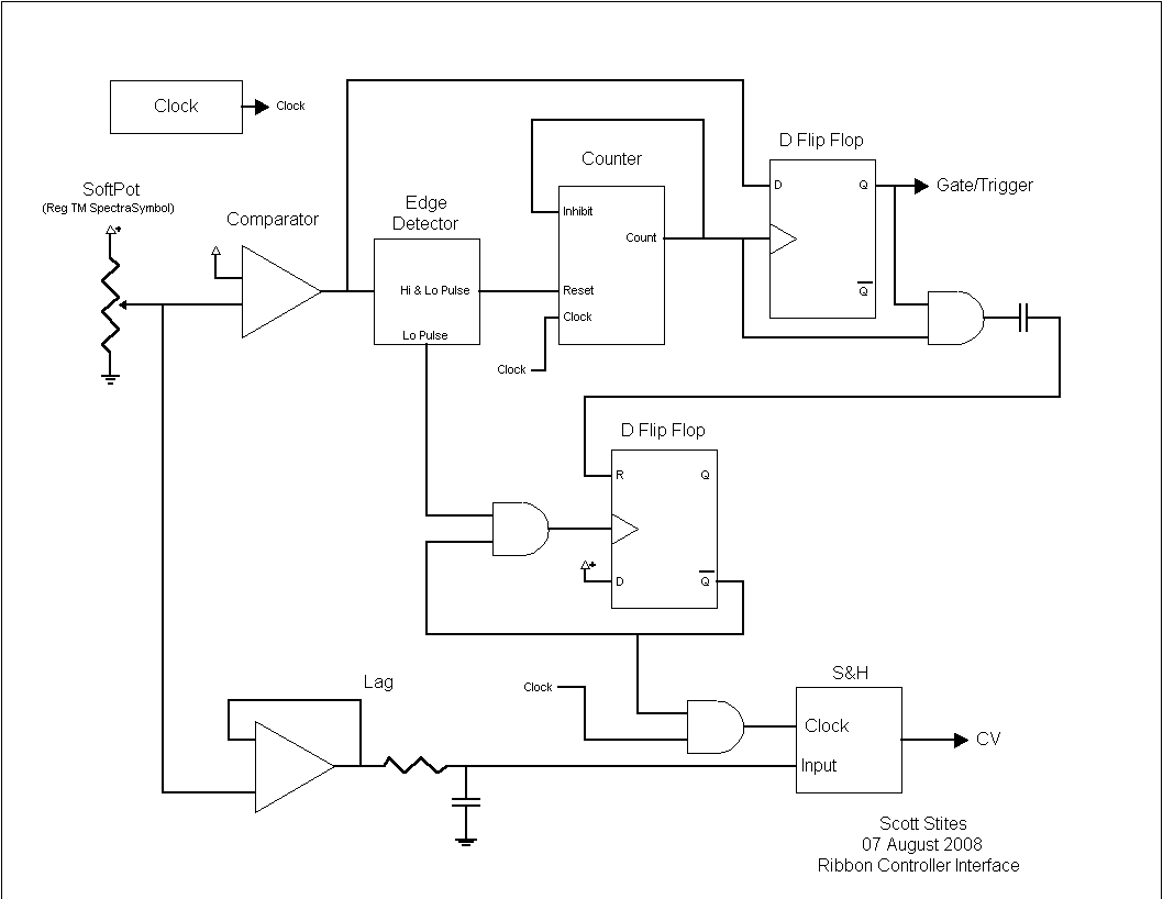

My initial Rube Goldberg......
Polarities would have to be sorted - this debounces gates and triggers without reliance on an RC time constant while keeping as a top priority detecting a low comparator state in order to hold the S&H clock ASAP and only once.
This thing makes the synth sound so good (and is so much fun) on the breadboard, I feel especially inspired. Very Happy
Edit - Whoops, had pulse detector out feeding the D input rather than comparator out.

Condition: Ribbon controller first pressed by human appendage.
1. Comparator goes high - it may bounce a little on the way up.
2. Edge detector produces a pulse from the rising edge of comparator out and resets the counter.
3. The counter will attempt to count up to its terminal count, and will be able to do so once the comparator output is stable and does not interrupt the count - this serves to debounce the comparator output.
4. Once the counter reaches terminal count, it inhibits any more counts so that it "rests" at terminal count. The transition to terminal count clocks the first flipflop (the one top right). Terminal count will go low when the next event causes a reset of the counter.
5. Because the comparator is high, the flip flop Q goes high when it is clocked.
6. The Q output of this flipflop will be used to generate a gate and trigger signal - Note On.
7. The gate is high, and the comparator is steady, so the Q output of the flip flop also generates a pulse which resets the second flip flop (lower middle).
8. /Q of the second flip flop goes high on reset, allowing the Sample and Hold to be constantly clocked, thus allowing the output of the S&H to follow the movement of the voltage supplied by the soft pot through the lag circuit.
Condition: Ribbon controller is released by human appendage.
1. Comparator goes low - it may bounce a little on the way down.
2. Edge detector produces a pulse from the falling edge of comparator out and resets the counter while at the same time clocking the /Q output of the second, lower middle flipflop low.
3. The low /Q of the second flipflop immediately causes the S&H to hold its last sampled value from the lagged SoftPot wiper voltage.
4. Just as importantly, the low /Q of the second flipflop prevents any comparator bounce from possibly causing the S&H to sample any other voltage
5. Meanwhile, the counter will attempt to count up to its terminal count, and will be able to do so once the comparator output is stable and does not interrupt the count - this serves to debounce the comparator output.
6. Once the counter reaches terminal count, it inhibits any more counts so that it "rests" at terminal count. The transition to terminal count clocks the first flipflop (the one top right). Terminal count will go low when the next event causes a reset of the counter.
7. Because the comparator is low, the flip flop Q goes low when it is clocked.
8. The Q output of this flipflop will be used to terminate the gate signal - Note Off.
9. The Q of the first flip flop is low, so the Q output of the flip flop does not generate a pulse to reset the second flip flop (lower middle). This prevents the S&H from starting to sample 0V.
Once the ribbon is pressed again, the Q of the first flipflop will go high and reset the second flip flop - until the comparator is high and stable, the second flip flop will not allow any bounce to inadvertently cause the S&H to sample the wrong voltage.
Needs refinement and math, and some of this may end up being unnecessary, but I like to load for bear and change ammo when all I find is bunny wabbits.

PostPosted: Fri Aug 08, 2008 6:52 am    Post subject: Reply with quote  Mark this post and the followings unread
OK, I took a look at the circuit and had drawn a timing diagram. Everything seems in order and I see just one critical item that will be of concern to you in the future. It's with ragard to the RESET suppression to the S/H clock enable flip flop (lower middle). When the counter TERMINAL COUNT goes high after timing out on the release of the softpot, there will be a propagation delay (Tp) of the comparator output through the TRIG/GATE FF which will cause the AND gate to output a pulse (Tp) wide. A glitch. This MAY cause another reset to the clock enable FF and re-enable the S/H clock a short time after release thus causing the CV to output a constant 0 volts. It seems like your breadboard is working and thats a good sign. Very Happy
Now, I do see in the diagram you have a cap on the output of the AND gate in series with the FF's RESET terminal which may indicate that you know about this potential hazard already and may make this observation moot. Very Happy
For sure ... Nice work. I realize the refinements you intend on making. (Clock rate, lag circuit, counter timing, etc ...)
Bill "Hope you don't mind" the comments" Manganaro .......

PostPosted: Sat Aug 09, 2008 2:08 am    Post subject: Reply with quote  Mark this post and the followings unread
Well, the Rube Goldberg diagram is out. It really was too much dynamite in the wrong places. Debouncing the trigger/gate/S&H comparator was a much simpler affair than all that rigamarole.
The problem is the bounce. I can't find a good balance between S&H clock and lag to make things either not crappy sounding when the appendage is lifted or predictable when the appendage is lifted, or both.
It needs to grab a sample that occurs before the comparator even thinks of going high and hang onto that when it does go high. I'm thinking of a three element shift register - two fairly simple S&H's feeding a low-lag S&H, all driven from a CD4015. The first two S&Hs would be long enough to bridge any point in the bounce (around a ms), and the third would simply hold what it inherited the last time a valid sample was taken. In the event the comparator goes high while the main S&H was taking a sample, things could wait until it was done - it would still be a valid sample that occurred a ms or so before the comparator went high.
I think this actually would be a less complicated affair than that suitable-for-framing Goldberg model, and wouldn't require a lag circuit.

State Machine wrote:
There could be so many ways to skin this cat Wink
Yes indeed! On my MIDI wind controller I do all the processing for timing in a PIC. For the ribbon controller you would probably just need the lag circuit and differentiator for interfacing.
http://home.comcast.net/~ijfritz/sos_cir5.htm

Dr. V: Laughing I caught that one, didn't need an emoticon. Sort of like a complete loop....
Ian: Thanks for those suggestions. Reason I'm using a clock is I'd never thought of the differentiator idea, though TH did mention something along the lines of Bernie's one bus keyboard. In the absence of this approach, the clock was a means to hopefully sample the voltage before it does funny things on its way to rendering a comparator pulse.
Bill: Yez got SoftPot? Do you by any chance have a 500 mm strip? I think the bounce properties will vary with length. Storage scope would be nice. Had one long while back, but it bought the farm.
Things are progressing nicely with my approach. I've started the ASR idea, using a 4017 as a three phase pulse generator. The clock itself, BTW, is gated by the comparator voltage (it shuts down when comparator is low). Anyway, I've got the CD4017 set up to provide the pulses with a CD40106 narrowing the pulses for the S&H elements. I put on the first S&H to test it and found that (with a third of the frequency I was last using this morning, 3:00 AM) the samples have settled down considerably already. It's already dang close to usable; there's still a bit of occasional ambiguity in the sample timing that the rest of the idea should clean up nicely.
I'm having a blast here.
