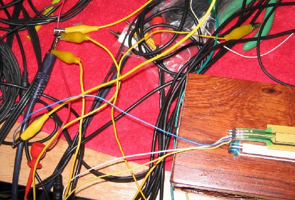

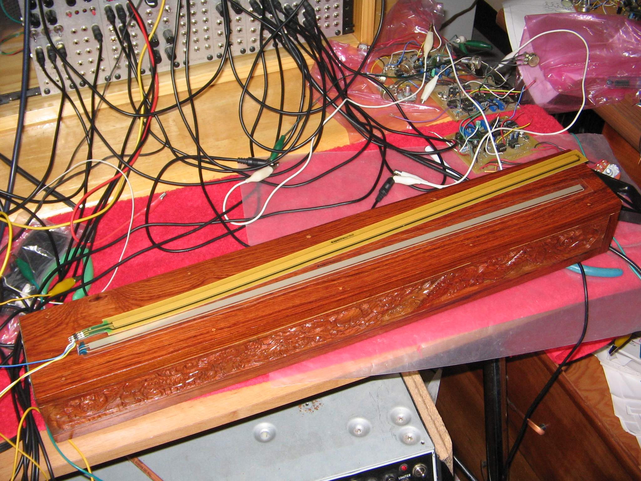

I gave the HotPot a trial run tonight. It certainly works with the Appendage, and the feel is definitely better - it doesn't grip the skin nearly as much. It does appear to take slightly more pressure; it's hard to tell with it not anchored and "floating" about. Even then, though, it didn't seem too awful bad. I'll know more when I grow some balls and decide to adhere it to a surface.
You can see my tenuous alligator-to-1/4 inch TRS connection; even with that crap connection, it worked just fine.

PostPosted: Wed Aug 26, 2009 11:21 am    Post subject: Reply with quote  Mark this post and the followings unread
Thanks for this information, Scott. I have to say, in your appendage videos I didn't see any evidence of struggling with grippiness so if the hotpot is even less so it seems like it must be pretty easy to manipulate.
If you do get around to sticking it to something it would be interesting to know the results of further evaluation.

The hotpot looks much better. As i live player my sweat gets into things before i even play anything and the hotpot looks much more robust. Very Happy Very Happy
Posts: 2810
PostPosted: Sat Aug 29, 2009 1:48 pm    Post subject: Reply with quote  Mark this post and the followings unread
It looks as though the laminate is different that encases the "pot" itself. Probably stiffer than the soft-pot and thus is why it takes a bit more pressure to activate the thing. I am just guessing at this point. Wink
Scott, does the Hot Pot feel thicker to you? It also looks wider so that more adhesive contact a surface.
It feels that way, but my doctor says just to get some frozen peas and....
Oh, you mean the ribbon!
It's a bit stiffer and thicker and feels "vinyley" if that means anything to you. Laughing
The assembly is actually the same width as the SP; same goes for the conductive strip (the playing area); I think the coloring makes it look wider in the pics.
