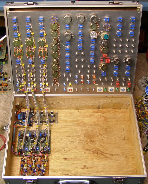

Joined: Nov 13, 2009
Posts: 114
Location: Sunny Alberta
PostPosted: Mon Nov 23, 2009 2:41 pm    Post subject: Reply with quote  Mark this post and the followings unread
I finished my Living VCOs yesterday, I had no problems calibrating the V/oct response. I did make some minor changes to the circuit.
I did not want to use the VCO driver section of the pcb on my project, so I carefully sheared it off from the three oscillators. It will need to have one trace repaired and then it will be used to add it's functions to a CV keyboard that my partner is building.
Instead of BC560C and 550C transistors I used some that are simply marked "BC560" and "BC550". I'm haven't compared specs, so I'm not sure what the actual difference is with these parts or what difference this might have made to the circuits.
I was unhappy with the upper frequency range that I could get even with the freq. trimpots all of the way up. I ended up changing the integrating capacitor from 2n7 to 1n0 and lowering R7, etc. to 250K.
I also adapted a saw to triangle waveshaping circuit from a MFOS VCO for each oscillator and added a version of Ian Fritz's sine shaper circuit (Thanks Ian!). This circuit takes it's input from the raw sawtooth output, directly connected to pin 7 of U1, etc. I built these on perf-board along with three of the output level boosters, like those on the VCO driver section, for the pulse wave outputs.
I'll attach the waveshaper schematic and some pics.
Take care,
Doug
