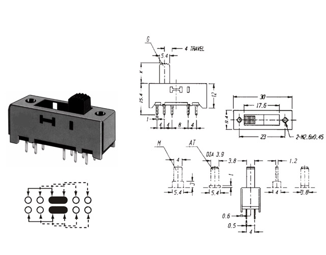

Hello
loopcycle wrote:
i read through the thread again. now why do people want to use the slide switches instead of rotaries? i cant figure it out. it seems like more of a hassle than anything?
Yes, they are a bit tricky, as to panel mount you
need square cut-outs.
The little slide switches look to be better to use to me, by which I mean I'll be wanting to tweak these in real time and the sliders work better for me for that than rotaries. They also have a slightly smaller panel footprint. As I'm going to be designing a scaeffer panel for these, the cutouts for them won't be a problem.

PostPosted: Mon Sep 08, 2008 8:30 am    Post subject: Reply with quote  Mark this post and the followings unread
ringer wrote:
Here is a preview of the front panel.
Hello Ringer
That is looking really nice, very cool.
Here are the switch dimensions diagrams.
I think the spacing for the switches is bigger than planned . . .
The height of the "knob ?" is as follows:-
8-way 8mm tall
4-way 7mm tall
I would recommend waiting until you get the switches
before etching !
-ryk
