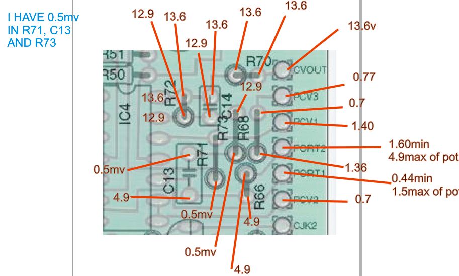

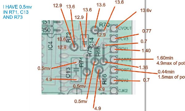

dancelwerk
Joined: Aug 28, 2009
Posts: 93
Location: berlin
PostPosted: Mon Jan 11, 2010 1:19 pm    Post subject: mp3 Reply with quote  Mark this post and the followings unread
this is a sample start opening the gate time control from min to max and after rising up the tempo and down and closing the gate time control,
stages count are 8
stage gate mode control position 1
portamento at 0
stages control mode forward
Range 5v
stepdiv at 1
i hope you help to listen it

dancelwerk
Posts: 93
Location: berlin
PostPosted: Tue Jan 12, 2010 11:21 am    Post subject: now i have normal sound Reply with quote  Mark this post and the followings unread
hi again, i made some progress
now i have long notes and the gate mode control works fine but i haven't Control CV pots, and i have 2.3 V in the cvout but always is the same voltage in the out, doesn't change.
this is other sample with the SH-2 opening gate of sequencer and closing again, there are the 2 vcos a little detuning, but how you can hear the same note always.
ufffff, is so frustrating.

ryktnk
Joined: Apr 24, 2008
Posts: 285
Location: london
PostPosted: Wed Jan 13, 2010 1:41 am    Post subject: Re: me again. Reply with quote  Mark this post and the followings unread
dancelwerk wrote:
in the step 1 pot is about of 5V, always is continuous on 5v even when the sequencer is stop.
when i turn dial always 5V
and CVOUT in the pcb and for extension in the Jack socket always gives 14.14 V
is it normal???
-ryk
[/quote]
Hello
Are you checking the wiper voltage ?
If it is always 5V then you have wire the Potentiometer wrong.
You should be able to turn the Potentiometer and get 0V on the wiper,
as one side of the Potentiometer is connected to ground.
Have a look at the wiring on the Potentiometer.
-ryk

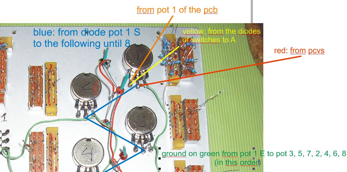

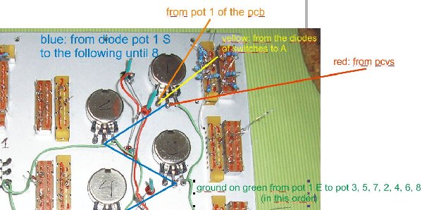

dancelwerk
Posts: 93
Location: berlin
PostPosted: Wed Jan 13, 2010 12:31 pm    Post subject: me again Reply with quote  Mark this post and the followings unread
me again, lately this topic is monologue by me, sorry for the problems, but understand me,i want to the sequencer working, sorry again, i made another photomontage like i wired the potenciometers, perhaps i have an error, look at and say to me.
I try to help you to find a solution, thanks in advance.
Fernando.

ryktnk
Posts: 285
Location: london
PostPosted: Thu Jan 14, 2010 5:00 am    Post subject: Re: wiper is ok Reply with quote  Mark this post and the followings unread
dancelwerk wrote:
hi
wiper is ok check 0 at min and 5 at max
now what should i check?
Hello
If the wiper voltage swings in the range then follow the next steps
I wrote before:-
Check the voltage on the PCVS rail whilst adjusting the
potentiometer of the Lit stage.
This should go from 0v to about 5v.
If not then make sure all the diodes on the potentiometer wiper
connections are the correct way around.
If this is ok, then check the voltage on PORT1 [the wire to goes to the
portamento potentiometer]
This should also go form 0v to 5v when adjusting the CV potentiometer
of the lit stage.
If this is ok, then check the voltage on the PCV2, this is the wire that
goes to the voltage range switch.
of the lit stage.
Make sure the voltage range switch is correctly wired to PCV1, PCV2 and PCV3.
If all this works then hopefully there should be a healthy CV from
the CVOUT connection.
Let me know how you get on.
-ryk

all is ok, working, giving me the correct voltages you said, but didn't work, and I did try another thing, i unwired the cvout from pcb of the cvout jack (always give me the same value 2.2v), I wired a cable from pcvs rail from diodes directly to the cvout jack, and voila!, now i have control of the cv stages pots, i think the problem is from CVout circuit of the pcb,
what components do I check??
what do you think?
what do you think?
Hello
Ok.
If you have got the 0v-5v range on PCV2, then mos of the
CV circuit is working.
You should then check a few components -
R68 - 66.6k
R71 - 100k
R73 - 100k
R72 - 5.26k
R70 - 560R
C14 - 220pF
This is the last stage part of the CV circuit
that scales the voltage with the range switch
for 0-3V and 0-5V.
It is based around 1C4D, so you should check carefully
the soldering of the pins of IC4, especially pins 12,13,14.
-ryk

hi rik, I take some values direct from pcb, with sequencer running, this is the values from my sequencer, what values should i have?, i check the components and are correct, should i unwire and change for some new?, or if you can see an problem, what component should i change first and what should it be the correct value?
Thanks in advance.
Fernando.
 Filesize:  77.81 KB
 Viewed:  199 Time(s)
ryktnk
Posts: 285
Location: london
PostPosted: Tue Jan 19, 2010 3:25 am    Post subject: Reply with quote  Mark this post and the followings unread
Hello
At what setting is the Stage CV pot when you took
these values, and was the Gate High [Bright LED] at the time ?
-ryk

i take this values with all stages cv at maximun in all gate high, stage at 8 steps switch at 3v
ryktnk
Posts: 285
Location: london
PostPosted: Wed Jan 20, 2010 3:20 am    Post subject: Re: hi again Reply with quote  Mark this post and the followings unread
Hello
Well you should have nearly 5V on PORT1.
I thought you had agreed to this before ?
You need to make sure you have a Gate High output
for the S+H part of the CV circuit.
Make sure you have 5V on Pin 2 of IC1 - this will confirm you have
Gate High signal.
If this is true, and your PCVS is about 5V then there is something
wrong with the S+H part of the CV circuit.
Check the following components carefully.
R59 - 10M
R66 - 1M
R43 - 100k
R49 - 47k
R36 - 10k
R37 - 22k
R44 - 22k
R50 - 100k
R51 - 22k
D5 - check polarity
Q15 - 2N3819
Q11 - BC547
Q10 - BC558
If PCVS is around 5V you should also have about 5V on Pin 1 of IC4.
-ryk
